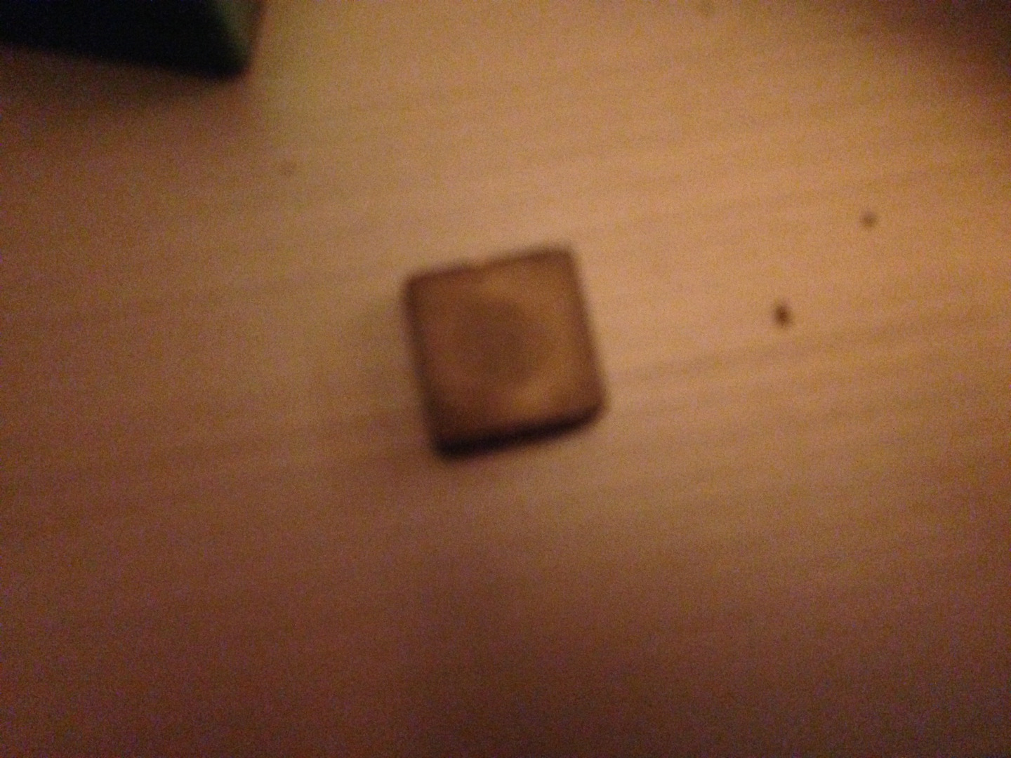

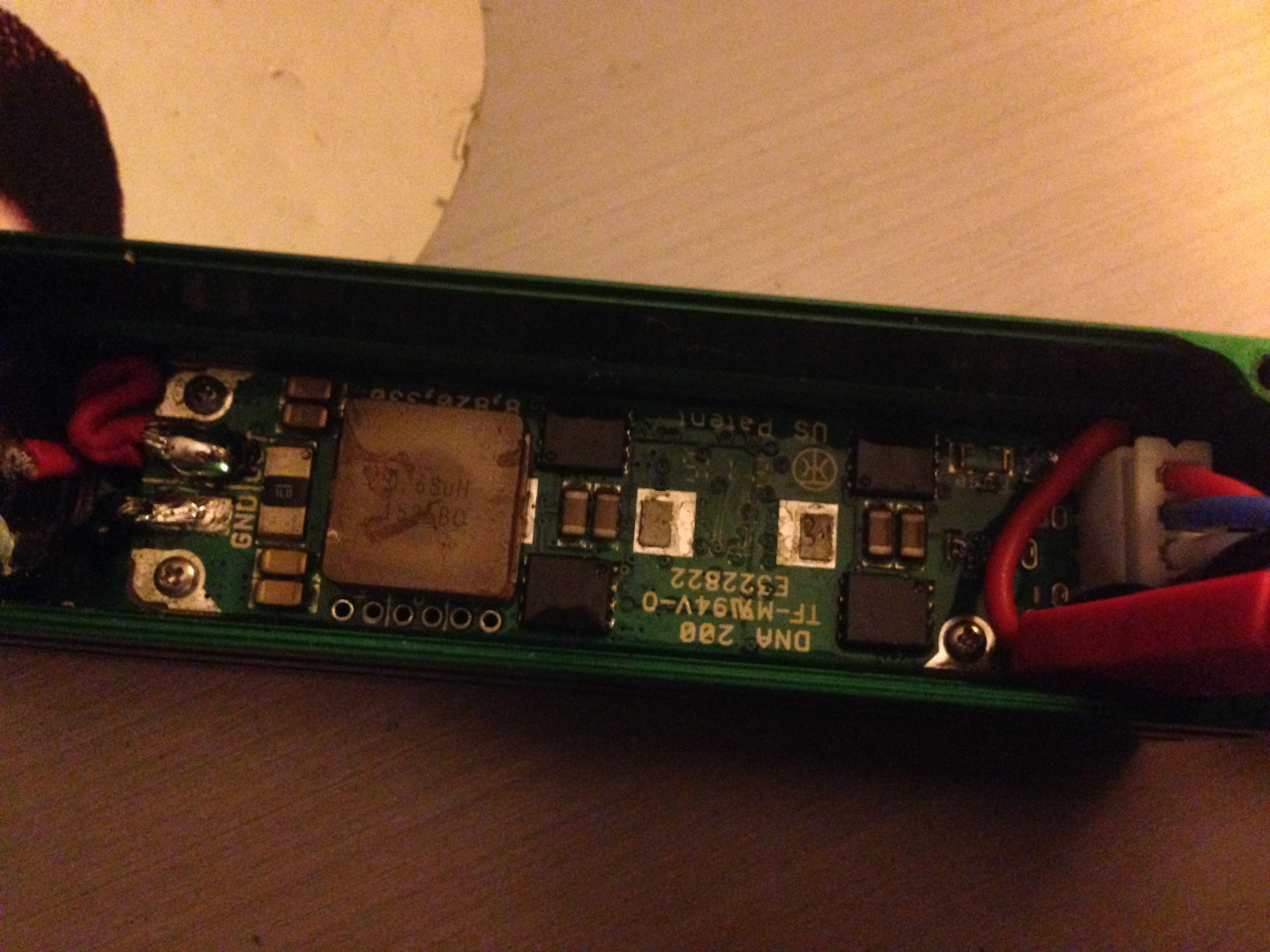

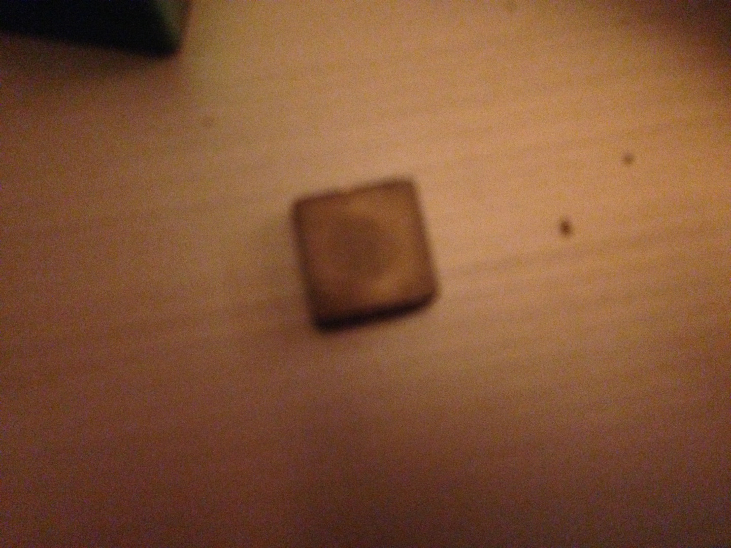

txmonkey214 Posted August 22, 2016 Author Report Posted August 22, 2016 Hi, I opened my Hana V200 to compare it to one I had just purchased. When I did, I found this came off the board (see pics). The mod seems to be working fine in temp mode. Is this just a heat sink? I thought it was an important component. Should I repair it? Superglue? Or, is there an electrical conducting adhesive I should use? Thanks in advance for any information you can give me.
dwcraig1 Posted August 22, 2016 Report Posted August 22, 2016 Best answer:https://helpdesk.evolvapor.com/index.php?a=add
black lace Posted August 22, 2016 Report Posted August 22, 2016 Sorry to undermine earlier advice but you may save time but also inform evolv,, as far as i remember Its called an inductor and it needs soldering at both sides at the tabs you can see, the mod will work but not fully, ,,, Am on mobile but if you do a search for inductor you may find moor info. Five minit job if you can solder or find someone who can.. like a computre shop, i would do it for ya for a bag of chips. did you buy it second hand?? Or had previouse work?? because it looks like its had earlier work done on it....

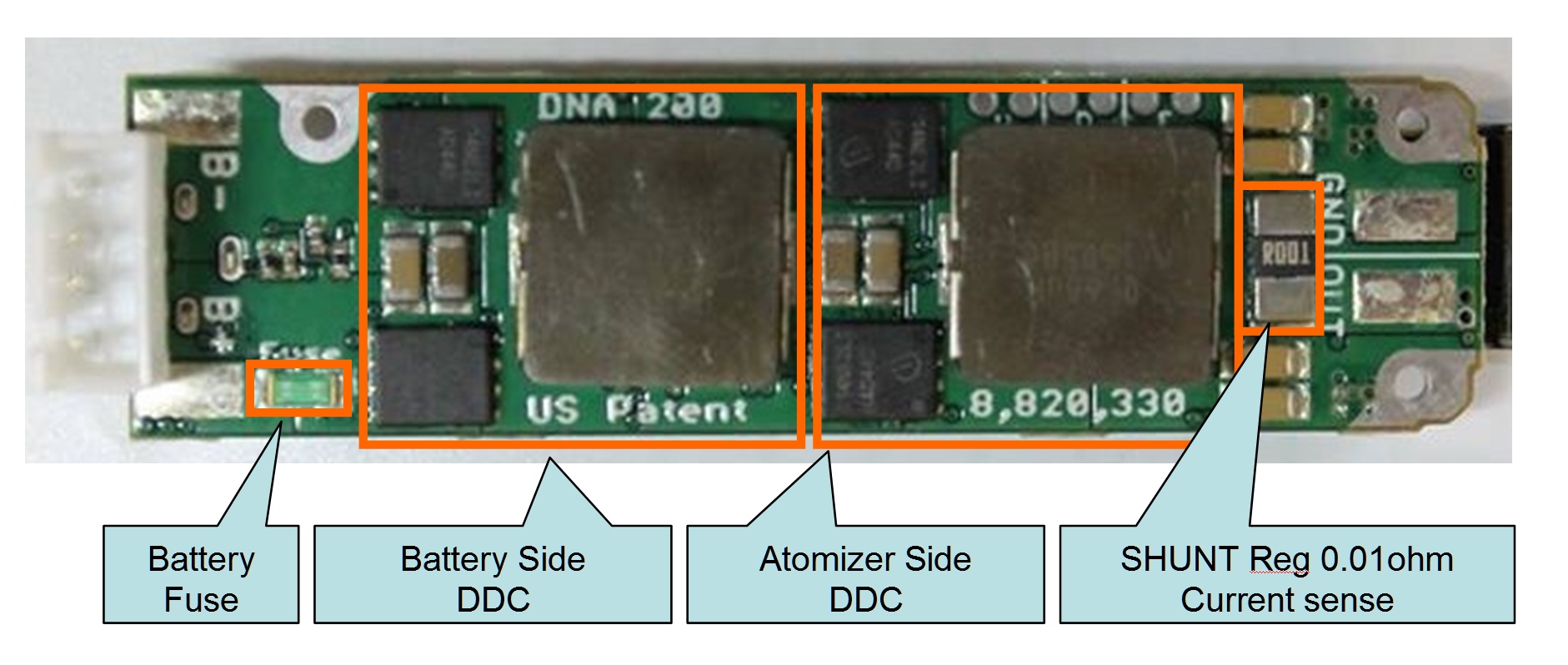

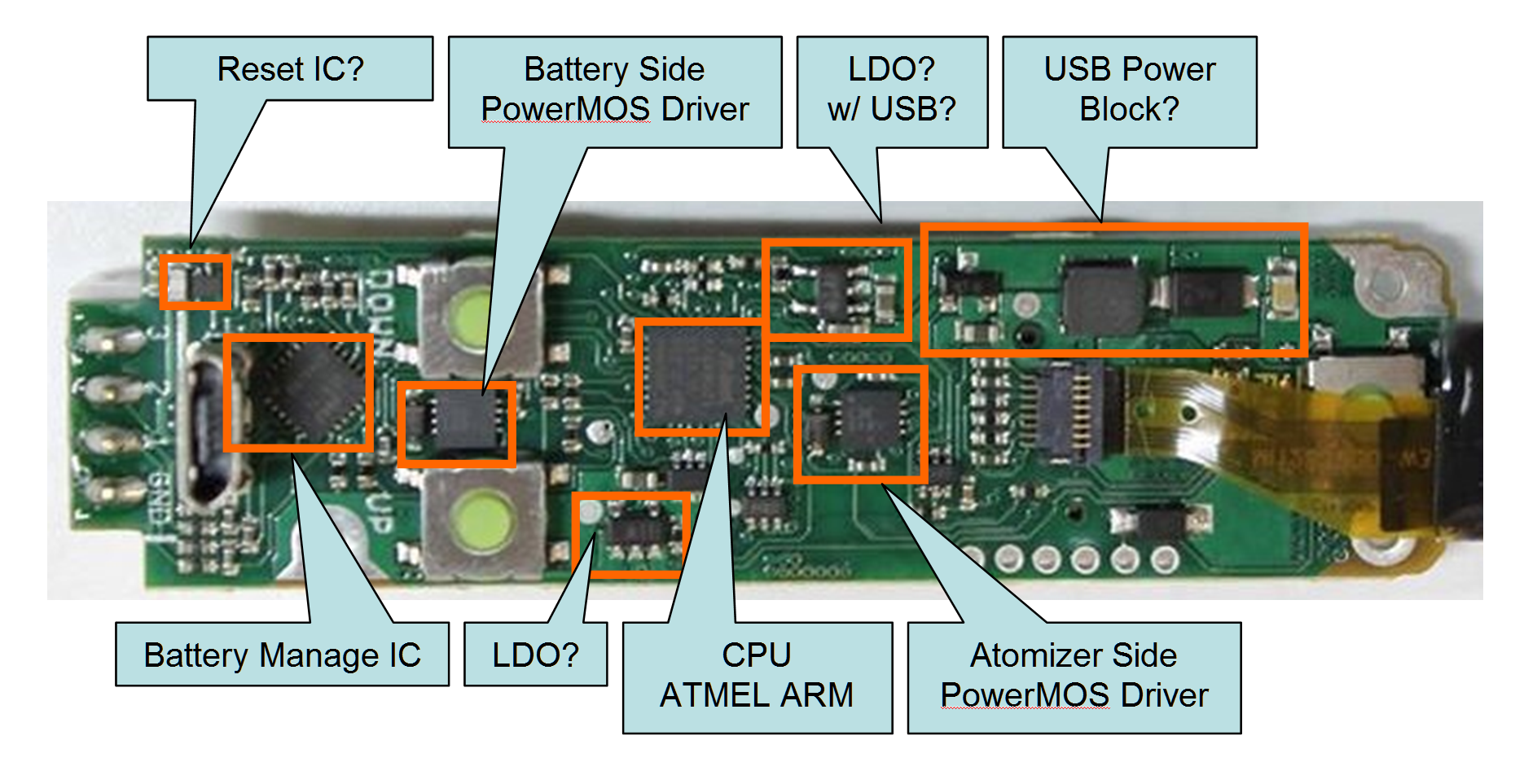

jurdanas Posted August 22, 2016 Report Posted August 22, 2016 Maybe helps: from here http://ecig.eucaly.net/archives/cat_68955.html
txmonkey214 Posted August 22, 2016 Author Report Posted August 22, 2016 Jurdanas, Thanks for the info. It looks like it's on the battery side. That is functioning normally, as far as I can tell. Hooking it up to escribe to see if it's running hotter than normal. It isn't. 91-98F. It can get up to 150F, and still be in normal range.I don't understand circuits that well, unless they're made of caps and resistors. My guitar amps are all pre-Space Age technology. I'm an Art Historian, so this is a little out of my field, but I love my hobbies. And, I come from a family of scientists, and engineers. So, I'm a little better rounded than most people in the Humanities. This appears to be a miniaturized induction coil. Not familiar with them, in this form. But, it should work the same as larger scale coils. black lace, it has been running like this for maybe 2 months. I tend to vape at relatively low wattage. never over 80 watts. There is a groove where the inductor came off, and slots formed from the solder, i gather, on the inductor. There is so little space in the Hana, so the battery barely fits, and touches the board. Not sure this is good for either of them.
Spector NS5 RD Posted August 22, 2016 Report Posted August 22, 2016 it'll run and charge normal since each buck circuit (2 mosfets & inductor x 2) run independent of each other then joined together at each of their outputs. the "usb power block" jurdanas has labeled is the 1 amp battery charger. think of it like two engines sharing the load. you just blew the head gasket on one engine, leaving you one engine still running......make sense? just open a help ticket with evolv if hana ignores you.as for the battery touching the board, the dna 200 is 97% (with non damaged board) efficient. buck converter circuits tend to be more efficient than boost dc-dc ones. so not much heat is generated when in use.
