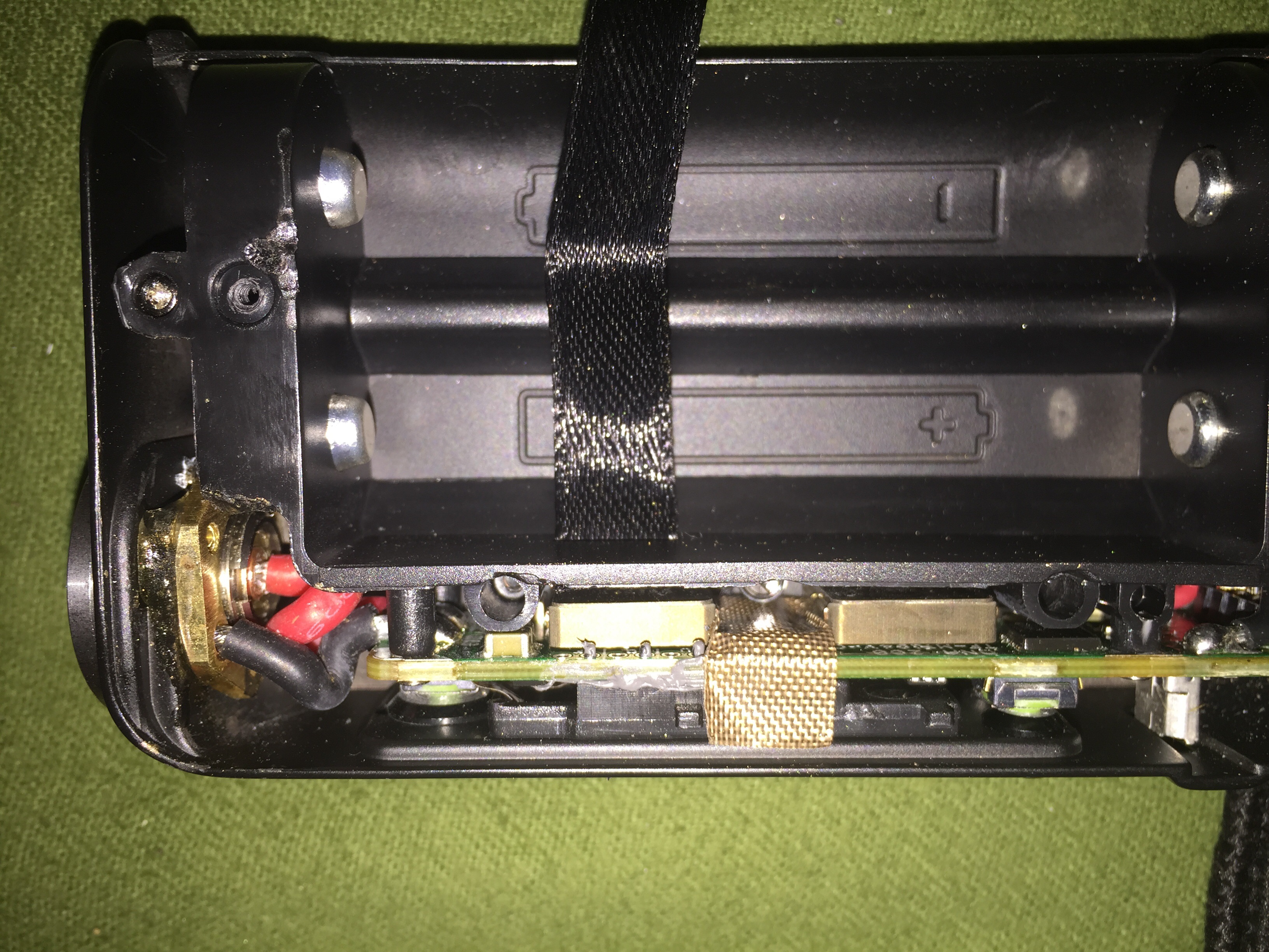

Well it bugged me that there are no pictures of the inside of a HCigar VT133. The screw heads look like hex heads and a 1.5mm hex fits loosely. And 2mm hex doesn't fit at all. But I got a Torx T7 to fit nice and tight to remove the screws. The two outer screws are really short and screws into plastic. The two screws closest to the DNA200 mod are really long and they do screw in the alloy case.
I was hoping it would be cleaner inside than it is. But it isn't really bad actually. That stuff on the plastic I think is super glue. On the right side you can see another board. I believe that is the reverse polarity battery protection. And the display ribbon isn't being flexed by the fire button.
FWIW, mine looks a little cleaner than yours, especially the stuff on the plastics. The geekvape t-tool large hex fit perfectly (whatever size that actually is).

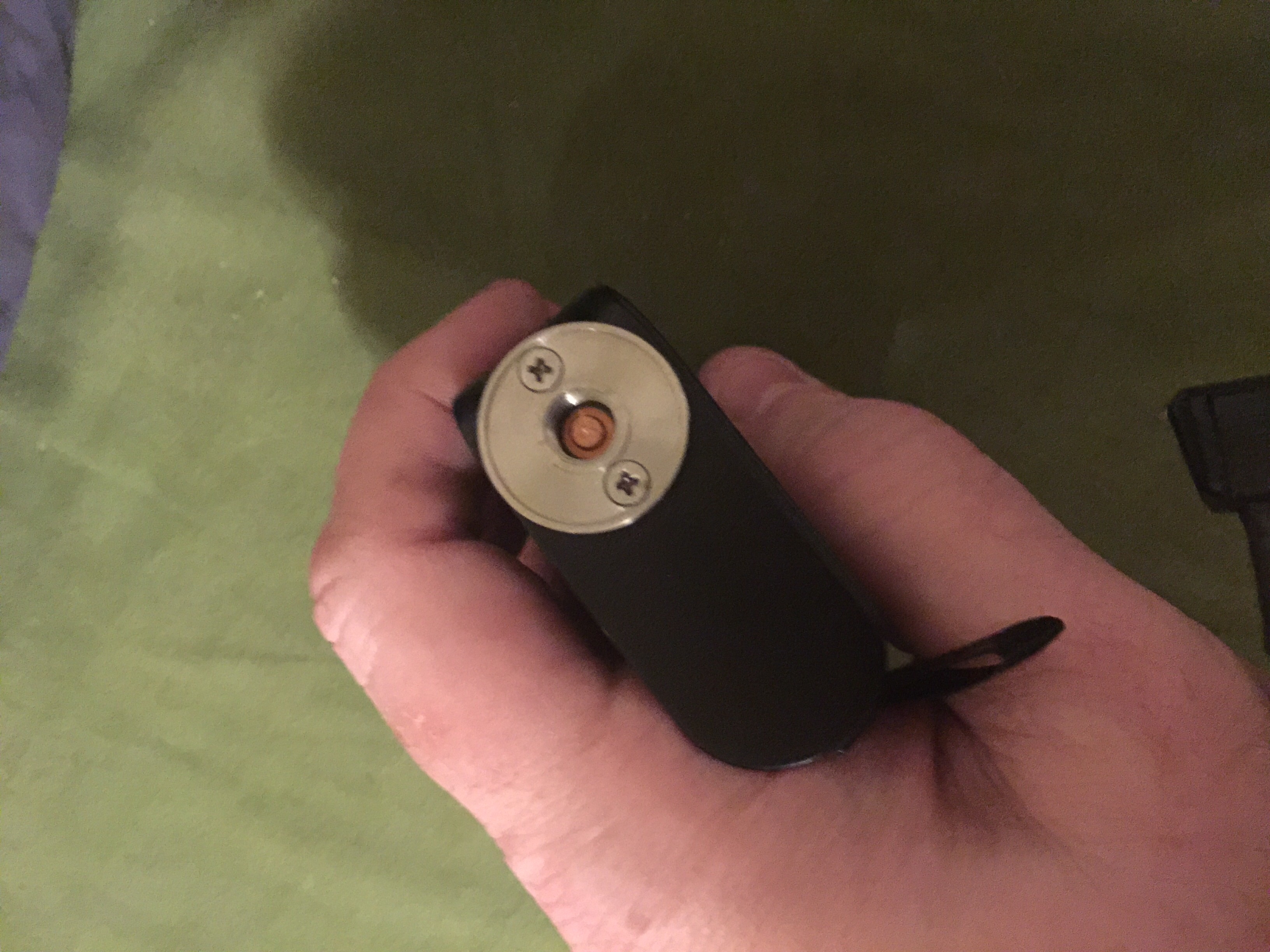

I'd love to swap their 510 with a Cisco 510, it looks like there's enough room to do so.  :D

I'm not fond of the 510 connector on the mod - really it's the only thing I don't like.

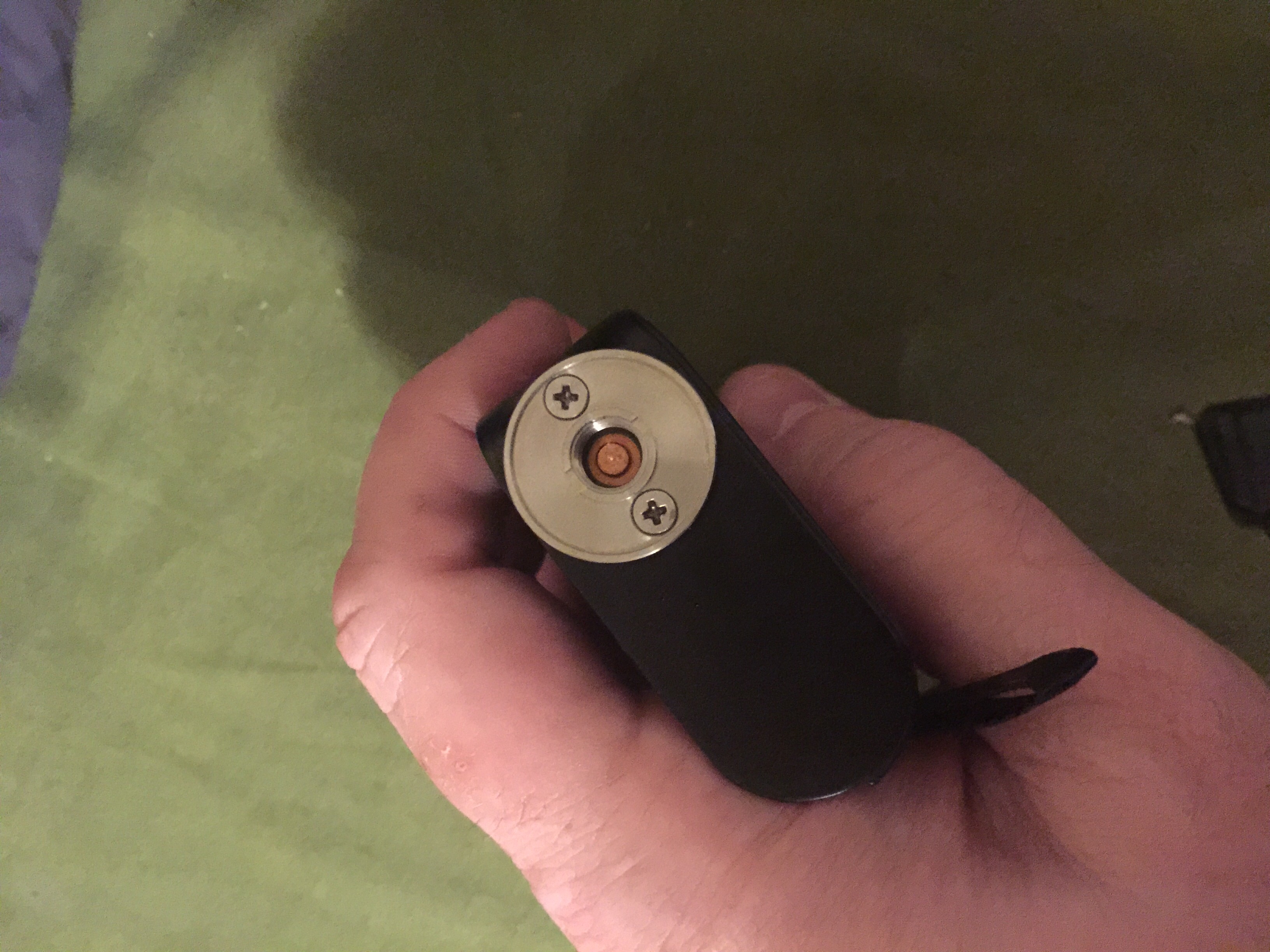

I can list all all the mistakes I made in the process to make you feel better. :) Th Cisco added height since it doesn't fit into the cutout they have for their 510. I'd guess it's 20mm not 22. My soldering iron touched a couple of places on the battery sled. I was lazy and didn't remove the sled first. I actually used some bondic on the capture ring to hold it in the correct orientation while screwing in the Cisco screws. Hcigar used a metric crap-ton of solder on the negative of the 510. My 70 watt iron on high had a hard time motivating that large of a blob to reflow. :/ Either way I still love this mod - the dual 18650s is plenty and I love being able to swap them out without carry around the wisBricks I own.
