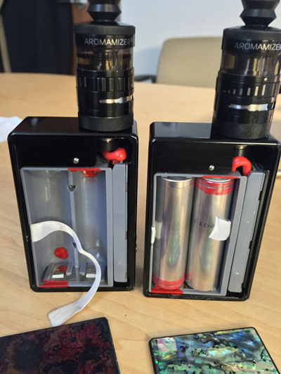

wiredl0ve Posted July 11, 2016 Report Posted July 11, 2016 BillW50 said:There are DNA200 mods out there with reverse battery protection. Well at least one model called a HCigar VT133. I liked the first one so much, I bought three more of them. I picked up a few more vt133's myself. Also, if I have a mod like the Efusion Duo w/out reverse battery protection, I like making a good visual indicator to help prevent battery insertion mistakes. I strip the shrink wrap and paint red rings on the batteries, then re-wrap in clear shrink wrap and then paint red indicators on the mod's battery tray -->

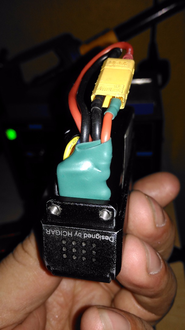

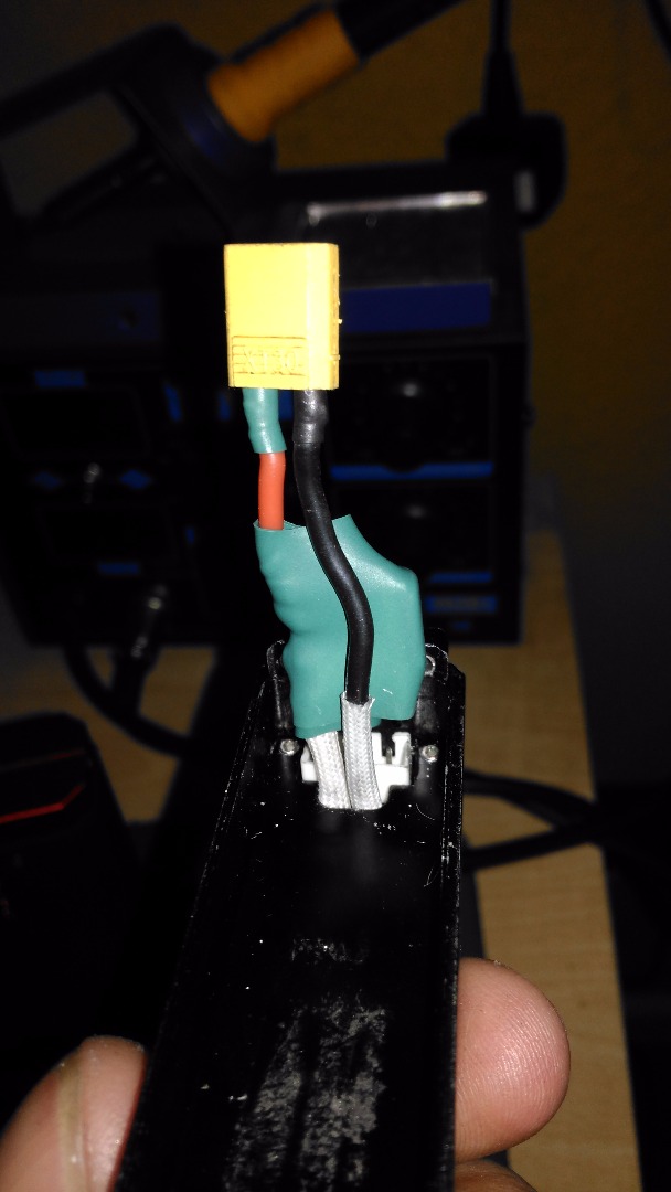

gsowt Posted August 26, 2016 Report Posted August 26, 2016 25 amp mini blade fitted with double lots of strong shrink tube over the whole thing, it just about fits inside the case
