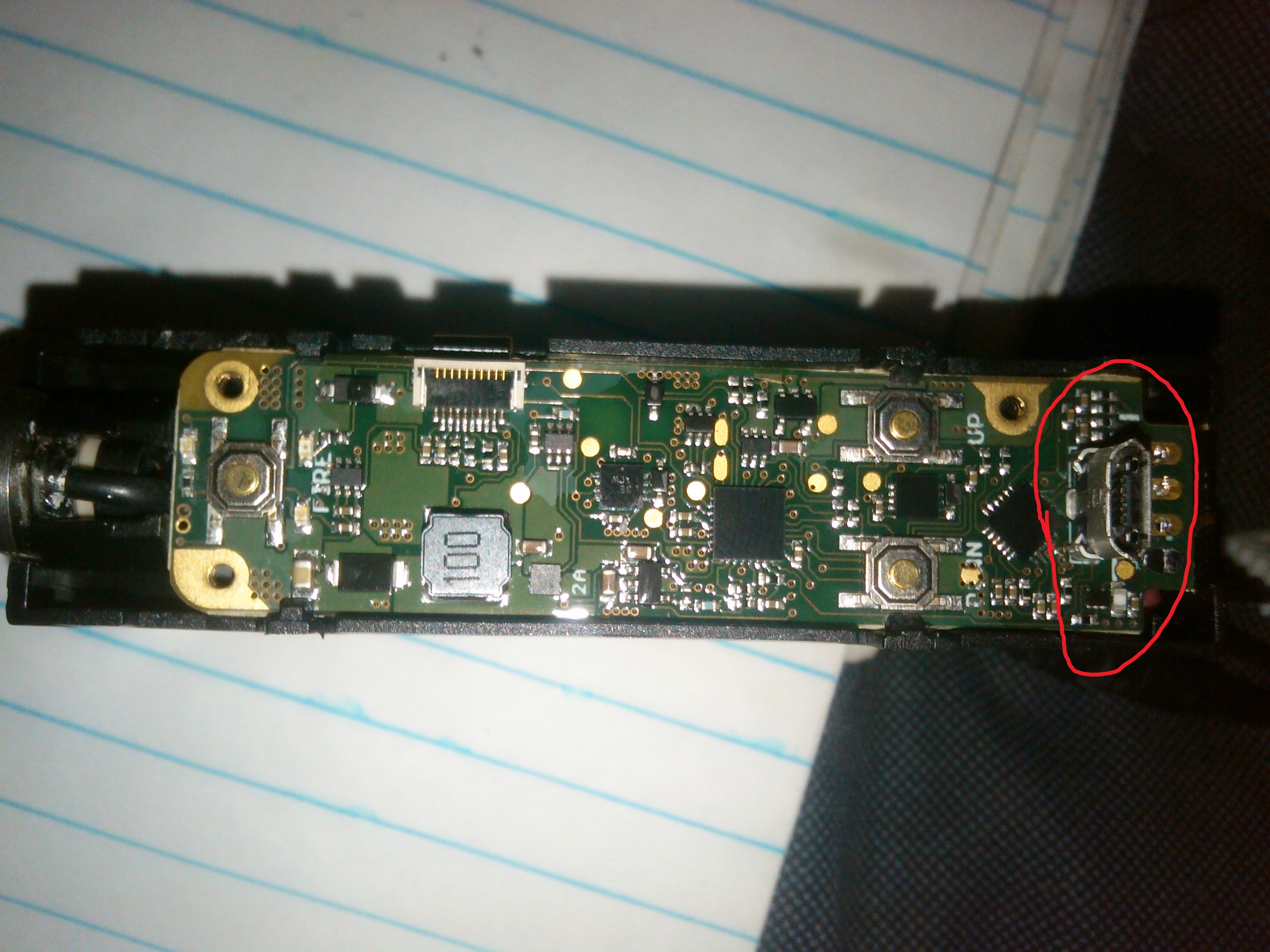

Spector NS5 RD Posted July 24, 2016 Report Posted July 24, 2016 jacky35 said:Yes it still vape. Doesn't show "battery unbalance"you could try and let the board balance the lipo. just leave it plugged into a usb charger. the dna 200 is fully capable of balancing a pack, it just takes a long time depending on how far apart, in voltage, any cells are. the more a cell is unbalanced the longer the process. FYI, the 200 balance discharges. if any cell becomes higher than the rest it is slowly discharged to bring it back into balance with the others. second option: if the device is still under warranty you could contact VS customer service. they also have a repair program available through their website for out of warranty devices at very reasonable cost, IMO.dwcraig1 has a good point if you have gotten juice inside the mod, specifically the usb area, that could interfere with charging. are circled in red where to look for ejuice on the shark board.

jacky35 Posted July 24, 2016 Author Report Posted July 24, 2016 I used tissues & cotton bud to clean the USB area. There are no juice around. My device now is discharge or stop charging. Battery drops to 34%.

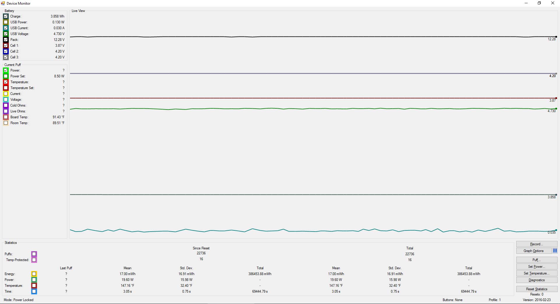

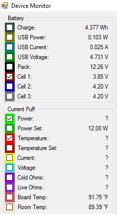

Spector NS5 RD Posted July 24, 2016 Report Posted July 24, 2016 jacky35 said:I used tissues & cotton bud to clean the USB area. There are no juice around. My device now is discharge or stop charging. Battery drops to 34%.how about another screen shot of device monitor with all the battery cells checked, pack voltage, and usb current checked.
jacky35 Posted July 24, 2016 Author Report Posted July 24, 2016 ChunkyButt200 said:how about another screen shot of device monitor with all the battery cells checked, pack voltage, and usb current checked.Hello, i did a restore default where it resets my board. it started to charging fast until 42% then stop there. It drop again now 38%, & charging current icon stop showing. The usb current is just showing 0.0030A and sometimes 0.000A.
Spector NS5 RD Posted July 24, 2016 Report Posted July 24, 2016 how long did you leave it charge for? how old is this battery? the balance process is extremely slow with the dna 200 when a cell is unbalanced like yours. if it was my mod, i would leave it on usb charge for a few hours keeping an eye on cell one's voltage. if after a few hours it never increases or stays at 3.87v i would contact VS's customer service. very helpful people. they always treated me great. (cell one did go up .02v so maybe there is a slight chance of it catching up with the other two cells with more time on a usb charger.)edit.....swabbing just the outside of the mod won't remove any eliquid that is inside of the mod on the board. you would have to take the device apart and use iso alcohol. however, you could void your warranty if you don't know what you're doing or possibly ruin your board.

VapingBad Posted July 24, 2016 Report Posted July 24, 2016 The charge rate would drop to very low when one or more cell is at 4.2 V. Have you checked the voltages of the cells with a multi metre to check the board is reading it correctly, if it is and it probably is I think you need a replacement battery. You could try charging the low cell on an external charger and see if it stays in balance, ChunkyButt200 has a picture of how to do that here https://forum.evolvapor.com/topic/66882-topic/?do=findComment&comment=901766
dwcraig1 Posted July 24, 2016 Report Posted July 24, 2016 If you get the cells balanced and put it into EScribe's device monitor and if the one cell is bad I think you will be able to see that as I suspect it will have extra sag compared to the other two cells.

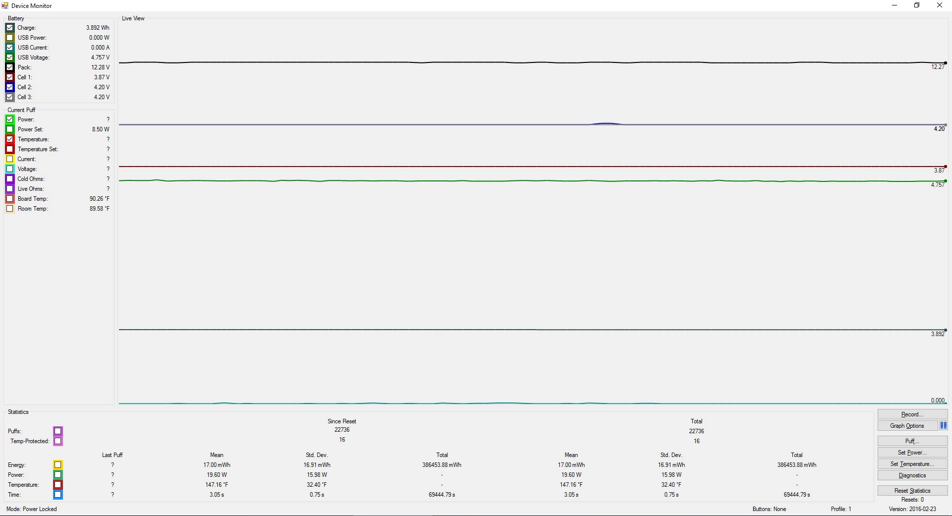

jacky35 Posted September 13, 2016 Author Report Posted September 13, 2016 Hi @ChunkyButt200, you can refer to the screenshot below @As u can see the battery cell is balance now. Compared to last time, it was totally screw up on the cell 1 Before all this i also did a USB Recovery Charging as well.
