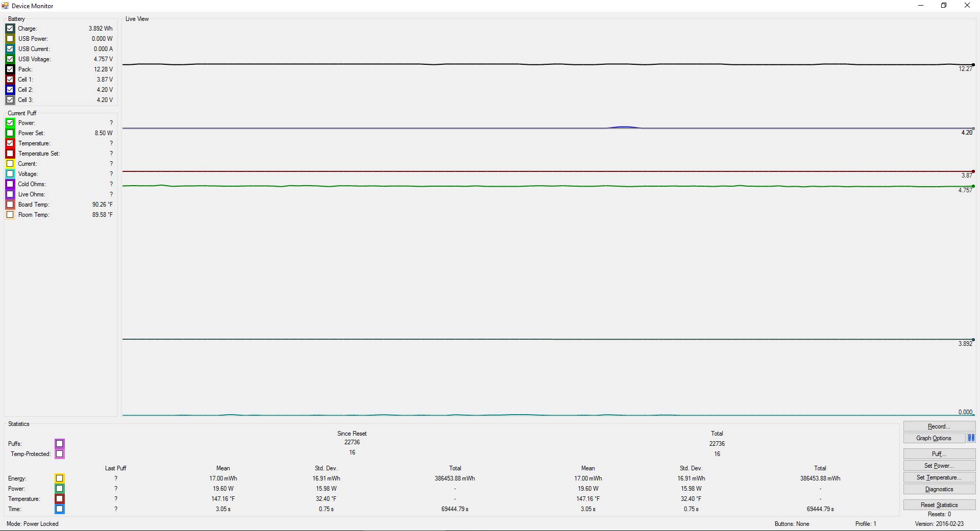

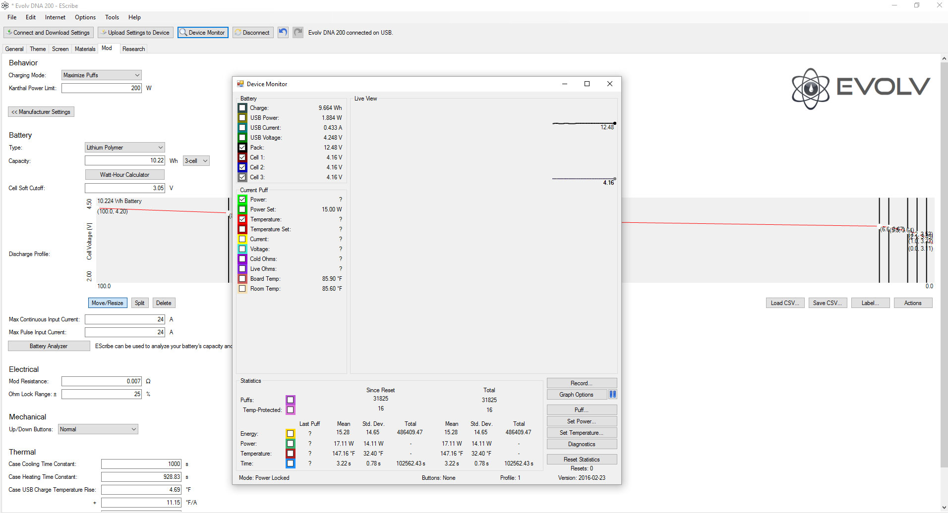

  1. Hi @ChunkyButt200, you can refer to the screenshot below @ As u can see the battery cell is balance now. Compared to last time, it was totally screw up on the cell 1 Before all this i also did a USB Recovery Charging as well.

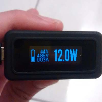

  6. I used tissues & cotton bud to clean the USB area. There are no juice around. My device now is discharge or stop charging. Battery drops to 34%.

  9. Hi Guys, My Vaporshark battery problem. 1. Here is what happen at first. I was charging it from 11%. After 1 hour it become 32% and it stop there. 2. Then i try to reboot it from my PC/ Turning all brightness down. After the tweak, the battery % suddenly change from 32% to 55%. 3. And then i charge it normally. now is draining from 55% to 43%. (Charging drops from 55%) (Charging drops to 44%) I really don't know what is going on. Can it be the battery problem?
