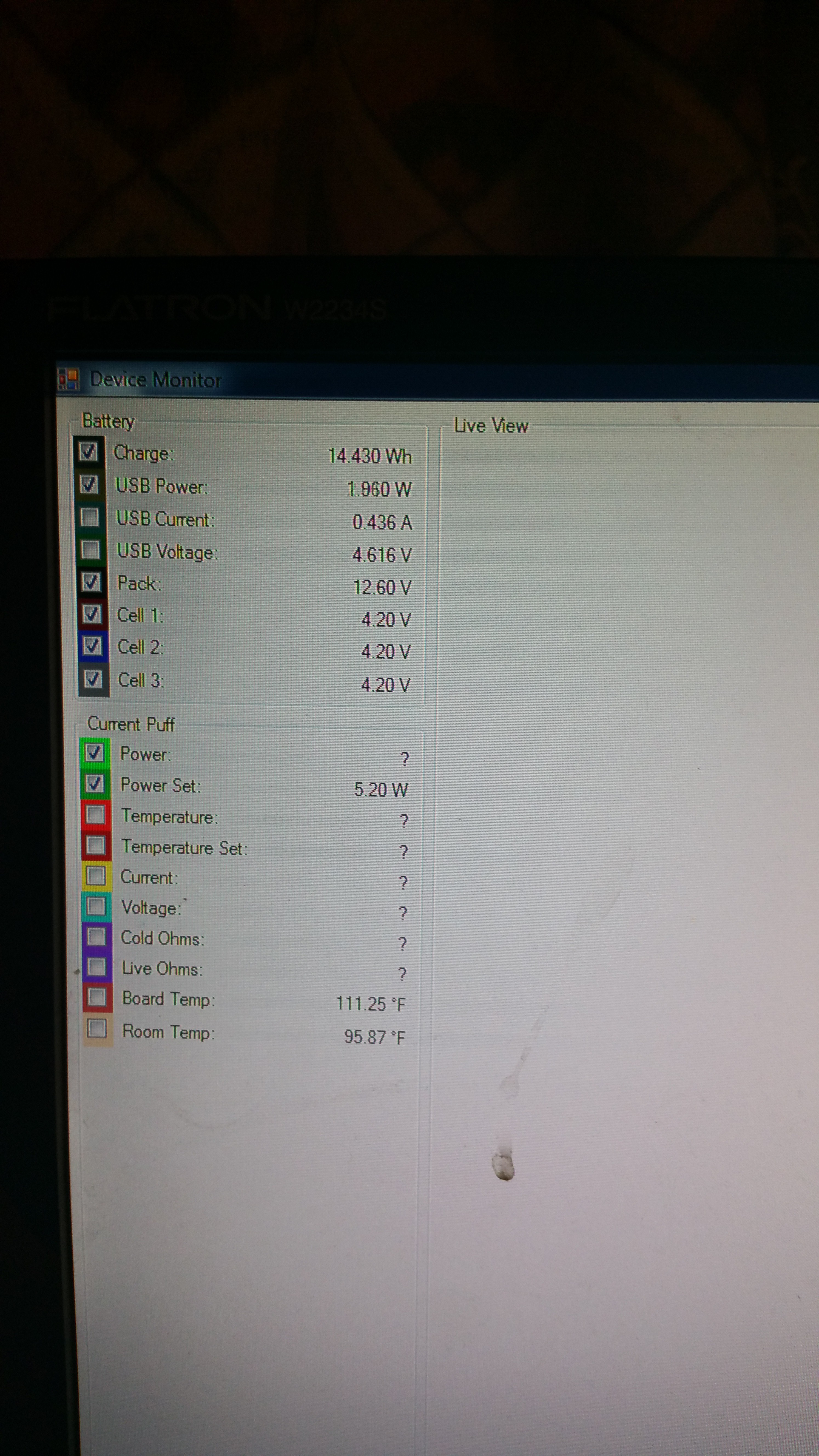

Toysoldiers Posted September 30, 2015 Author Report Posted September 30, 2015 I purchased a vt200 and i have been having problems with my battery. I only use it at 20watts and at 0.8ohms. I don't get even more than 4hrs of using it. I'm using my Istick 50w and it lasts me for 2 days. Is it possible I get a new battery sent to me? I can't even take it out with me to use because it does not last long enough. I paid £120 just so I can use it for a few hours at home. Please advise me in further what to? I have updated the software and changed the battery part from 9 to 14.43. It has improved but it still seems to be draining pretty fast compared to my other mods. There are not much to set for the battery as I have done some research online. I would like to be able to take my vt200 out with me and vape. Is there a warranty exchange? I have read others has last longer than a day using higher watts and temp control. My cells fully charged are Cell 1 4.20 Cell 2 4.20 Cell 3 4.20 Pack 12.60. Can barely get through have day now still using 20w @ 0.8. If I was to use it at 50w it would die in a couple of hours. Can someone please help me.

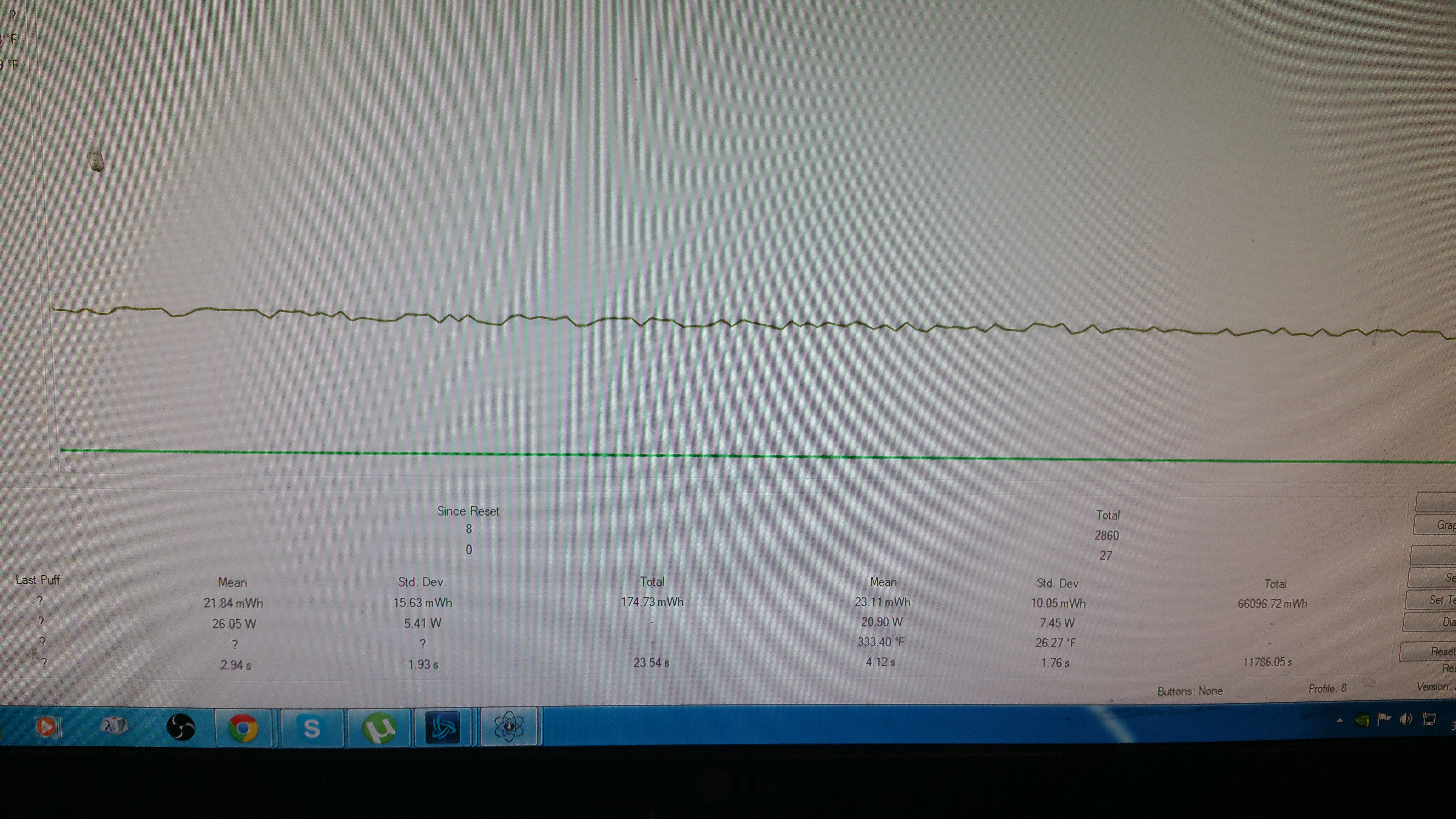

soblue Posted September 30, 2015 Report Posted September 30, 2015 Hopefully I'm understanding statistics correctly, if not someone can correct me. But it's kind of hard to compare battery capacity to someone saying I get a day out of mine when they may take 4 second draws every 15 minutes or so and you may take 10 sec draws every 5 minutes. If it were mine I would put a full charge on it, and either Reset Statistics in Device Monitor or write down the Total Energy mWh then use the device without charging it any further until I received the Weak Battery notification (making sure Cell Soft Cutoff is set correctly). If at that point your Total Energy is around 14Wh then it's performing pretty close to specs. If it's a little lower it may just be over stated battery specs. If it's significantly lower it may indicate a bad battery pack or something within the device.
Mad Scientist Posted September 30, 2015 Report Posted September 30, 2015 soblue said:Hopefully I'm understanding statistics correctly, if not someone can correct me. But it's kind of hard to compare battery capacity to someone saying I get a day out of mine when they may take 4 second draws every 15 minutes or so and you may take 10 sec draws every 5 minutes. If it were mine I would put a full charge on it, and either Reset Statistics in Device Monitor or write down the Total Energy mWh then use the device without charging it any further until I received the Weak Battery notification (making sure Cell Soft Cutoff is set correctly). If at that point your Total Energy is around 14Wh then it's performing pretty close to specs. If it's a little lower it may just be over stated battery specs. If it's significantly lower it may indicate a bad battery pack or something within the device. You are right of course. But I vape pretty much all day, about 20+ml per day at 100 watts preheat, 75 watts setting and around 45 watts at the "ebb" of each draw -- so that's my point of reference and comparison. At 20 watts to get only 4 hrs use from 14+ Wh, that would be some pretty heavy duty vaping. But again you are right -- the guy might just chain vape like a boss then wonder why the battery gets drained lol.
VapingBad Posted September 30, 2015 Report Posted September 30, 2015 Yep and I would expect all batteries too be slightly under their rating as the cut off on the DNA will be a higher than their capacity test. You can just not the total between charges rather than resetting if you prefer.BTW at 40 W 380-400 F a 900 mAh lasts me more than a day vaping 10 ml of liquid.

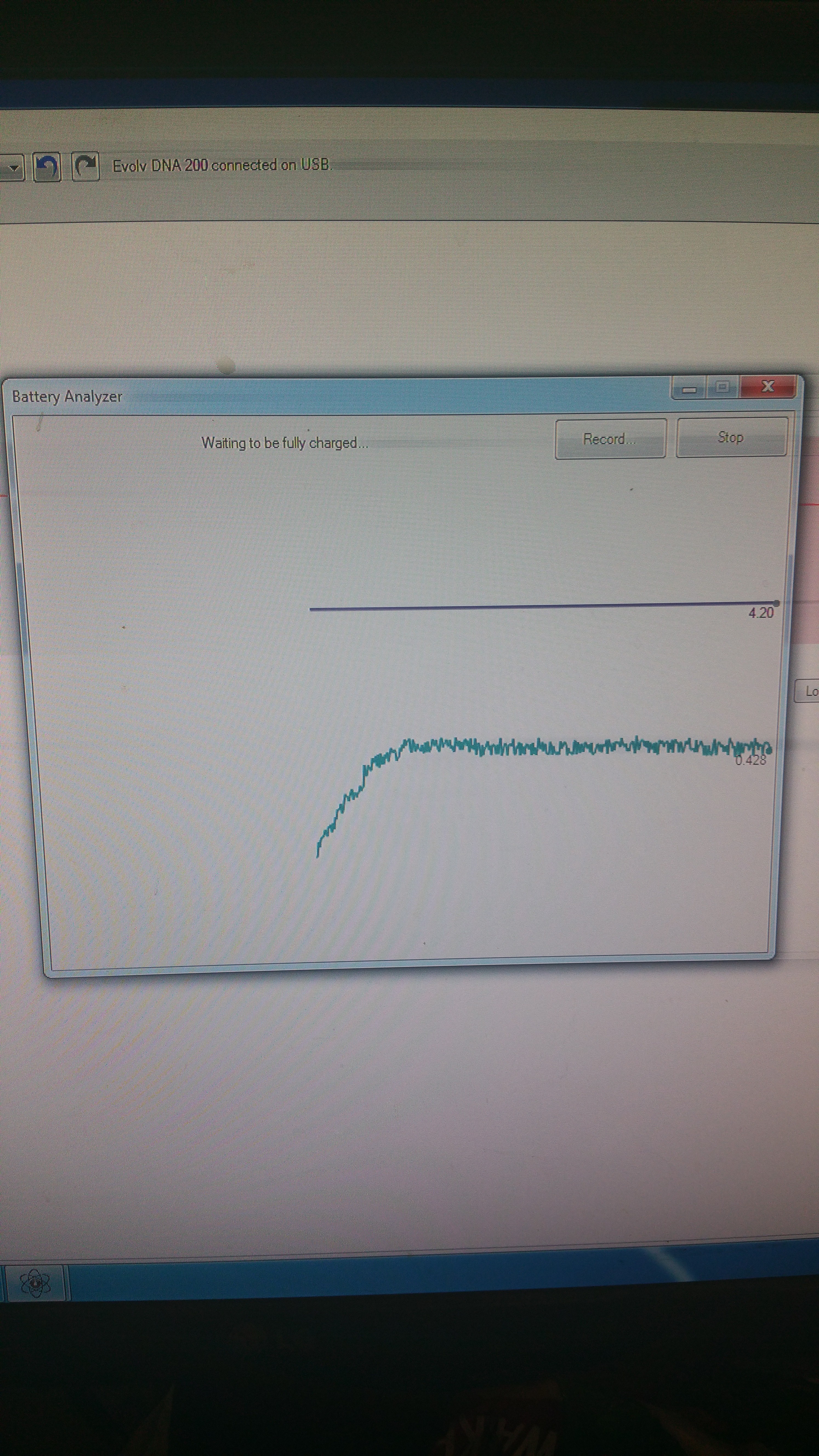

Toysoldiers Posted September 30, 2015 Author Report Posted September 30, 2015 hey guys, i contacted the my vendor angelsfiremods.co.uk, great customers service! gave me another software to update and will see what happens next. my next problem is that i have been charging it for 5 hours and not using it. but the charging indicator is still there, so i cant do the battery analyzer. It looks like its fully charged though. so i still need to test it after it fully charges and then give them a call back and let them know how it is all going. before that i need it to fully charge first @@
VapingBad Posted September 30, 2015 Report Posted September 30, 2015 Looks fully charges with each cell at 4.2 V, it would have charged faster from a 1A supply btw and if you press fire during charging it pauses charging and shows the standard screen.
Toysoldiers Posted September 30, 2015 Author Report Posted September 30, 2015 i am now trying for the battery analyzer but it says "waiting for battery to be fully charged..."
VapingBad Posted September 30, 2015 Report Posted September 30, 2015 Have you got a resistor on top, not a normal coil, see https://forum.evolvapor.com/topic/67481-topic/
Toysoldiers Posted September 30, 2015 Author Report Posted September 30, 2015 26g kanthal dual coil 8 wraps 2mmok its working now using 1 ohmsbig thanks everyone
VapingBad Posted September 30, 2015 Report Posted September 30, 2015 If it thinks that it is not full after it should be you could try and reduce the Wh a little on the mod tab.
Toysoldiers Posted September 30, 2015 Author Report Posted September 30, 2015 blah its doing the same thing... needs to be fully charged! GRRrrrr
Xx3dge Posted September 30, 2015 Report Posted September 30, 2015 It's better to use a resistor. The Atty is going to get extremely hot.
