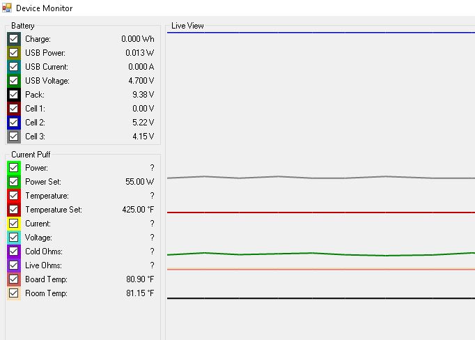

vccy118 Posted March 2, 2016 Report Posted March 2, 2016 I am having the same problem. This started yesterday after I try to plug in the USB to charge and realized I can't charge it or even vape on it! So I externally charged all 3 batteries to full and this is what I got from escribe. BTW I use 3 Samsung HE4.This is the reading I get when I removed all batteries. Cell 3 still reads 3.04V even without any batteries inserted.I tried rotating the batteries, I even bought 3 LG HG2 (Brown) batteries and still the same result! I tried tightening the ground screw (gold plated), made sure all batteries are fully making contact, hard reboot, soft reboot... all to no avail.Anyone have any idea how to fix this?

vccy118 Posted March 6, 2016 Report Posted March 6, 2016 I now tried something new with my reuleaux. I did a hard reset with batteries in, same result, then I unplug USB, fire once, then remove battery, then plug in USB, same I get cell 1 and cell 2 0.00V, cell 3 4.14v. Then after I hard reboot it, I get this new reading, with no batteries in it. This means anything?
alex218b Posted October 17, 2016 Report Posted October 17, 2016 Hey just wanted to chime in.I had the exact same issue with my SMY DNA200, it would only turn on when the fire button was press, and would show an empty battery symbol and the check atomizer message Cell 1 and 3 read as over 5 volts and cell 2 read about 1.5 volts.First i tried to do a recovery charge in the escribe software, but it didn't solve the problem sadly.Then i choose to open up the device itself, to examine the battery it myself.I measured each of the cells with my multi meter, and sure enough cell 2 was under voltaged, to be fair it was more or less dead with a voltage around 0.25 volts, but cell 1 and 3 were fine, at around 4 volts. So i ordered a new battery for my device, and installed it with some slight problems, but got it installed in the end.But the problem was still present after the new battery was installed, with some improvement tough, escribe was now showing cell 1 and 3 as 4.7 ish volts and cell 1 as a little over 2 volts.At this point i had sorta given up, and left the SMY with the new battery on my desk for couple of days.Irritated with the mod not working properly i took a second look at it, and saw that the voltage on the brand new battery had discharged a lot down to around 11.6 volts, so i got out the multi meter ones again, and saw that the voltage on cell 1 and 3 was 4.20-19 volts as it should be, but the voltage on cell 2 had dropped down to around 3.4 volts.From this i could conclude that there was a short circuit some where in the mod discharging cell 2. I read around some more on different forums, and some people were talking about having luck with desoldering the usb connector from the board, then cleaning it thoroughly with rubbing alcohol, and then soldering it back on again, so i tried that.During the cleaning a lot of black gunk came out of the connector, old e liquid mixed with dust maybe?Anyways, after cleaning it out, i re-soldered it back on the board, crossed my fingers and hoped for the best.Luckily it worked sorta, the board stayed on, but the cell still showed the same voltage as before.So after a night of charging, the cells were now evened out, and they all read around the 4.20-19 ish voltage, and my mod is working again.Im also happy with the new battery, as the new battery has around 15 Watt hours in it, compared to the 9 ish Watt hours of the old battery.I hope this post can maybe help other people with the same problem in the future, also sorry for any grammatical or spelling error's, English is not my mother tongue RegardsAlex
