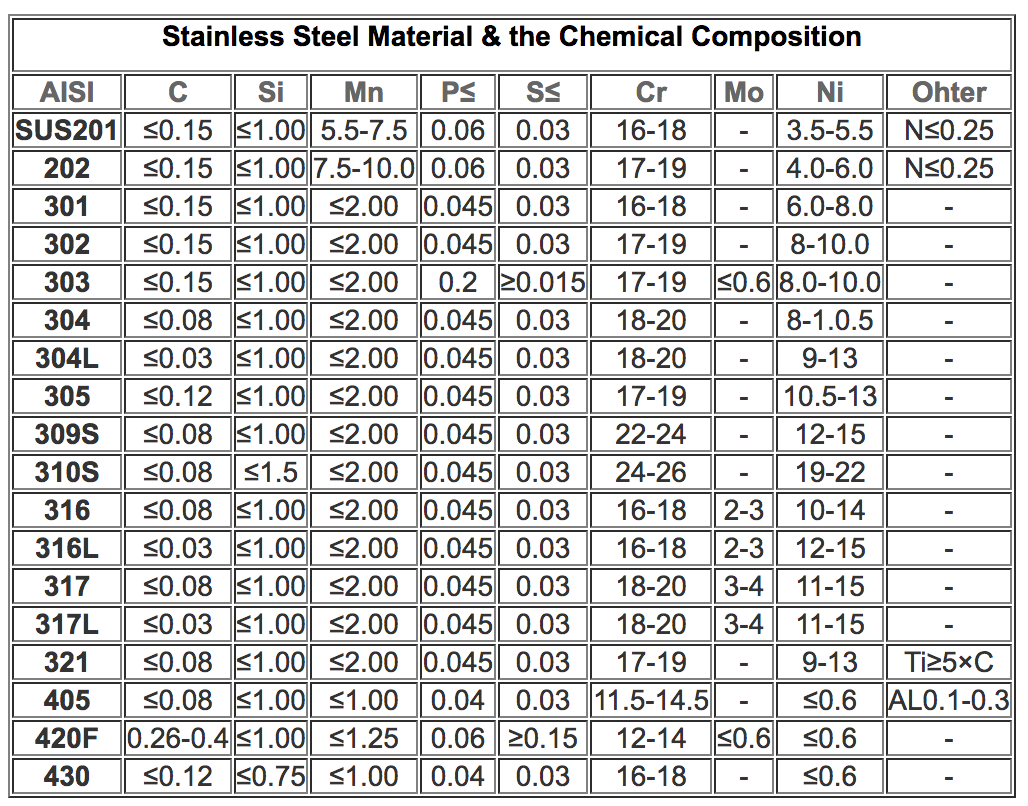

Vaportron Posted December 27, 2015 Report Posted December 27, 2015 HugeEgo said:If you want to use SS, it's best to probably go with 317L, which has the highest corrosion resistance of all (readily available) grades of SS. 316L would be the 2nd best.What about nickel free (>1%) SS 430 ?
HugeEgo Posted December 27, 2015 Report Posted December 27, 2015 Vaportron said:[QUOTE=HugeEgo]If you want to use SS, it's best to probably go with 317L, which has the highest corrosion resistance of all (readily available) grades of SS. 316L would be the 2nd best.What about nickel free (>1%) SS 430 ?[/QUOTE]430 has less corrosion resistance than 304/316, but it is nickel free and has a higher TCR. So, it's a trade-off.

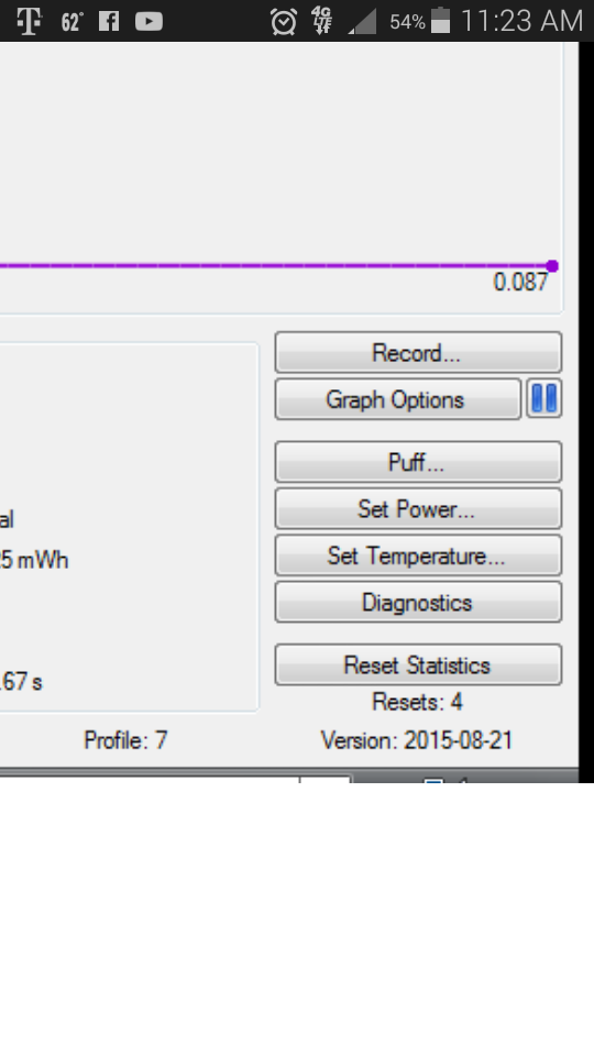

Modbustersecig Posted October 22, 2016 Report Posted October 22, 2016 VapingBad said:I would think you are right and the mass of the coil also affects how smoothly it can be regulated. I was looking at the version of the software he was using it that not the one that caused problems I'm asking not saying if I'm reading it right it's the 8th month of 2015
