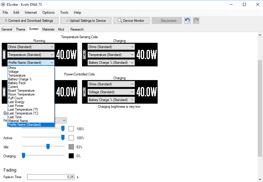

retird Posted November 8, 2016 Report Posted November 8, 2016 Go to the Screen Tab in EScribe. There are your choices (drop down boxes with choices) to configure what is displayed on screen... Try them out and learn what they do...
coolsom3a Posted November 8, 2016 Author Report Posted November 8, 2016 Thanks for taking time to screenshot and attach, thats exactly what I did I tried each and everyone of them, and only one volt related which is volt and still gives me 0 as usual, I thought there was a work around or some kind of customization
