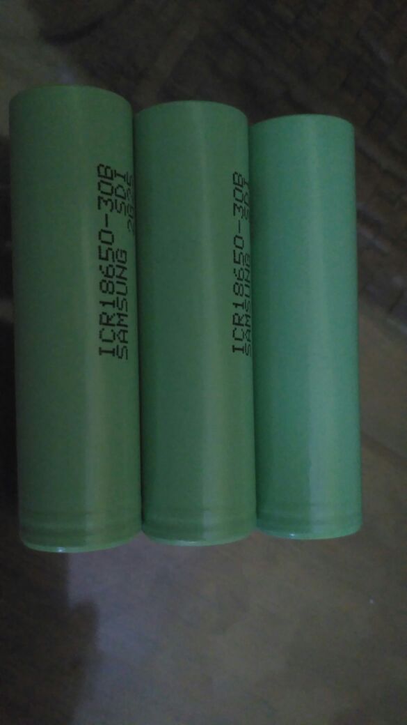

Reezco Posted November 26, 2016 Report Share Posted November 26, 2016 Reezco said: Hi retird,thanks The heat is on rda and the mod at battery area,and when im firing i put my finger to the battery cover and it is hot,after 5-8 firing all body getting hot.i will try to to clean the battery cover threads, Hi friends, Can i use samsung ICR for my vt75 nano? Link to comment Share on other sites More sharing options...
dwcraig1 Posted November 26, 2016 Report Share Posted November 26, 2016 Reezco said: Hi friends, Can i use samsung ICR for my vt75 nano?Samsung ICR18650 30B has a CDR of 5.9 amps. NO WAY, I'm not saying it won't work, I'm saying it won't be safe to do so. Link to comment Share on other sites More sharing options...
VapingBad Posted November 26, 2016 Report Share Posted November 26, 2016 I don't think it is unsafe as the board will see how much it struggles to provide enough current and lower the power, but definitely not a suitable battery. Link to comment Share on other sites More sharing options...
