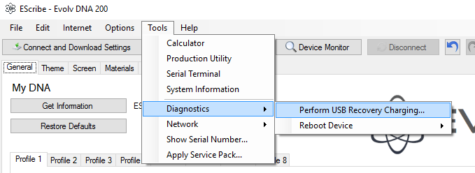

VapingBad Posted November 28, 2016 Report Posted November 28, 2016 Are any of the cells below 2.5 V, you can check in EScribe - Device Monitor, if so you either need to return it to the vendor as they should not be sold in that condition and if they are very low for a long time it ages the battery and cane even stop them working altogether or you can try EScribe - Tools - USB Recovery Charge.

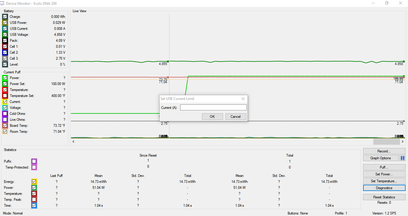

fibercarbon Posted November 28, 2016 Author Report Posted November 28, 2016 I see an option to change the usb current limit is that what i change? if so what do i set it to.. this is a screen shot of my device monitor
retird Posted November 28, 2016 Report Posted November 28, 2016 Yep... you have never even used the device..... Device shipped with batteries too low.... VapingBad's post gives you good guidance....Contact vendor and/orEScribe - Tools -Diagnostics - Perform USB Recovery Charging.

fibercarbon Posted November 28, 2016 Author Report Posted November 28, 2016 i tried the usb recovery feature and it is not rising at all...what number should i set for the "SET USB Current limit" ??
retird Posted November 28, 2016 Report Posted November 28, 2016 I see you plugged in a different device as it has very low battery cells also.. Set the Current to 1A as that is the max for the DNA200. If charging from a computer it may only charge at 0.5 A....The charge time will take a while so be patient...

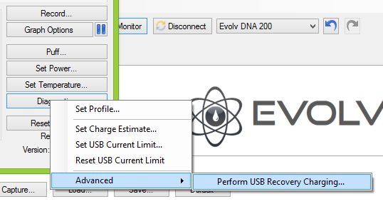

VapingBad Posted November 28, 2016 Report Posted November 28, 2016 fibercarbon said:i tried the usb recovery feature and it is not rising at all...what number should i set for the "SET USB Current limit" ?? That is not USB Revovery Charging, you don't need to change the thing you are looking at.Go here or here on older versions of EScribe < V1.2, same thing

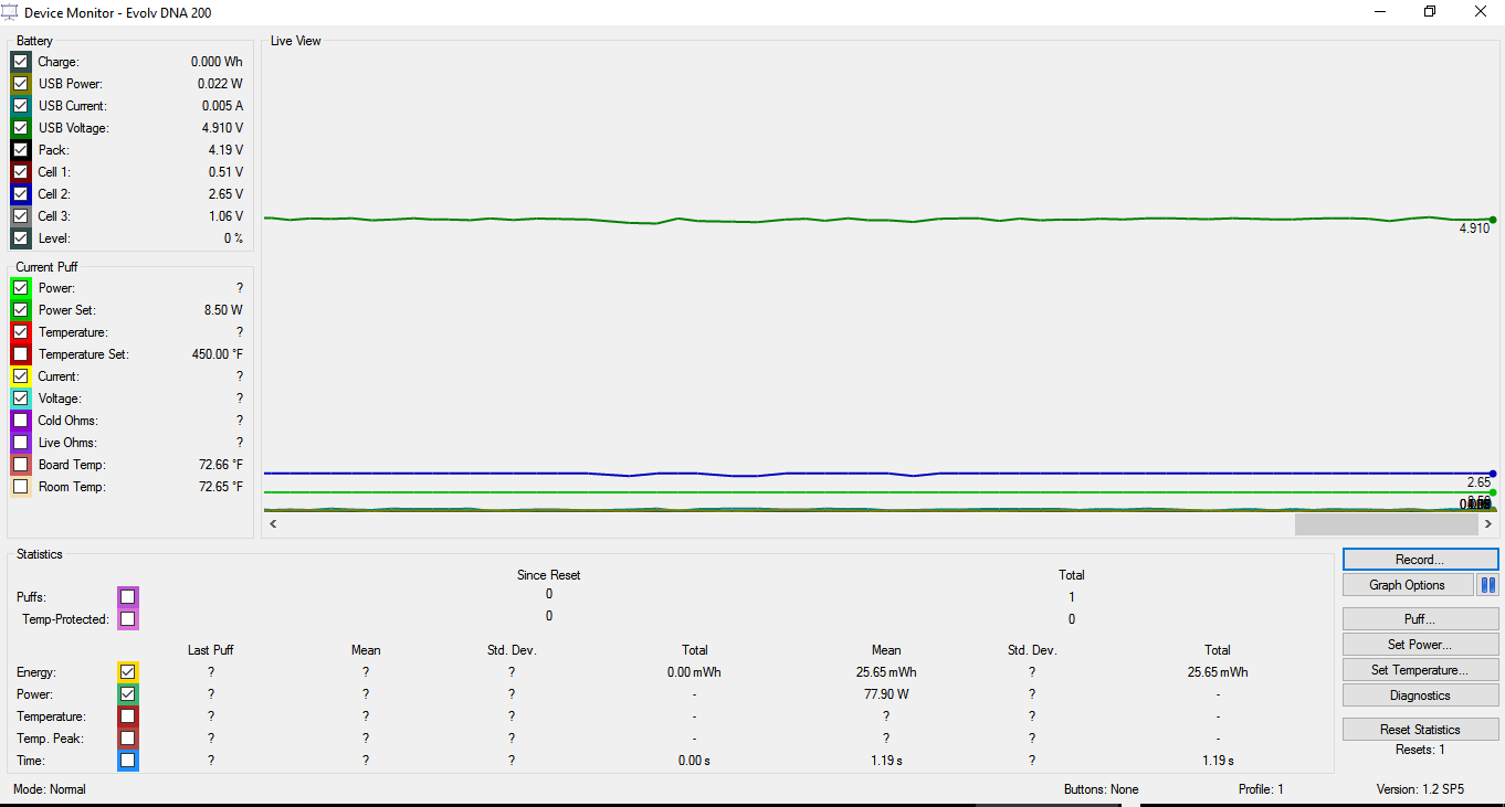

fibercarbon Posted November 28, 2016 Author Report Posted November 28, 2016 I followed the above twice on the HCigar VT200 and it still is not going up.
fibercarbon Posted November 28, 2016 Author Report Posted November 28, 2016 the battery is not showing the lightning bolt its just blank still... I am assuming it is not charging.

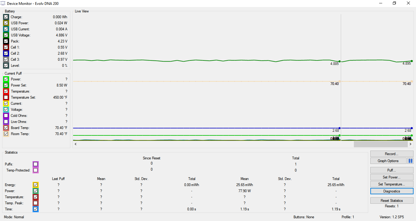

VapingBad Posted November 28, 2016 Report Posted November 28, 2016 Cells 1 & 2 have gone up, it can take a while and several tries as it uses a low current and has a short time limit for safety, but if that cell has sat at 0.01 V for a while it may be permanently damaged and never hold charge again.
fibercarbon Posted November 29, 2016 Author Report Posted November 29, 2016 i tried several times still not going up.. I am trying to contact the store I got it from
