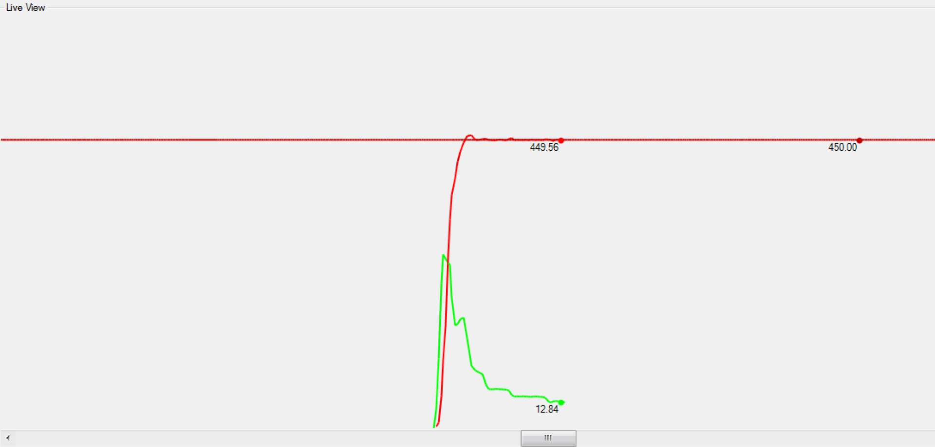

Using your normal settings -> With Device Monitor running, and mod sitting on the table ....... on the left click on Power, Temperature and Temperature Set. On the bottom right hand corner choose "Puff", then 4 seconds. Escribe will fire the mod for that duration. Watch the red line as it climbs to what you set. Now do the same thing AFTER changing to the more aggressive settings.
Apart from a more linear increase in the test settings, you should also notice how that Power (green) curve has decreased more than half in both. It's really there just to get your coil up to temp.
