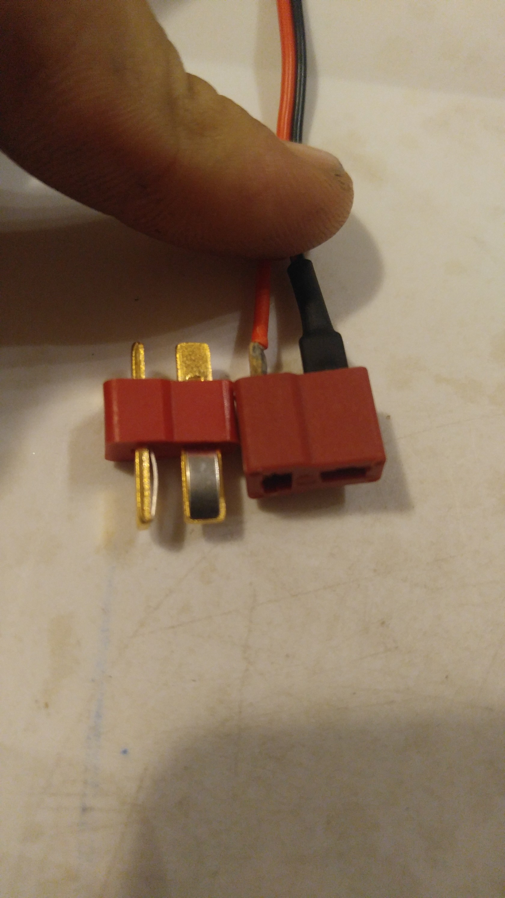

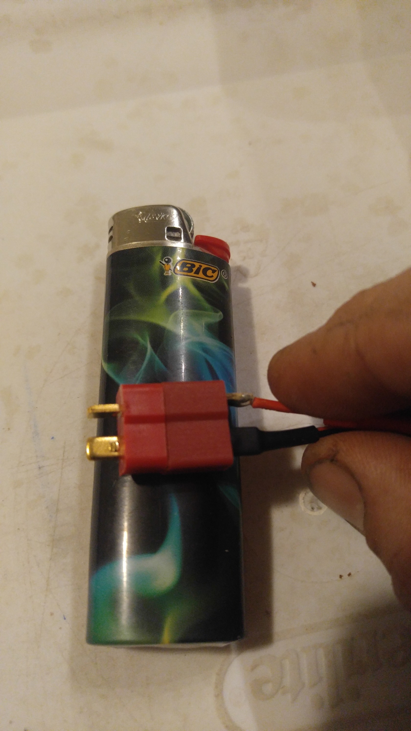

67exec Posted January 1, 2017 Author Report Posted January 1, 2017 I bought an empty silo-950 box from protovapor and a DNA 250 board to do my 1st build. I want to be able to swap batteries in the field, and was wondering what connector to buy? I see lots of xt60, and e30, or just bullets, but have never seen a dean's ultra aka t-plug. I know the authentic dean's are rated for 30+ amps and know that they can handle 80-100amps for 15min solid in rc applications. Plus they are smaller than the others that I listed. Now I'm just curious why I haven't seen them in mods??
Spector NS5 RD Posted January 1, 2017 Report Posted January 1, 2017 i can think of one mod manufacturer that uses the t plug, VapeCige VTBox200. it's good connector, should do the job fine.
Spirometry Posted January 1, 2017 Report Posted January 1, 2017 You will have a hard time fitting any type of battery connector in a silo/erm box
Spector NS5 RD Posted January 1, 2017 Report Posted January 1, 2017 true....just enough room for the JST-XH balance plug. other than that....i doubt you'll even get a Xt30 to fit.

67exec Posted January 4, 2017 Author Report Posted January 4, 2017 So I started getting this sorted out, and there's definitely not enough room in the silo-950 case for the dean's connector, now looking at bullets with short wires to point up and loop back down
VapingBad Posted January 4, 2017 Report Posted January 4, 2017 Even bullets are hard to fit due to there length and how short you would need to make the battery leads. I have done 4 of these and soldered the battery directly to the board, I put some kapton tape over the underside of the balance connections so I don't short them fitting the board, you can also put some kapton around the inside of the case if you want.
67exec Posted January 15, 2017 Author Report Posted January 15, 2017 Solid advice and worked like a charm, thanks
