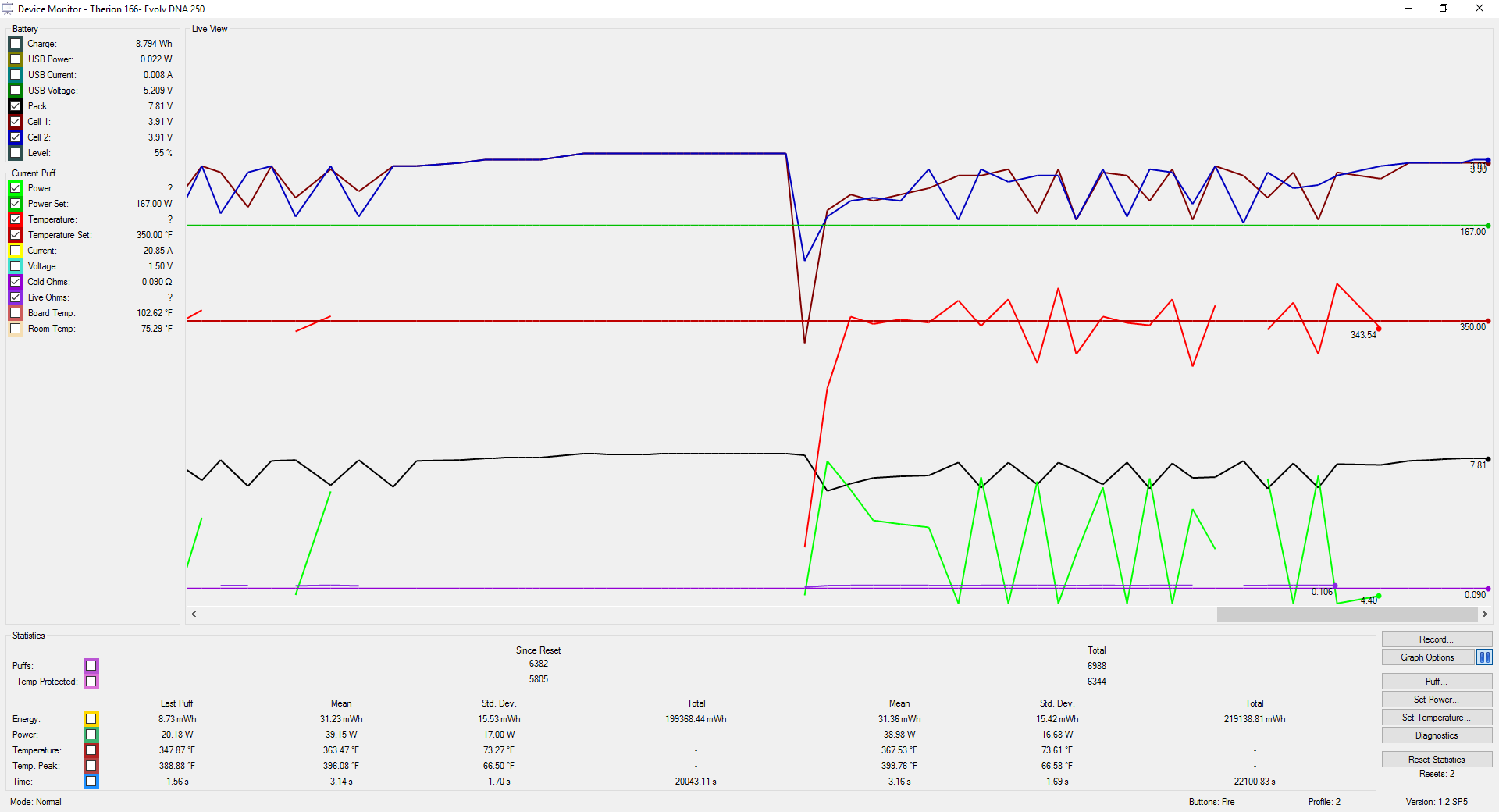

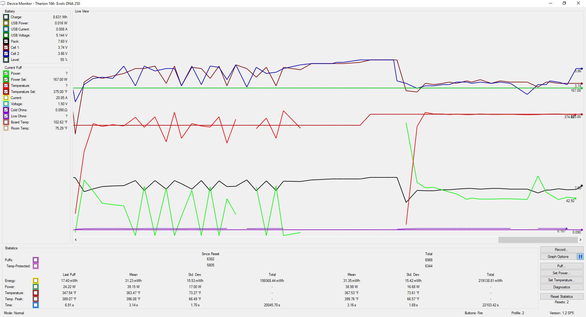

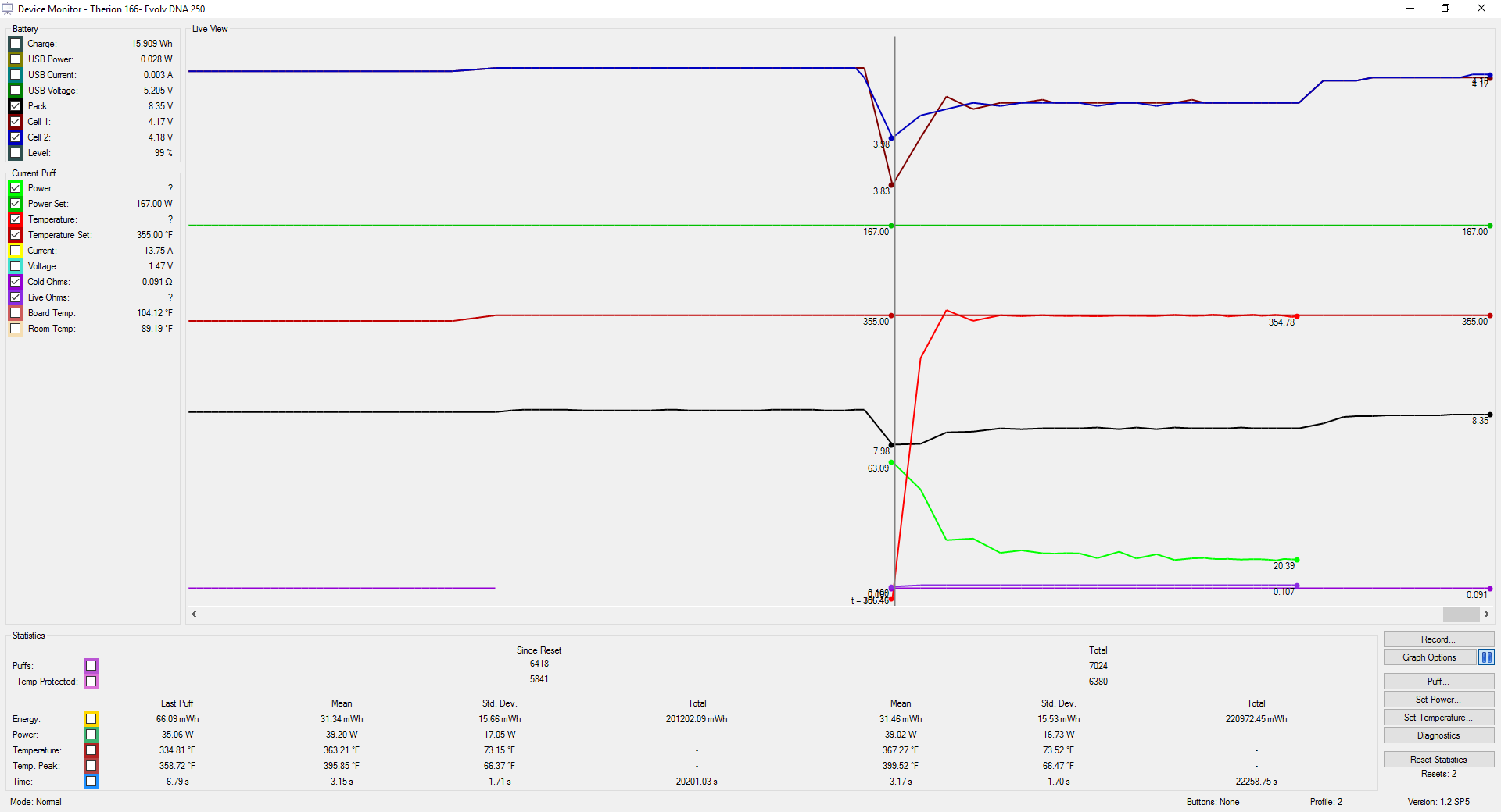

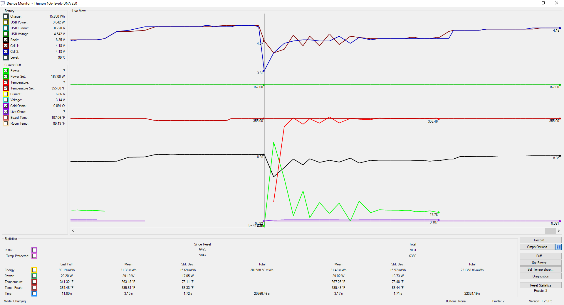

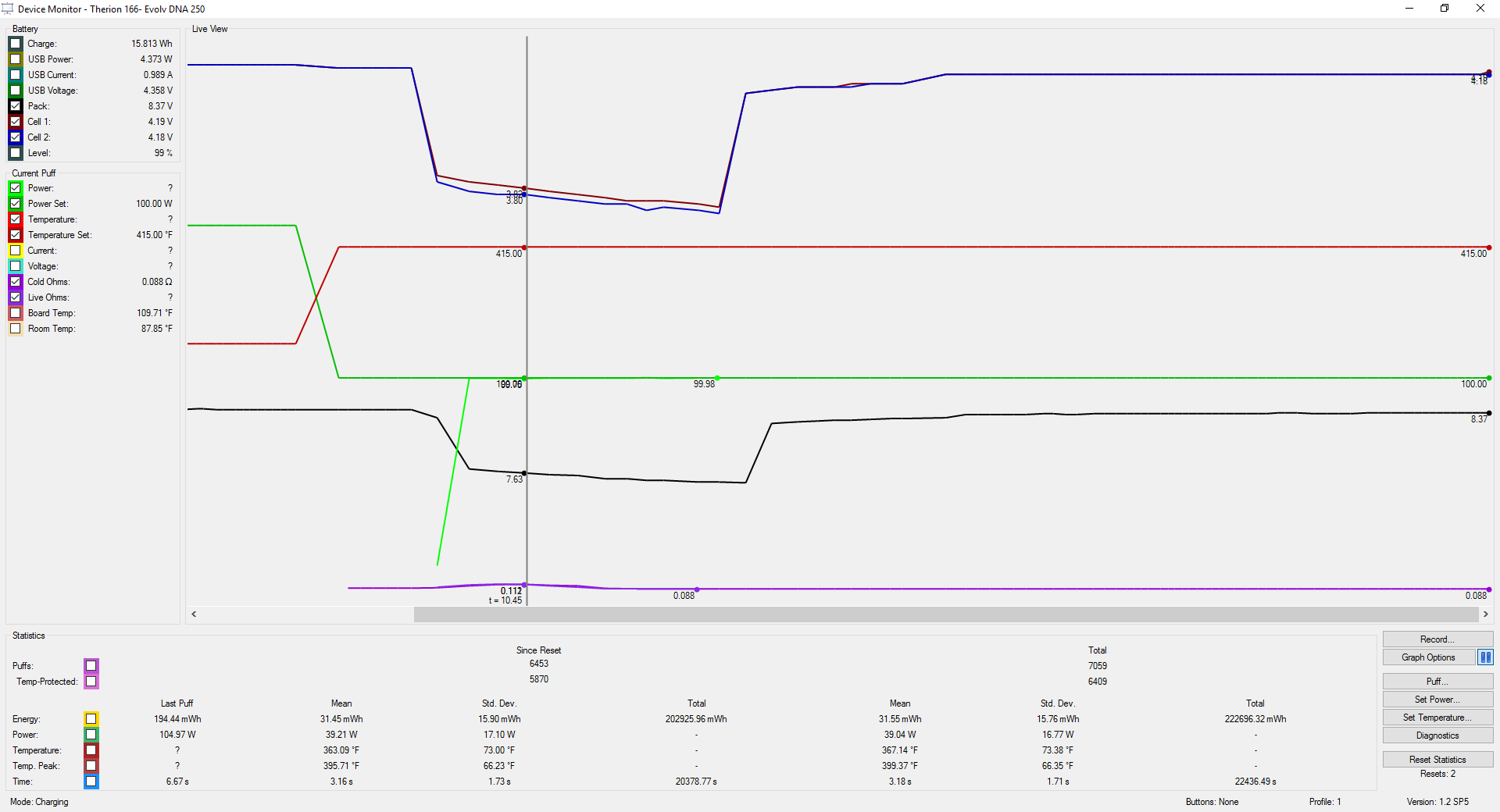

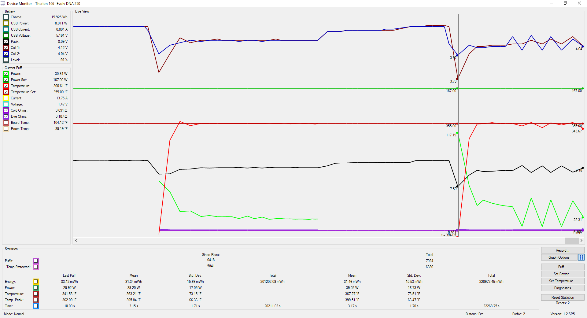

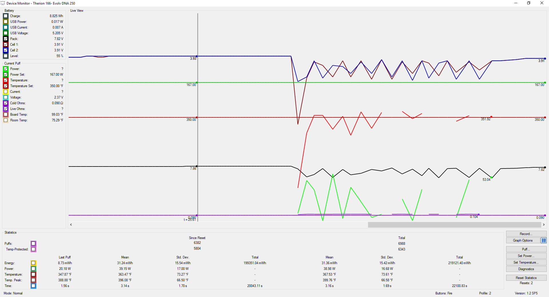

giz_60 Posted January 24, 2017 Author Report Posted January 24, 2017 Hey guys...have noticed a few times that I could feel the pulsing of the device & temp rising & falling. Was finally able to catch it on Device Monitor. Seemed like every time I tried before, it would clear up. This is on a Therion 166, 250 chip, SC Aromamizer, dual coil, 24g, 316L, about 6 or 7 wraps & clocking in at .09 ohms. In the screenshots attached, you can see the fluctuation when at 350F, but when I cranked it up to 375F, the fluctuation stopped. The third screenshot shows when I cranked it up to 375F. Every thing bounced around with it except for the cold & live ohms. Atomizer analyzer showing stable build. Checked all connections, etc... Any ideas?Edit...It has happened on different atty's as well, not just this one
Spector NS5 RD Posted January 24, 2017 Report Posted January 24, 2017 you appear to be hitting your "cell soft cutoff" value. that is the reason for cutting in and out of the vape. cell 1 takes a dive and cuts your vape (safety feature to keep all cells balanced and draining evenly when fired). what is the value you have set for the cutoff voltage? too high, and this is the behavior you can expect. if you're using 18650's, i would try 2.85v.

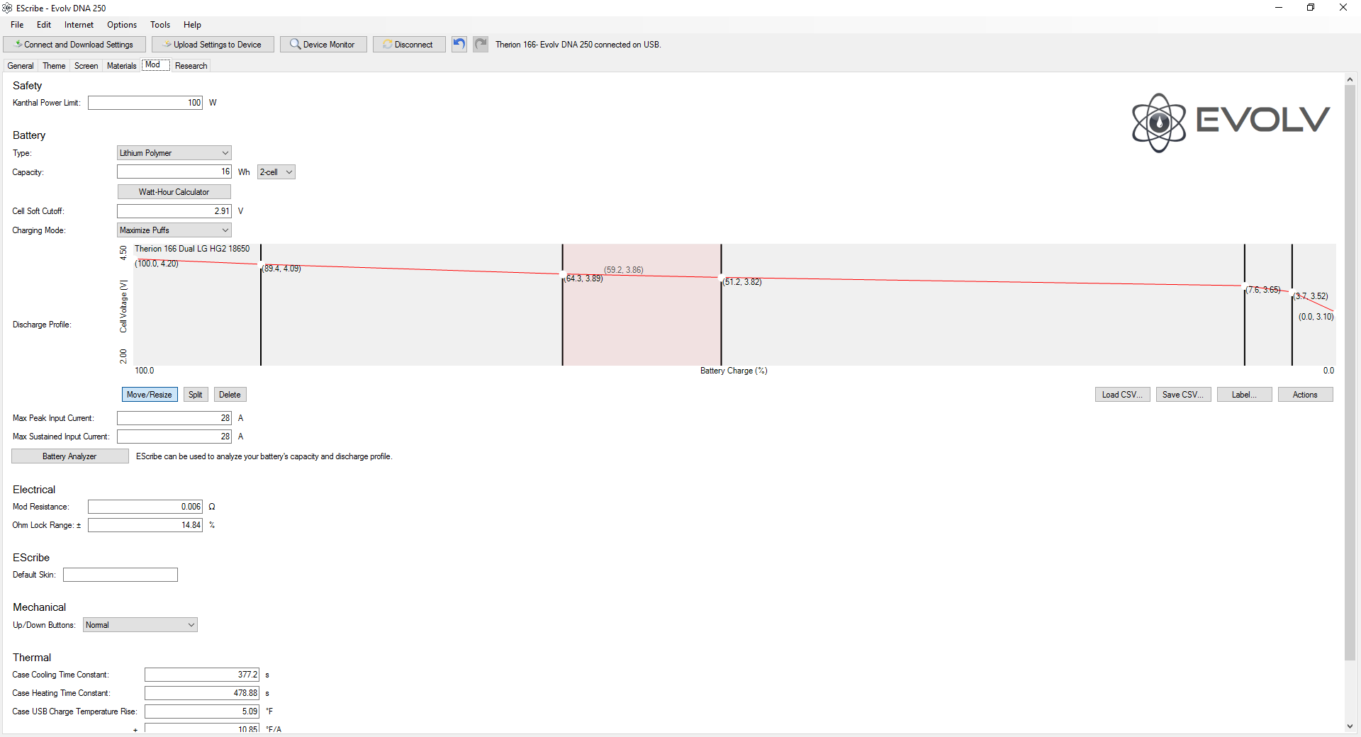

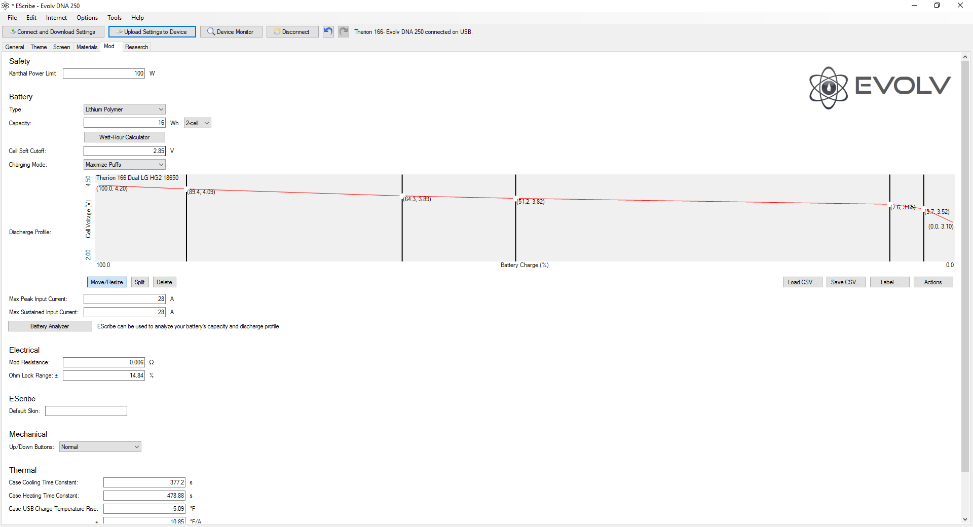

giz_60 Posted January 24, 2017 Author Report Posted January 24, 2017 Cell cut off is set at 2.91...attached screen shot of mod settings.Changed out with fresh batteries...screen shot of device monitor after battery change out

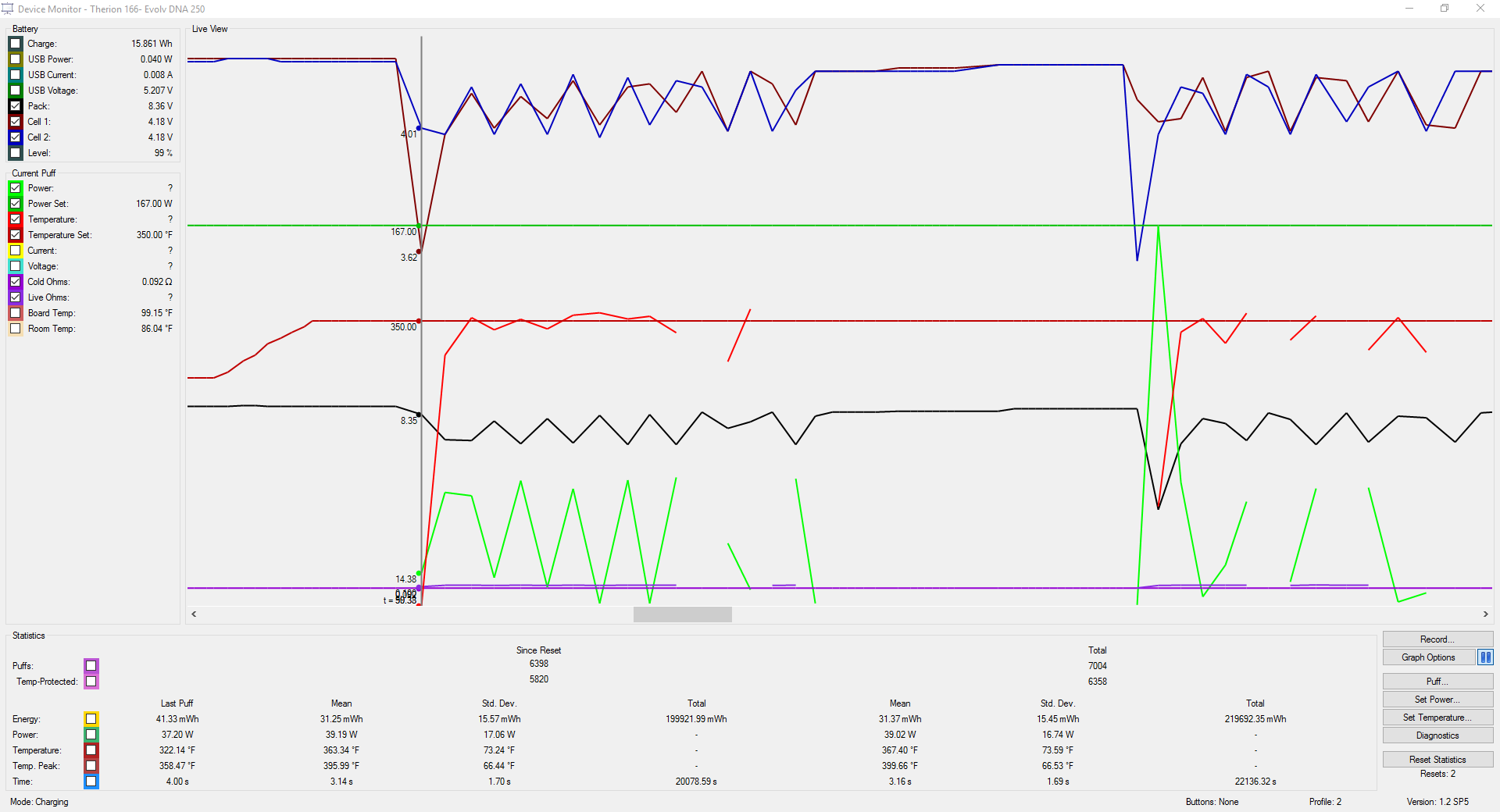

Spector NS5 RD Posted January 24, 2017 Report Posted January 24, 2017 you have your kanthal limit set to 100w. but you have your set wattage at 167? why? what is lowest voltage of cell when the fire button is first pressed? seems your cells are bottoming out. put the curve at the lowest point in cell1/2's "valley" in device monitor and report back the lowest volatge seen.

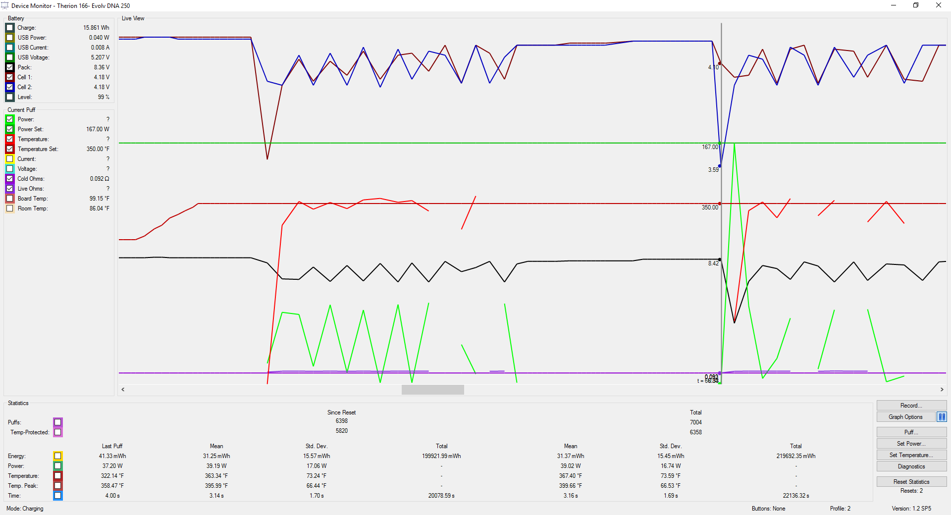

giz_60 Posted January 24, 2017 Author Report Posted January 24, 2017 Not sure about the Kanthal limit setting...never use power mode except to burn in coils...always use TC. Here are a couple of screen shots showing 2 different fire button presses but in the same frame...

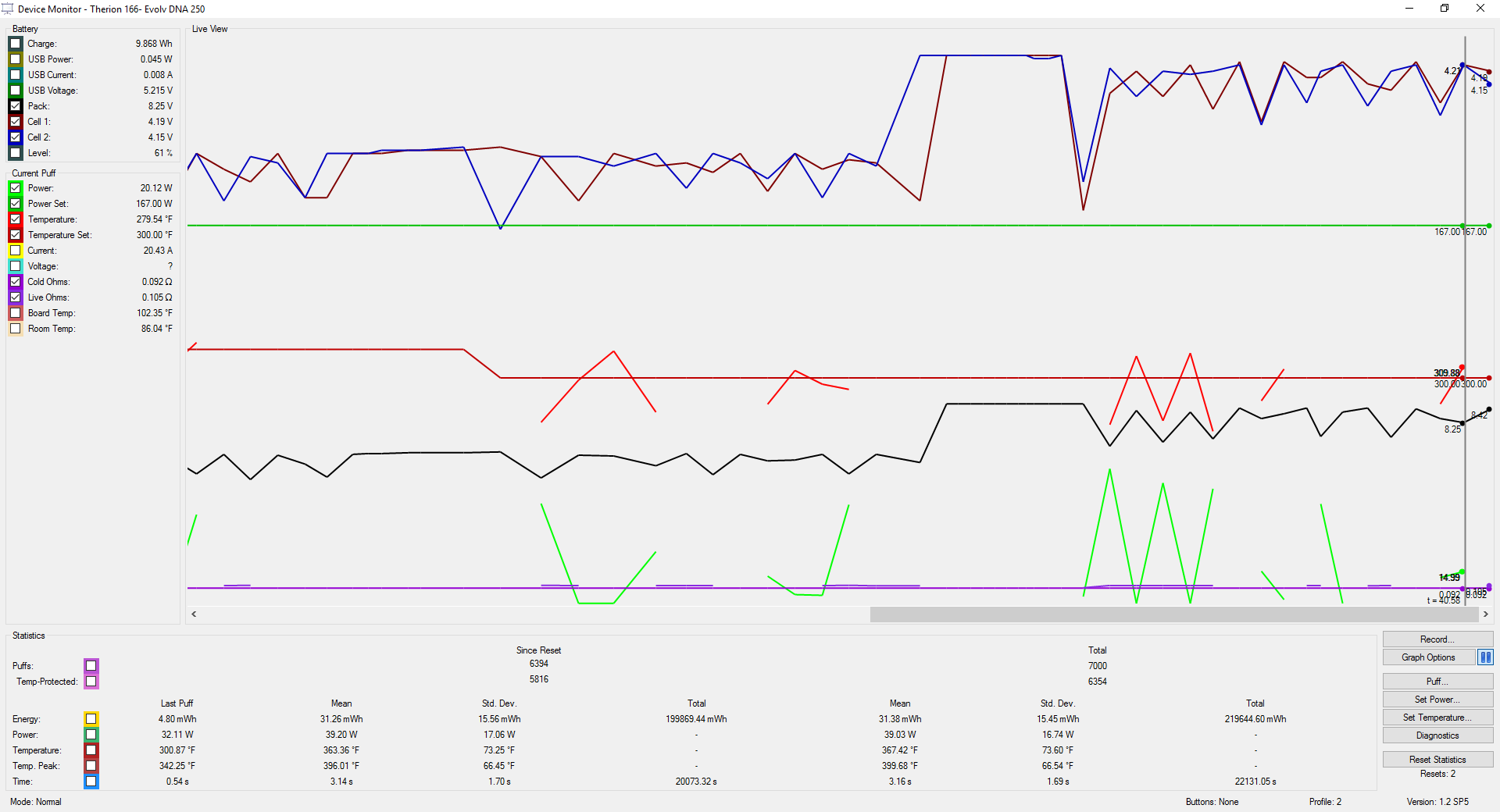

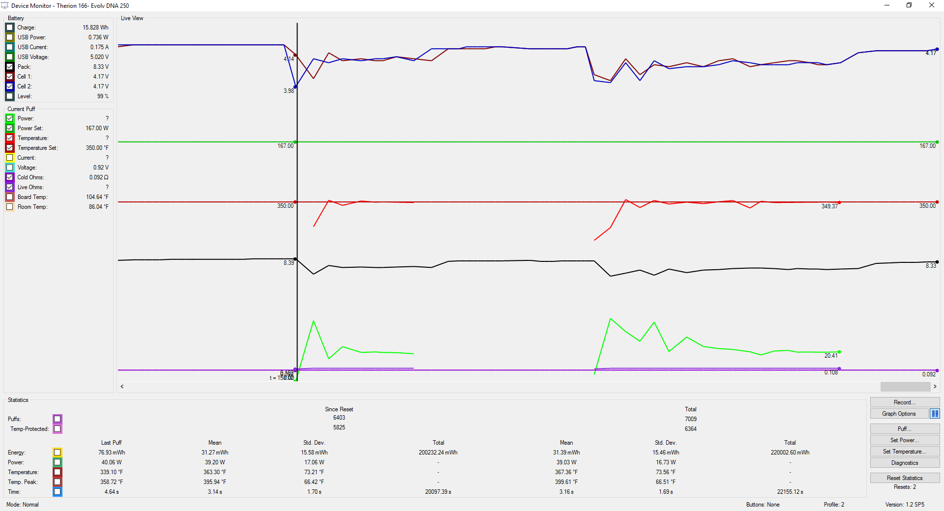

giz_60 Posted January 24, 2017 Author Report Posted January 24, 2017 Ok...haven't changed any settings & now it seems to be back to normal...this is about how this seems to happen. This is longest it has acted like this, was never able to get screen shots before. Here is a new screenshot ...
Spector NS5 RD Posted January 24, 2017 Report Posted January 24, 2017 giz_60 said:Not sure about the Kanthal limit setting...never use power mode except to burn in coils...always use TC. Here are a couple of screen shots showing 2 different fire button presses but in the same frame... what i meant was, when device acts up, move the cursor to see the lowest point of any of the 2 cells. your earlier screenshots showed some heavy voltage sag on cell 2. you need to measure the voltage when the device isn't working properly.i thought the kanthal limit carried carried over to TC, it apparently doesn't.

giz_60 Posted January 24, 2017 Author Report Posted January 24, 2017 Ok...Cell soft cutoff set at 2.85 now.... and uploaded to device...

Spector NS5 RD Posted January 24, 2017 Report Posted January 24, 2017 something is telling the DNA board to cut power...in and out....in and out.....in and out. either sag or a poor connection whether it's cell related or....? poor or dirty cell contacts? weak connection pressure against the cell... you see how cell 1 looks like a saw tooth? but cell 2 is smoother. if you spin or wiggle the cells, while firing, does the behavior get worse/improve?are you getting the "check battery" or "imbalanced cell" error on the mod's screen when this is happening?
