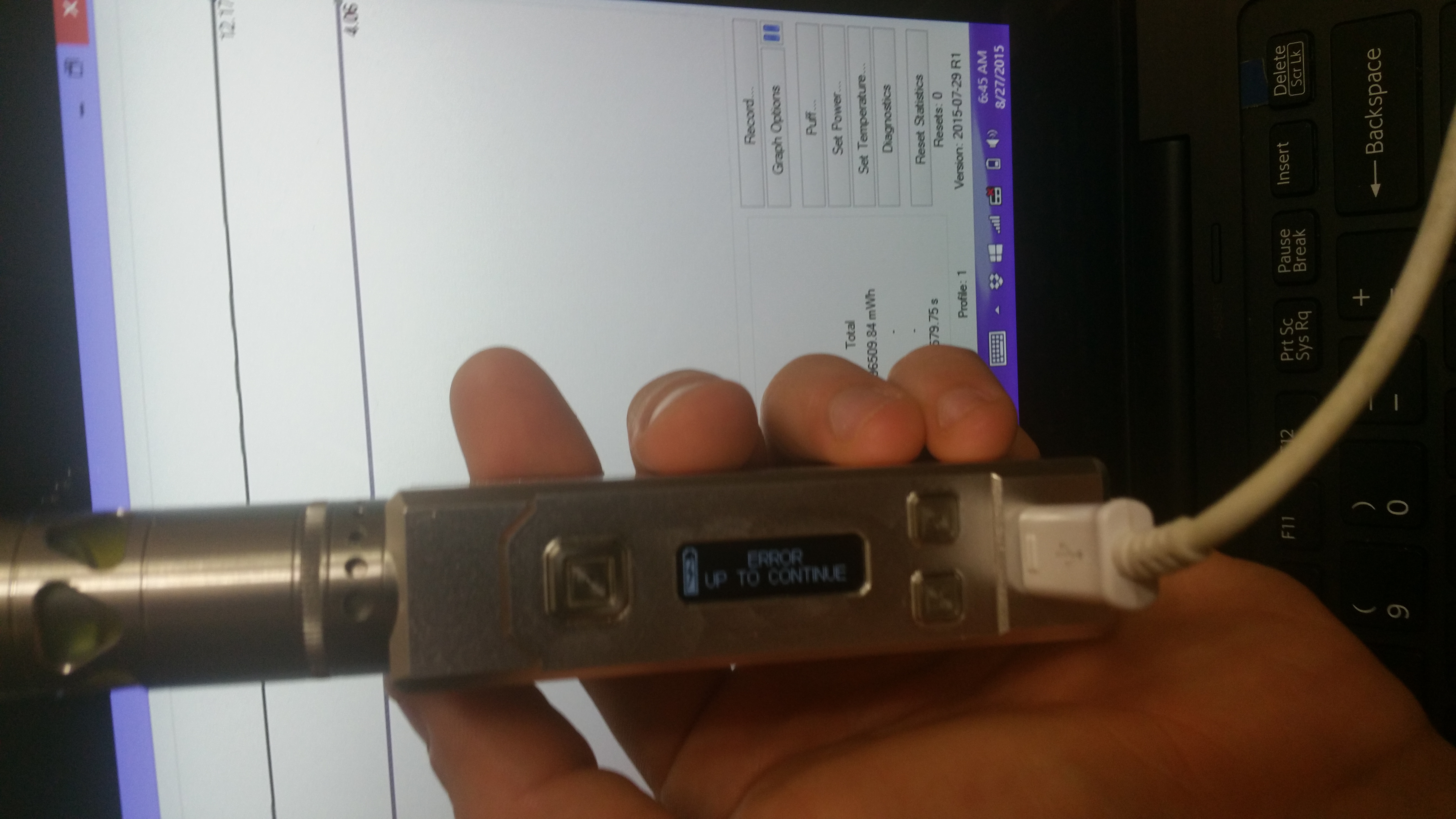

iandvaypes Posted August 27, 2015 Report Posted August 27, 2015 dc601 said: It may be a "custom screen" put in the Littup44 by whoever built it. Maybe ya need to contact the vendor and get an explanation. Expand It is an evolv error screen. This happened on my evolv beta mod. I woke up this morning, unplugged my device as usual, tried to take a vape (yes I vape first thing in the morning while still in bed), then I got no vape, checked the screen and nothing, then I saw the error message but at only 5% brightness. As I try and squint to see what was going on, boom full brightness. This was rather disturbingly bright before my eyes could adjust. "ERROR PRESS UP TO CONTINUE." What do I do? I press up. It's vaping like normal. Except my mod is fully charged and all cells are at 4.2 volts. Personally, if I were to guess, it was protecting the cells from overcharging. I'm not sure though, I'm not evolv. Only someone in evolv can explain this. I did check the manual and according to the manual, no such error message exists. Yet the error does exist. I'll post a pic if it happens again.

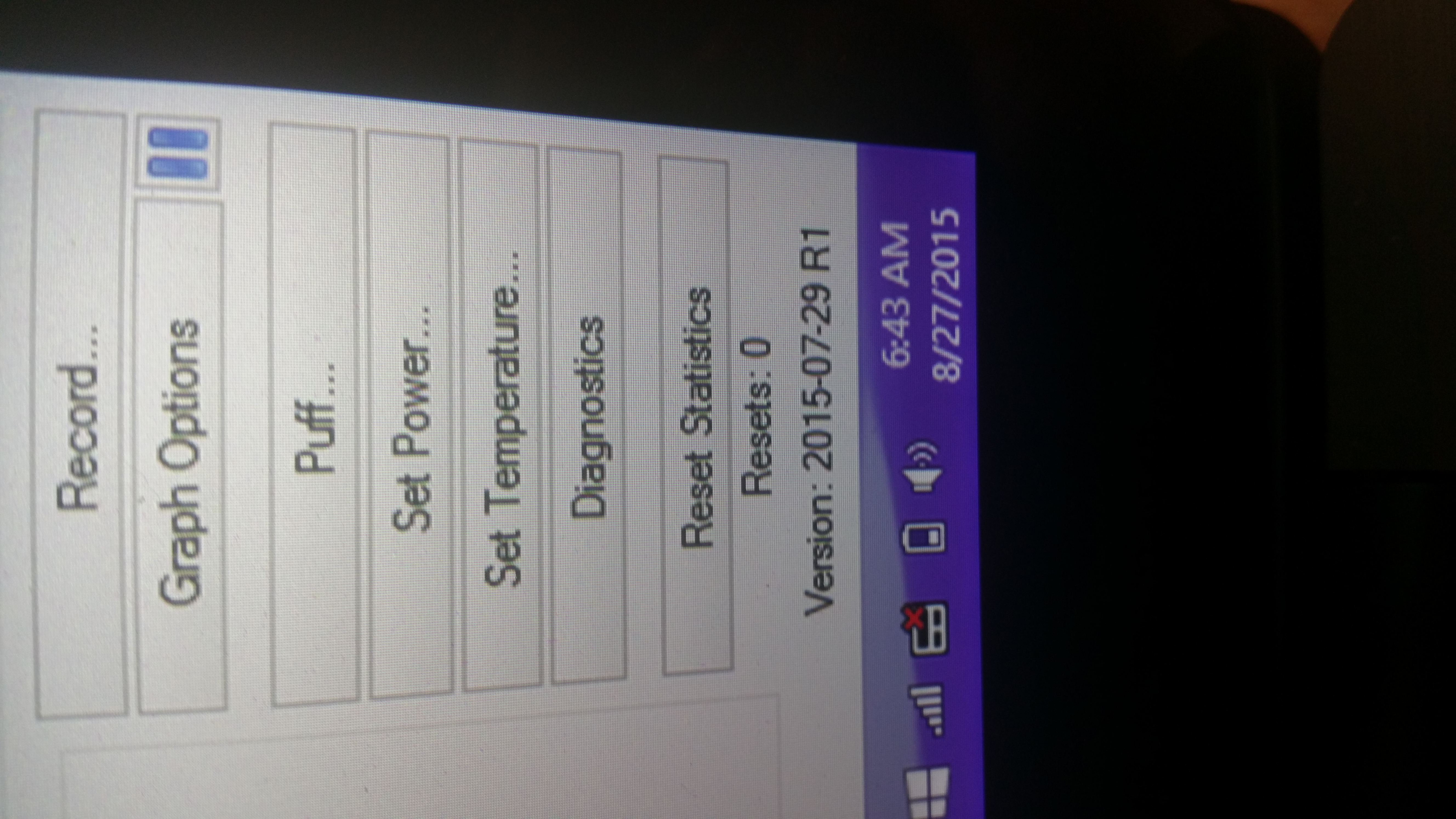

iandvaypes Posted August 27, 2015 Report Posted August 27, 2015 It did it again while on escribe. ?????

iandvaypes Posted August 27, 2015 Report Posted August 27, 2015 James said: Oh, I mean your EScribe settings.iandvapyes: This happened to you before 8/21 then? How long have you been encountering it? Expand Still on the 7/29 r1. It just started it this morning

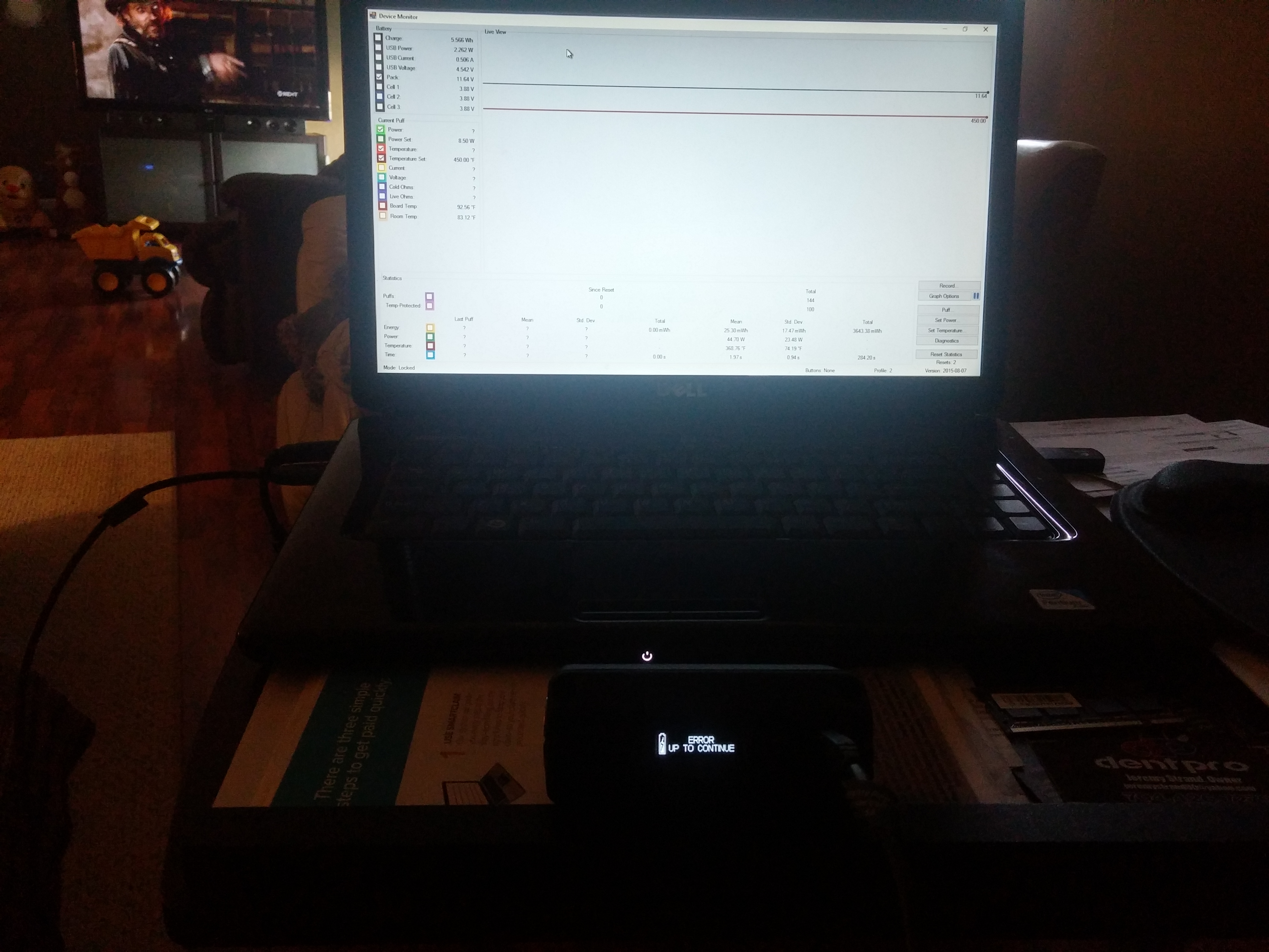

mechaet Posted August 28, 2015 Author Report Posted August 28, 2015 Just had it happen again.http://puu.sh/jR3X5/88c35bedc6.pnghttp://puu.sh/jR3YQ/03edd53f48.png
scoopy Posted August 28, 2015 Report Posted August 28, 2015 Iandvaypes. ...try the 8-21 firmware and see if it still does it.....not sayin it will fix it but it's worth a shot
James Posted August 28, 2015 Report Posted August 28, 2015 mechaet could you save and post your settings file? I don't see anything unusual on those screens.
