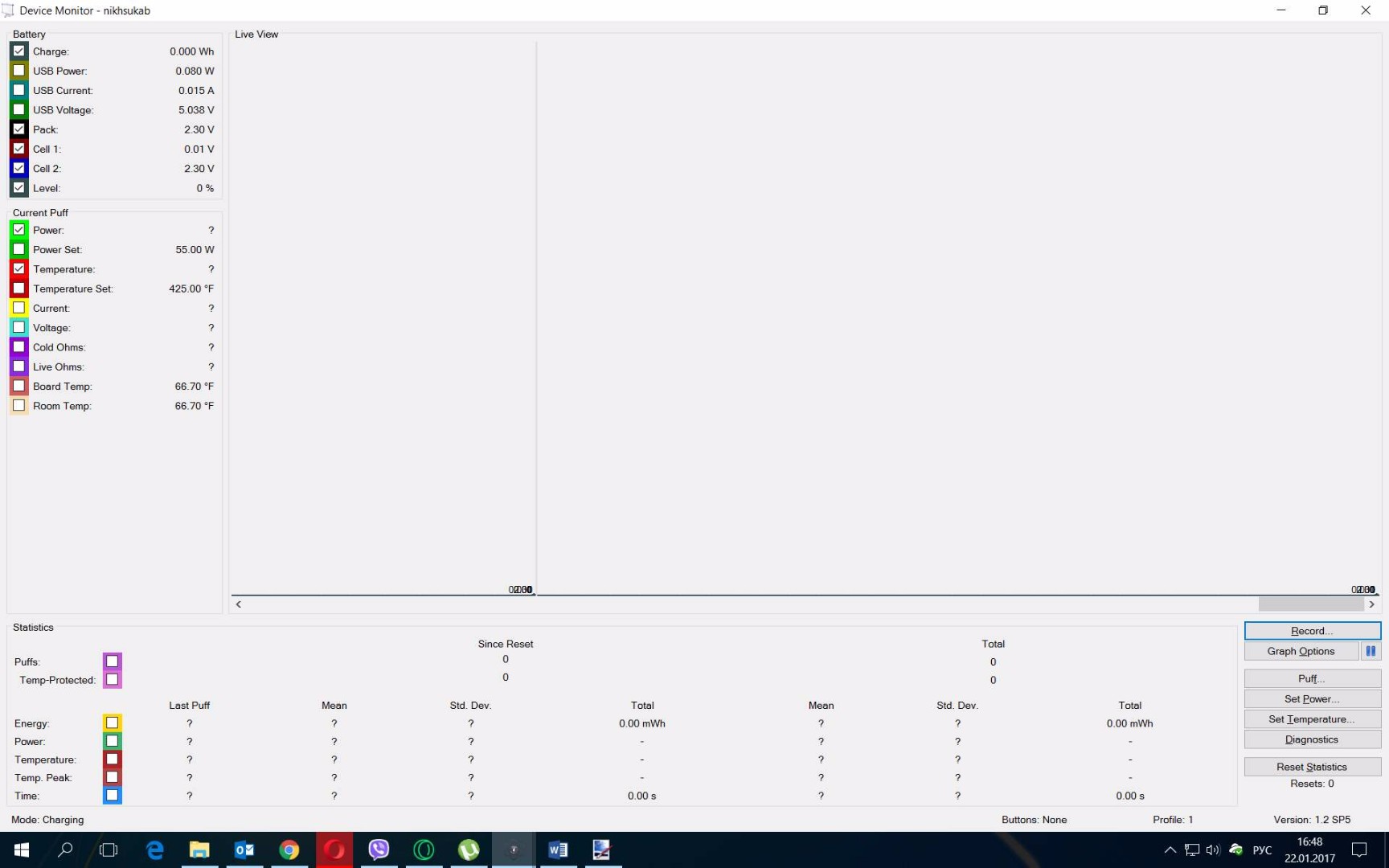

olegasan Posted January 22, 2017 Report Share Posted January 22, 2017 If I change slot with 1 battery, picture in Device monitor does not change (again voltage 2,81V only in cell 2). Link to comment Share on other sites More sharing options...
retird Posted January 22, 2017 Report Share Posted January 22, 2017 Does the "Pack voltage" change depending on where you plug in the battery? Link to comment Share on other sites More sharing options...
olegasan Posted January 22, 2017 Report Share Posted January 22, 2017 Nope. And one more strange thing. Picture from Device Monitor without batteries: Link to comment Share on other sites More sharing options...
retird Posted January 22, 2017 Report Share Posted January 22, 2017 hum, did you unplug the device, take out the batteries and then plug it back in and you got the same voltage without any batteries in the device? Link to comment Share on other sites More sharing options...
olegasan Posted January 22, 2017 Report Share Posted January 22, 2017 Reconnecting does not give any changes. Link to comment Share on other sites More sharing options...
retird Posted January 22, 2017 Report Share Posted January 22, 2017 OK, just checking.... that's about all I can think to check without putting a meter on the main inputs of the board.... do let us know what you find out....THX Link to comment Share on other sites More sharing options...
