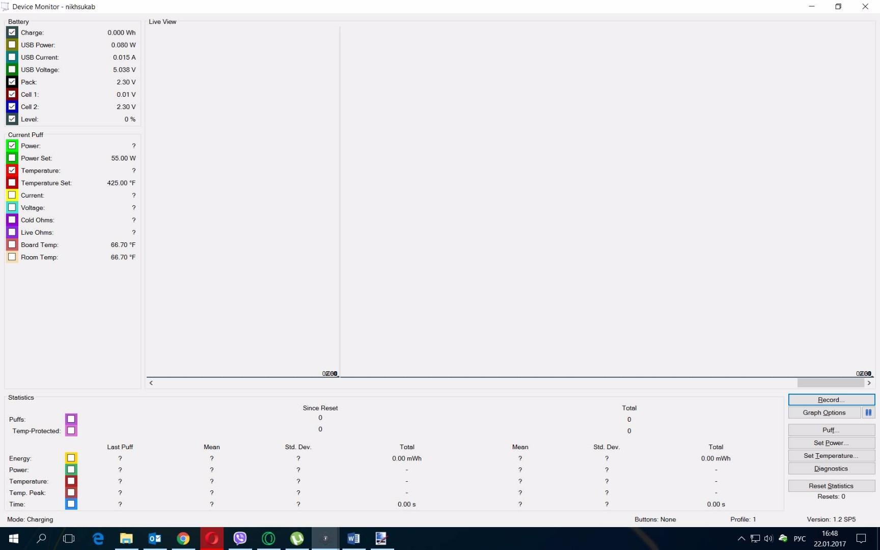

  1. Nope. And one more strange thing. Picture from Device Monitor without batteries:

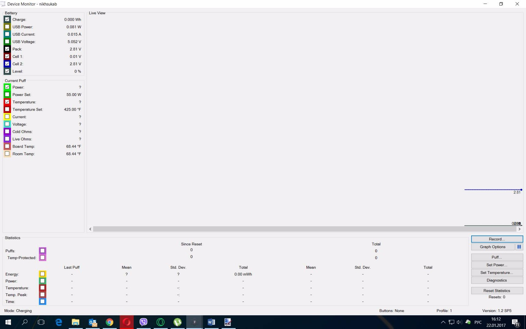

  2. If I change slot with 1 battery, picture in Device monitor does not change (again voltage 2,81V only in cell 2).
  3. retird, if I in mod only 1 battery device monitor shows 2,81V (see attached screen). Charger shows 4,22V.
  4. @etird, I haven’t any matters and couldn’t check voltage in mod. I have only mod, atomizer and lots of batteries. 5,24V coming out of 2 batteries but mod think that’s from only one of 2. I’ve written this info to Evolv and waiting for the answer.
