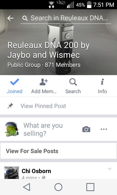

Spector NS5 RD Posted December 4, 2015 Report Posted December 4, 2015 joined the relo fb group. it's true that the ribbon does slightly rub on the bottom of the fire button. took mine apart and noticed there is no s bend in the cable. un stuck screen from board, put s bend in ribbon, replaced, and done! potential crisis averted.

nomad2000 Posted December 4, 2015 Report Posted December 4, 2015 joined the fb group, it's true. and there is a detail step by step instruction for howto fixing it. I've done it with 5min, hah ,
