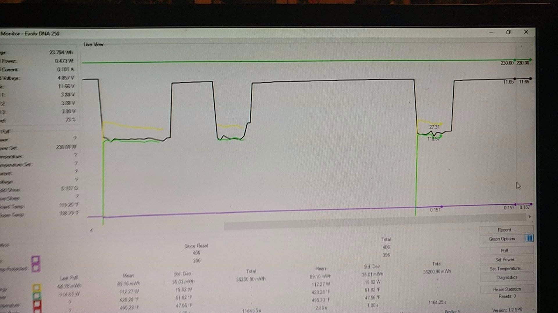

Evo1340 Posted February 12, 2017 Report Share Posted February 12, 2017 Same type of issue I just posted about yesterday. Link to comment Share on other sites More sharing options...

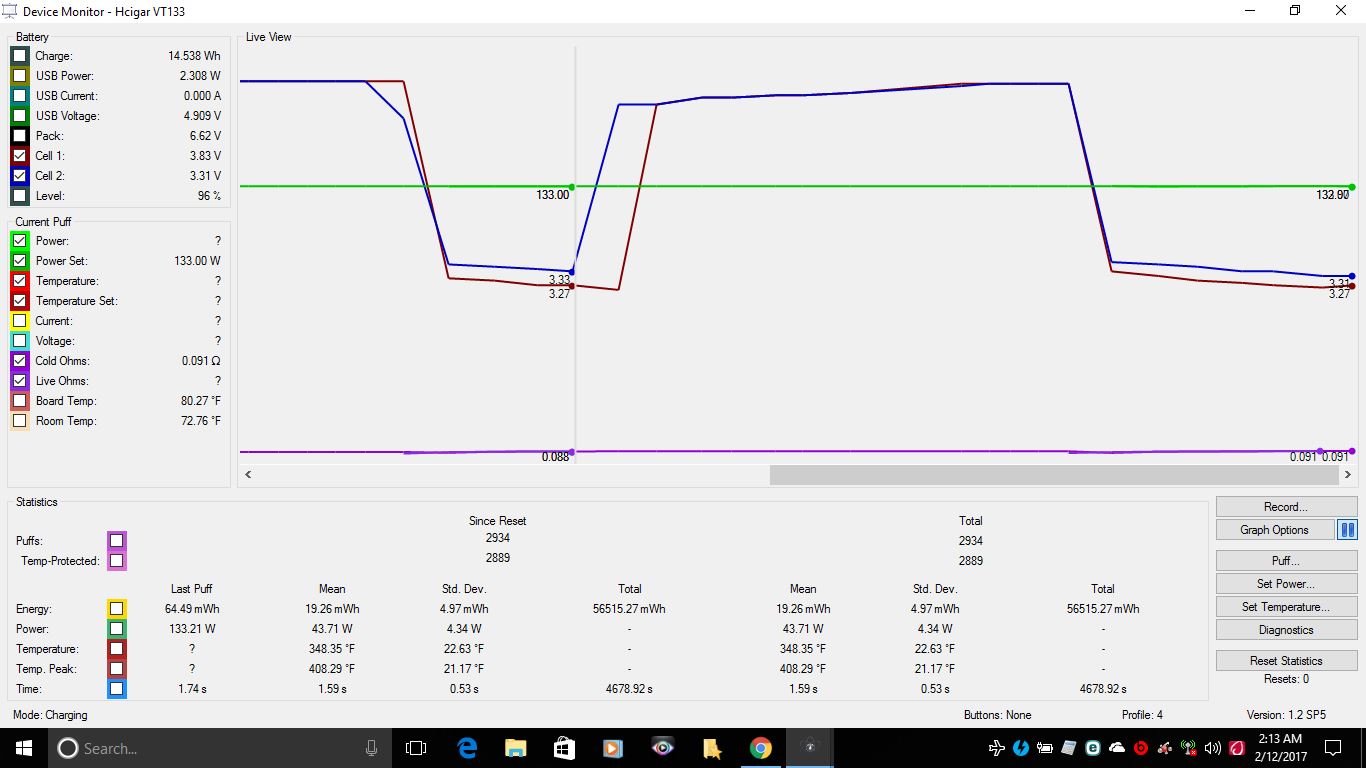

dwcraig1 Posted February 12, 2017 Report Share Posted February 12, 2017 Set at 133 watts, got 133 watts....for sure pushing it Link to comment Share on other sites More sharing options...
