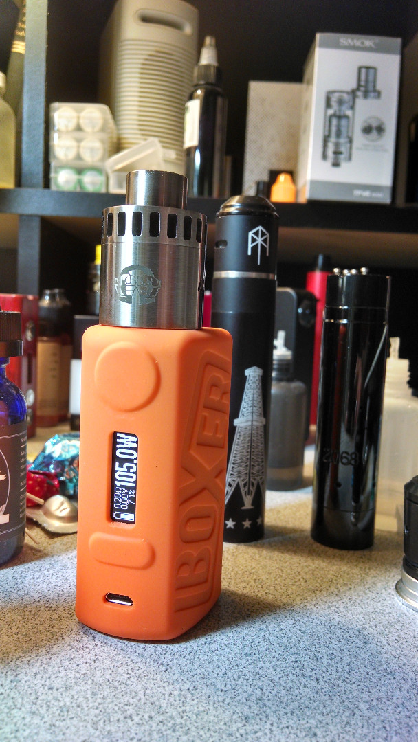

dwcraig1 Posted February 14, 2017 Report Share Posted February 14, 2017 My money would be on the battery contacts...just saying. Link to comment Share on other sites More sharing options...
Evo1340 Posted February 14, 2017 Author Report Share Posted February 14, 2017 ChunkyButt200 said: there should be some message that flashes across the screen, unless you have your error flashes set 0 or 1 times. my guess is your hitting your "cell soft cutoff" limit. if you know you are using the correct cells (cells that have an amp rating capable of providing the power you're asking from them) and still getting a reduction in power, i would email Boxer and describe your problem. you have some bad wire soldering. Boxer would be the people who would fix that for you. it should still be under warranty, right?im curious, what kind of cells are you using? Expand I got this a few days ago in a trade. Supposed to be almost brand new. New batts fresh out of box are Samsung 25r's. Never used them before but are comparable to LG HE4's. Boxer would not have warranty left I doubt but I can check. Link to comment Share on other sites More sharing options...
Spector NS5 RD Posted February 14, 2017 Report Share Posted February 14, 2017 maybe that's why the person wanted to trade it. this could have been a preexisting problem. the old "not my problem anymore" type of thing. like dwcraig1 mentioned, are the cell contacts dirty or weak (not pushing hard enough against the ends of the cells themselves will introduce resistance into the battery circuit)? misaligned cell contacts will also reduce cell connectivity. make sure they're clean, firm against the cells and flat against the cell ends (the contacts aren't sitting crooked against the cell). Link to comment Share on other sites More sharing options...
Evo1340 Posted February 14, 2017 Author Report Share Posted February 14, 2017 Oh yah, I'll take another look here shortly. Good idea. Didn't seem like anything unusual when I looked before but I'll check it out more closely. Link to comment Share on other sites More sharing options...
Evo1340 Posted February 14, 2017 Author Report Share Posted February 14, 2017 ChunkyButt200 said: maybe that's why the person wanted to trade it. this could have been a preexisting problem. the old "not my problem anymore" type of thing. like dwcraig1 mentioned, are the cell contacts dirty or weak (not pushing hard enough against the ends of the cells themselves will introduce resistance into the battery circuit)? misaligned cell contacts will also reduce cell connectivity. make sure they're clean, firm against the cells and flat against the cell ends (the contacts aren't sitting crooked against the cell). Expand Well as of this typing I'm at 88% charge left and it's performing better than it has since I brought it home a few nights ago. I noticed the contacts were not out enough as to apply good pressure to the cells so I corrected that on all four and checked all the soldering points and wires and wire bends where they are tight and so on. So far it stays where I set it watts wise while firing at the 88% charge point. We'll see what happens but I can already tell it's doing better than it did. Thanks guys. Maybe this is all it needed. I'll find out as the batts drain further. Link to comment Share on other sites More sharing options...
