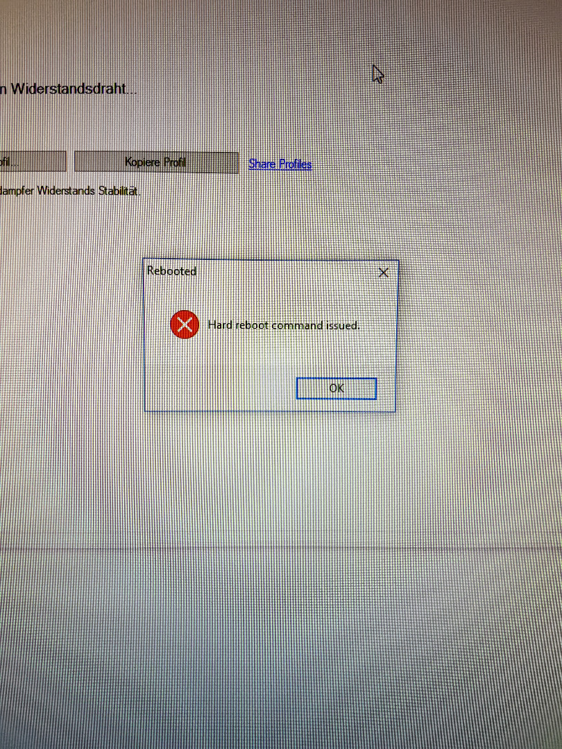

Hi
i have the same problem... any what i do... i become the message "Hard/Soft Reboot command issued...
i reset the Box with all settings... reinstall EScribe... load the new SP again...
all other settings works... but all TC mode's have a "bug"??? i set the Temp to 220C° (i'm German) but... i Fire an the Box change from 220C° to OFF...
i need to cry :((((
can anyone help me?
