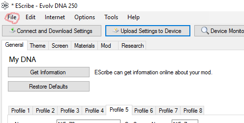

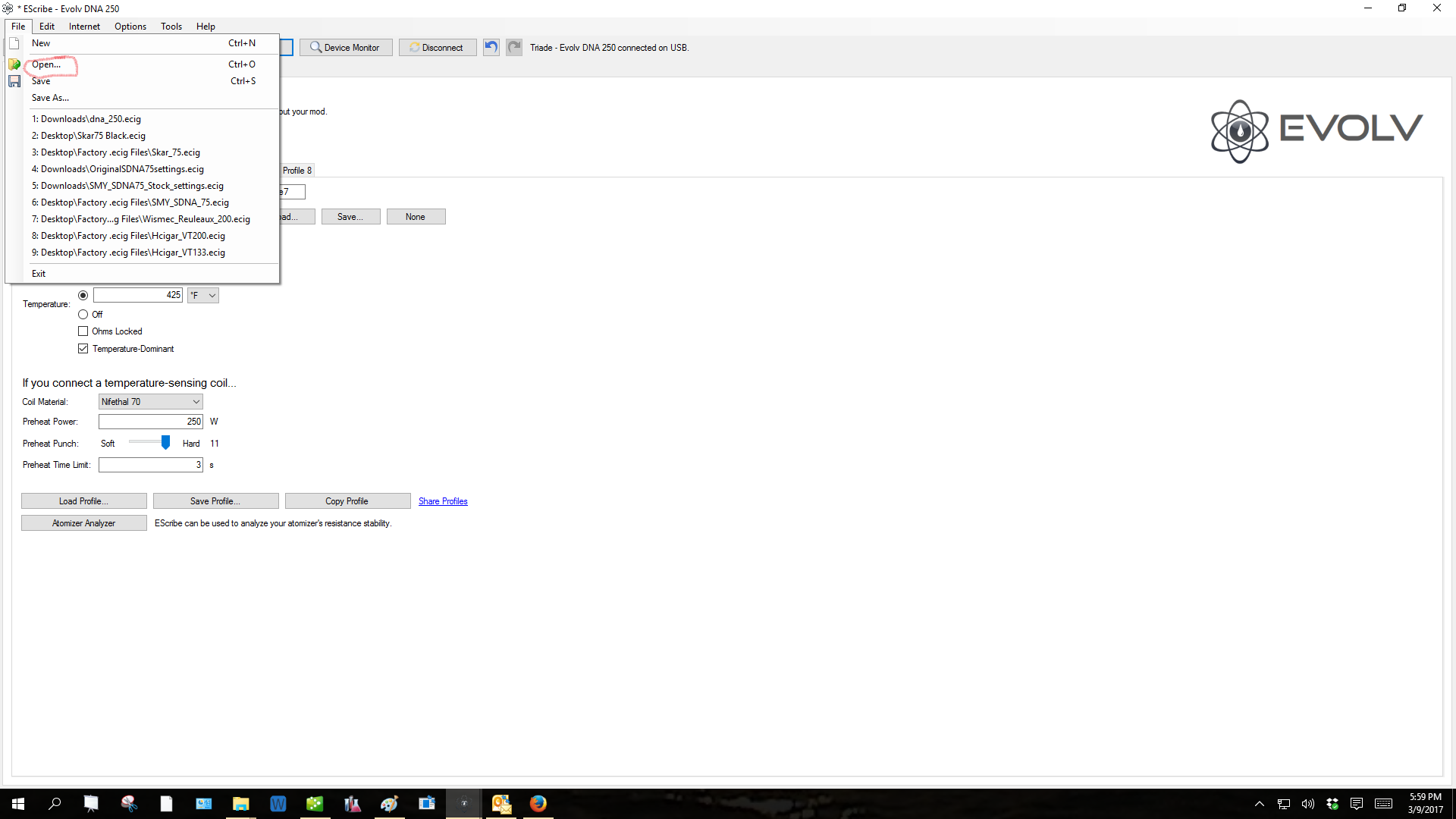

ut problem is i set for example 230 or 260 c it wont go higher then 190 then i connect to escribe click restore button hope it go on factory setting then i probably f*** up everithing no second welcome screen first is evolv dna76 then vt inbox no more that second could someone send my plesa ....and tem control doest work  how it should.... does enyone have some link or could send me softweare to upload on mod to work properly please some kind full setup for dna75 or for wire ss316 it is so frustraiting iam not computer guy i dont know how to use all that but so much issues with dna and so more money given for it or someone have knowlage about that and have some will to help me and guide me tru what i must to click we could her over phone over wats upp viber messanger how ever just is there any who can help my i couldnt find enything usefull online my mail is ggunikatni@gmail.com and phone is +385916215075 it will be easyer for bouth and me to describe my issue and you to help me and guide me what to click please if is there any one who is willing to help i am desperate

i do how you sed all i set temperature set preheat set watts i see it have welcome  message inbox weee up?ouid to device now lets seeee
