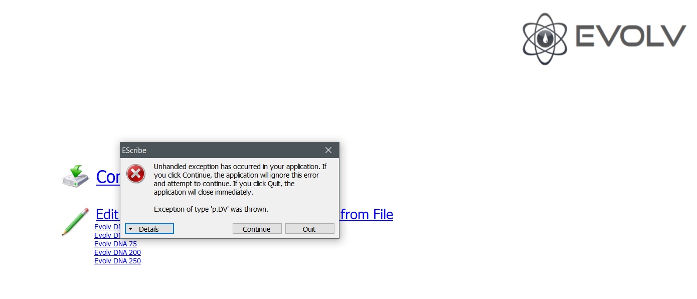

Warwolf_1 Posted March 17, 2017 Author Report Posted March 17, 2017 That didn't work. I tried almost everything possible. I tried to open another DNA250 SP. It starts applying it but at about 20% of the install, it disconnects. My Therion 133 is working perfectly fine.Edit: Applying a service pack will result in 'The device did not respond' error. I have no idea what to try anymore.Edit 2: While applying the service pack, Escribe decided to crash. Some "unhandled exception" error popped up.
