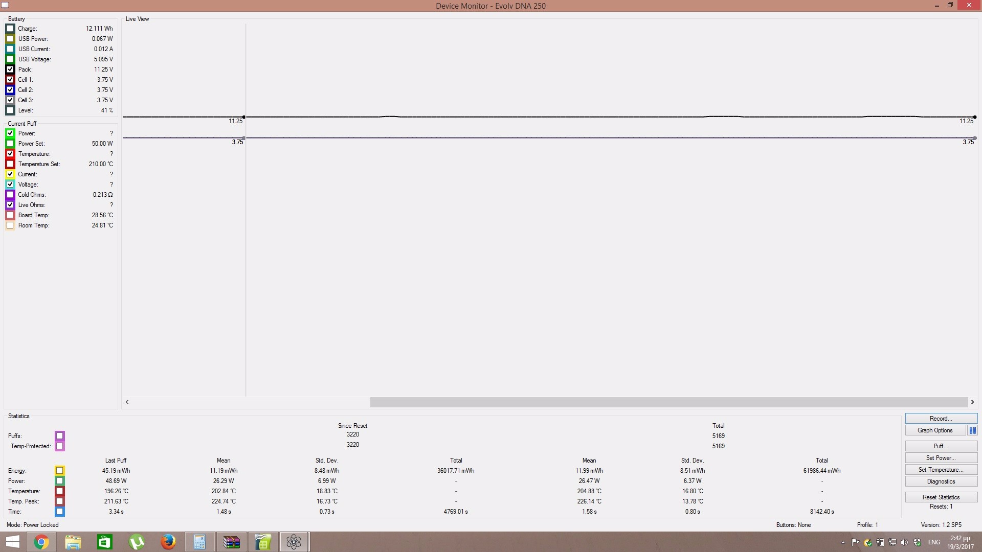

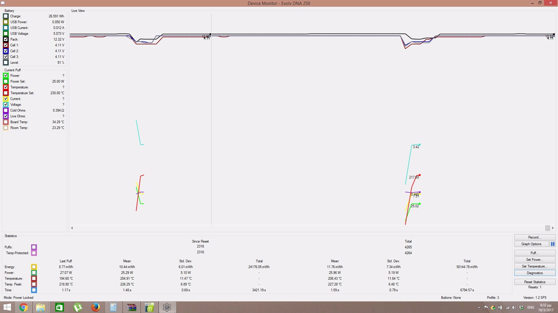

Wayneo said:
Off Topic:
Did ya'll notice the default mod thermal settings also? Are the mfgr's really this lax and not doing this, or is it new users happy with a hard reboot? o.O (I notice there were no resets of the data in his screen shots)
Of my 8 mods, I think only 1 came with the case thermals set at other than the default...Triade....

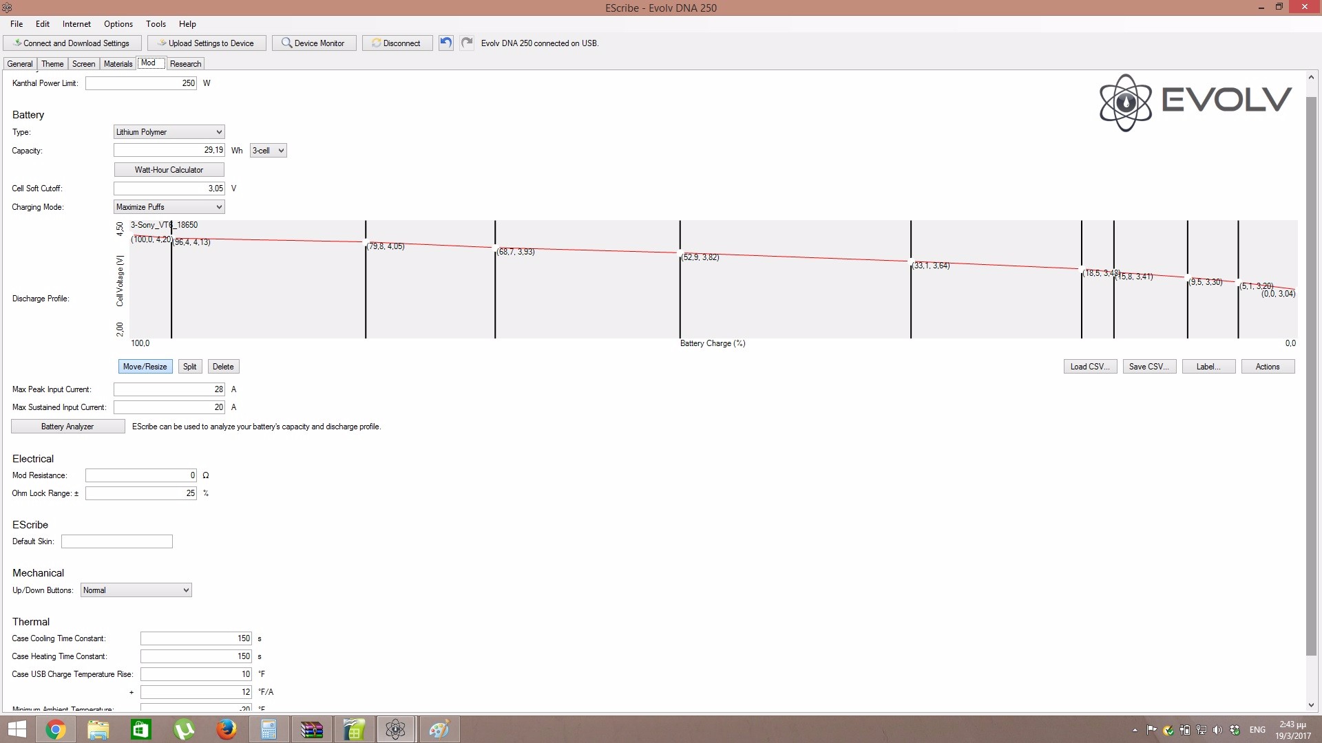

Oiko said:
I have tried different cables and wall adapter 5v/2.1a.
It charged through usb for half day the first day I bought it. Then it stopped.
I bought it 3 days ago. Should I request a replace?
You may want to try this...in Escribe, go to Device Monitor>Diagnostics>Reset USB Current Limit...if the USB has been inadvertently disabled, this will re-enable it...can't hurt to try...:D
