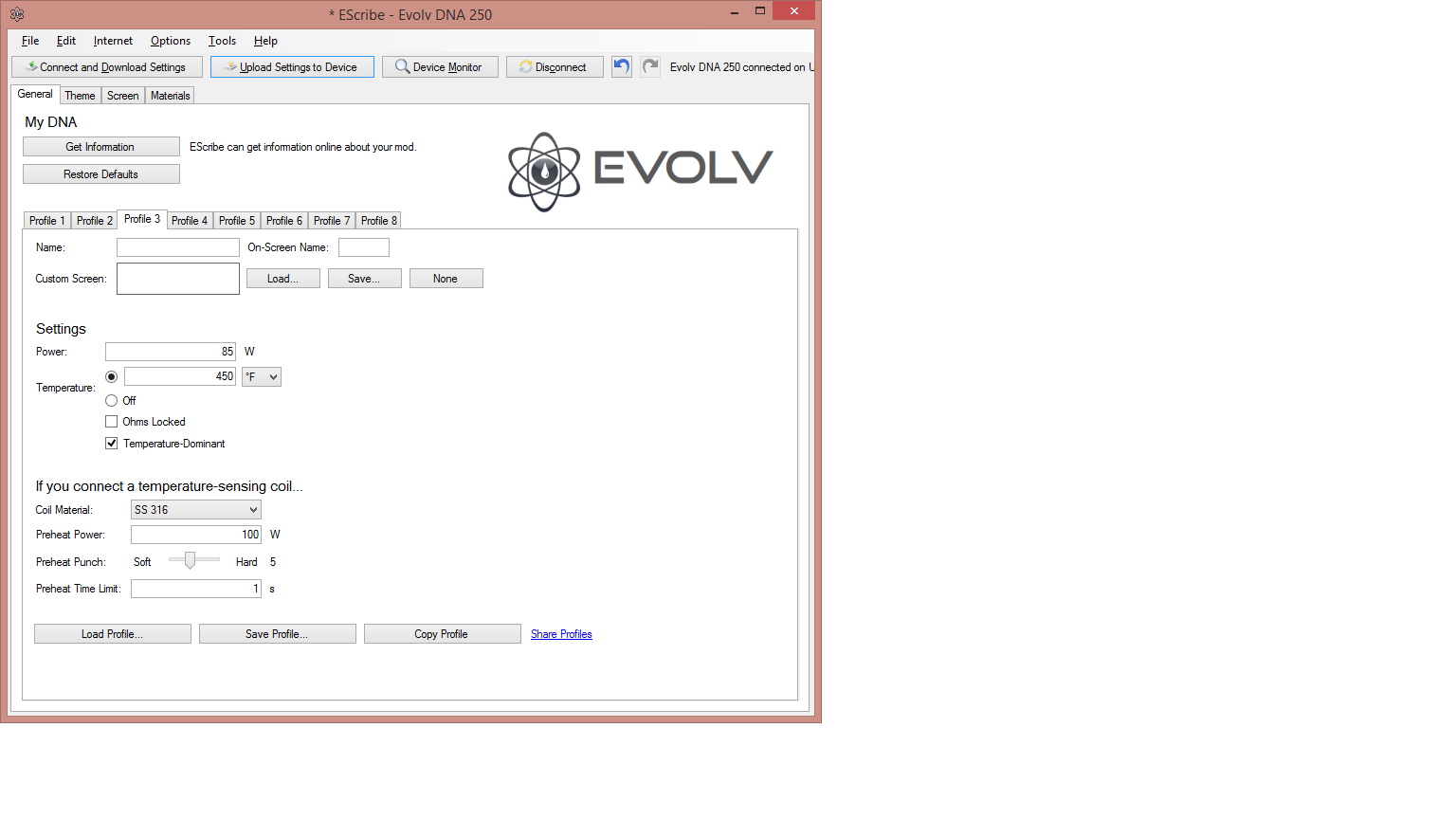

SinCo_Sam Posted March 10, 2017 Author Report Posted March 10, 2017 giz_60 here is a shot of my SS 316 profile, I would be happy to take a shot of the device monitor screen but what are some of the boxes that I need to check? Wayneo I did make sure that my connections are tight retird I wasn't aware that the coils need to be spaced... I removed the cotton and spaced the coils and it fired in temp control, I rewicked and juiced and spaced them again and again it is the same issue where it displays OFF. I am stumpedEDITED now as I try to fire this device I get the temp protected screen...
giz_60 Posted March 10, 2017 Report Posted March 10, 2017 Raise the power setting in your profile...you are limiting the board to only 20 watts...kinda like a governor on an engine...on Device manager...tick off..Power, Power Set, Temperature, Temperature Set, Cold & Live Ohms...

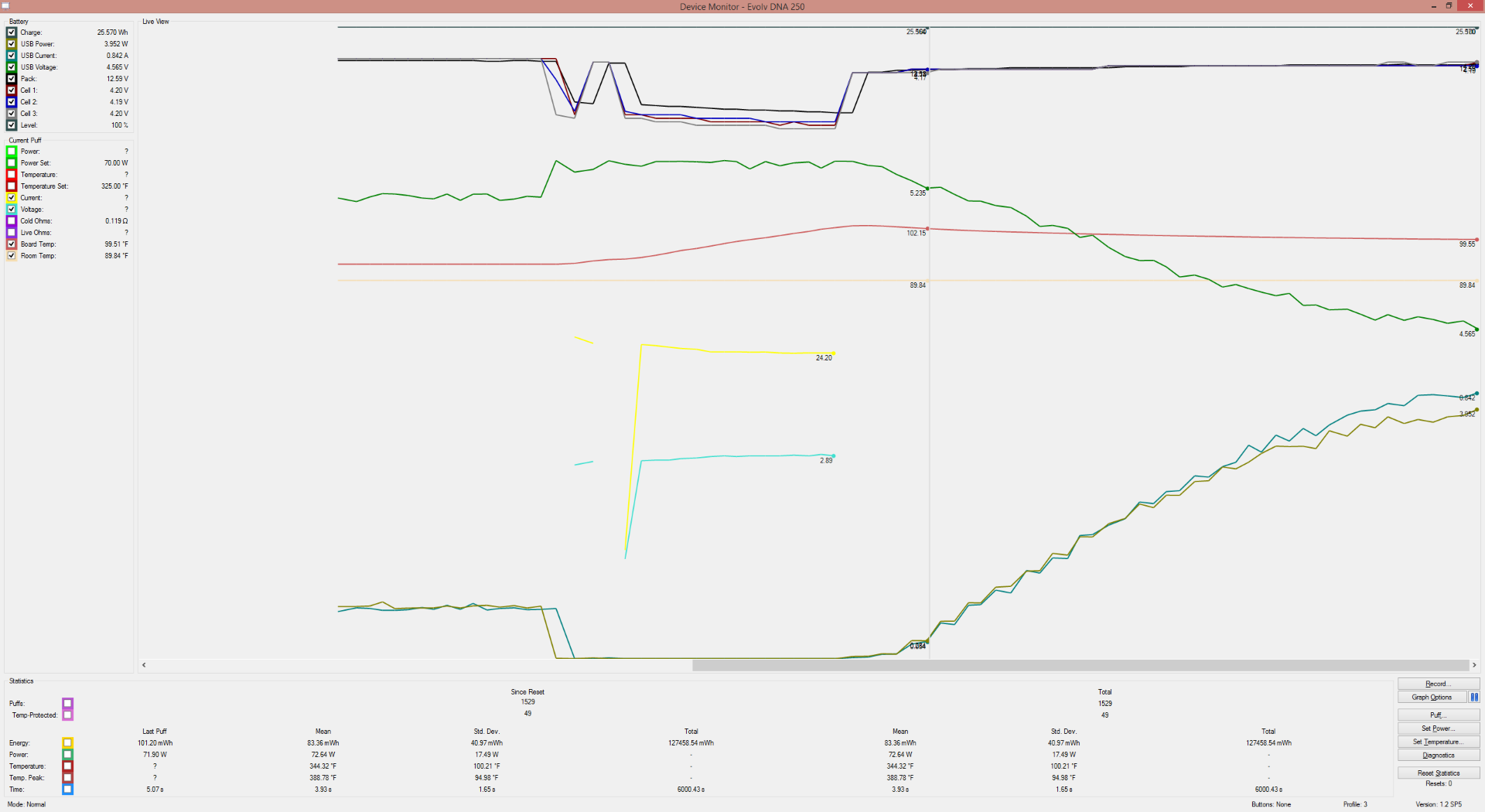

giz_60 Posted March 10, 2017 Report Posted March 10, 2017 Only tick the boxes referred to...turn others off & fire it again

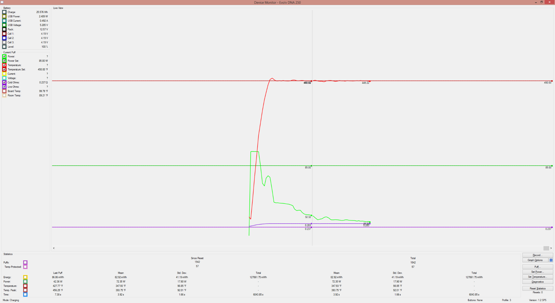

SinCo_Sam Posted March 10, 2017 Author Report Posted March 10, 2017 Ok first let me thank you for your help for your help giz_60. I changed my settings in escribe to reflect your suggestions, It seemed to have worked! I have attached images of both the new settings and the device manager. My question now is where the heck did I go wrong???
giz_60 Posted March 10, 2017 Report Posted March 10, 2017 Awesome......that looks really good...I believe you had the power in your profile set to low, which was not allowing the board to raise the temp of the wire fast enough, so the board thinks it is non-temp wire & switches to power mode. On my Triade, I have the power set at 250...preheat at 250...punch at 11 for 3 secs...bring the coil up to temp fast & let the board do it's job...in the 'Mod' tab, you set your kanthal power limit lower in case it does shift to power mode, then it won't cook yer lips.. The beauty of these devices is, you can play & adjust to find what works best for you.
