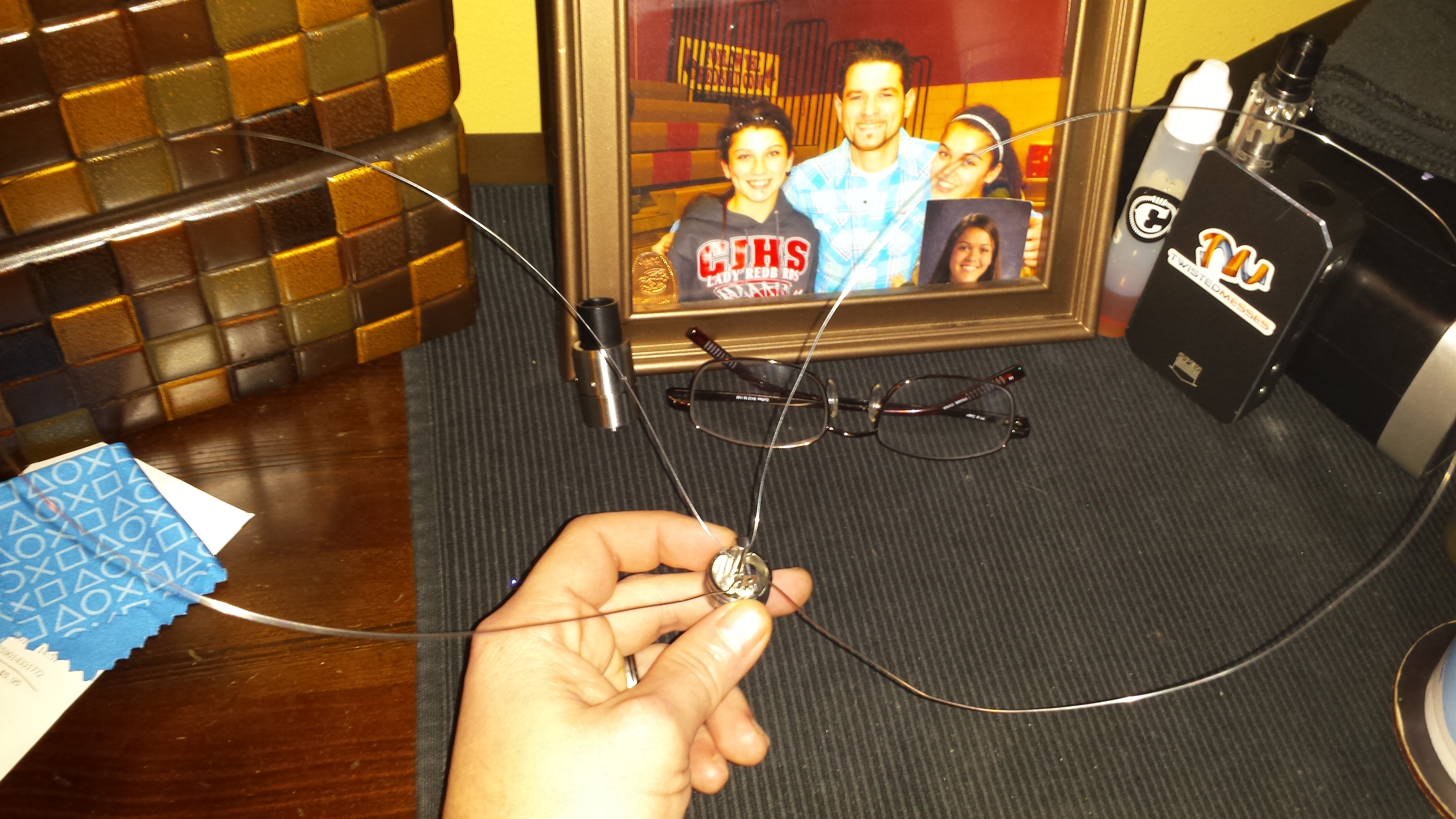

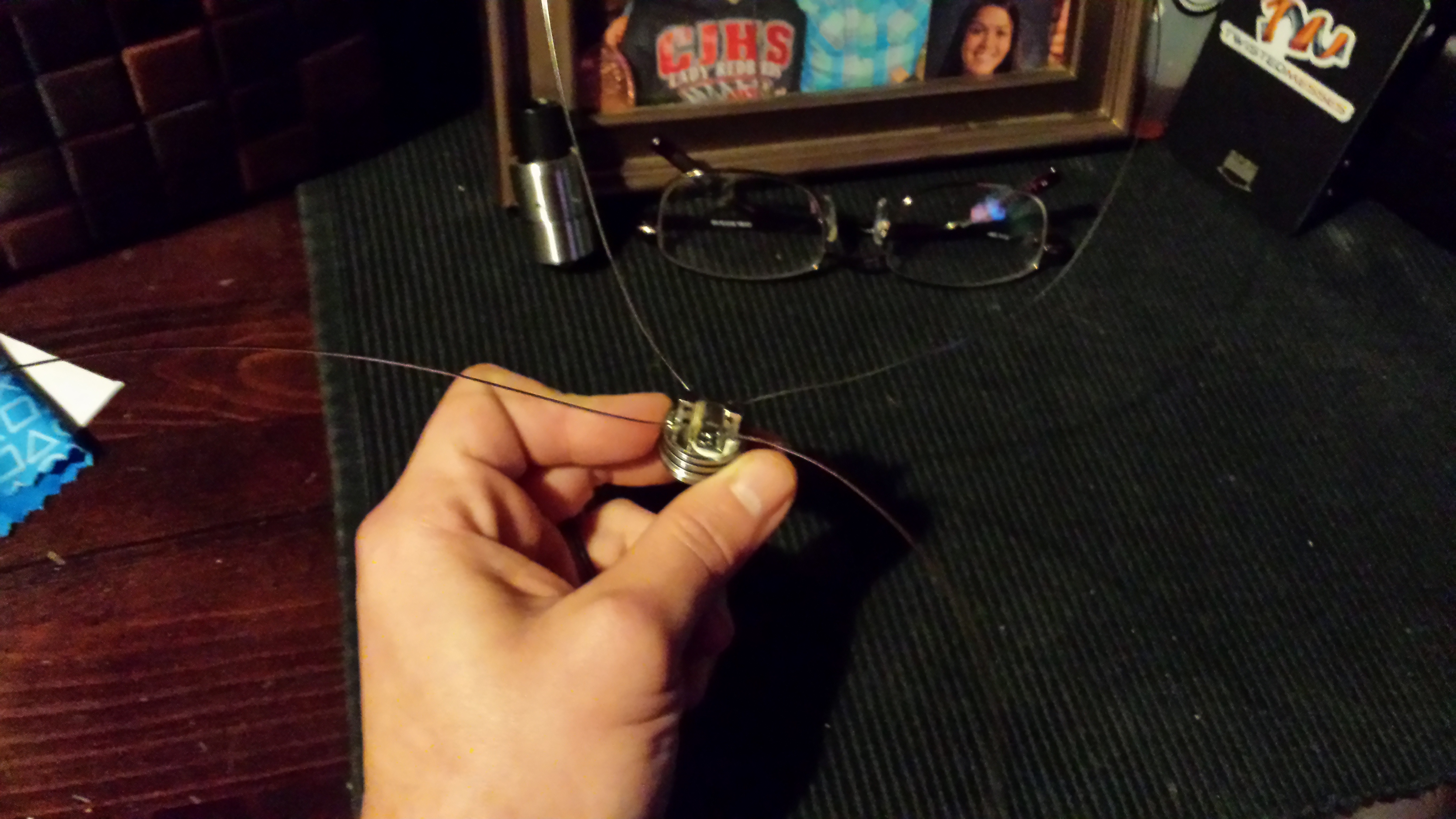

Make 2 big loops in the rda.......One on each side and sticking out far away from the deck. Run battery analyser at 40 or 50 watts until yest is done and that will give you your battery curve and correct watt hours For mod resistance u use a piece of copper jammed in the 510 or put the biggest fattest piece of solid copper wire in the posts of and rda to short it and run atomiser analyser .....u then use 80% of whatever the raw ohms say (multiply the raw ohms by 80% in calculator to get the correct reading and put that into mod resistance box and upload settings)
Link to comment
Share on other sites
No problem buddy. Just make sure when you do the battery analyser that u use 22 or 24 gauge wire.Cut two 1 foot pieces of wire and put one end of one wire in positive post and put the other end in the negative post.Repeat with the other wire on the opposite side of the deck so it's basically dual loops

Is there any way you can upload a quick pic of the wire loops?

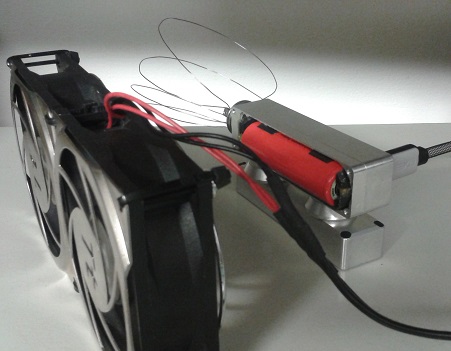

It depends on the power level, but with a 75 I get away with 4 parallel loops of 0.5 mm about the radius of a tennis ball, they don't get too hot the heat sinking back into the case is more an issue and I use an old computer fan that keeps the case & battery cool but it is not essential.  This is what I used to do custom battery test, I just use a single 3" fan now.
