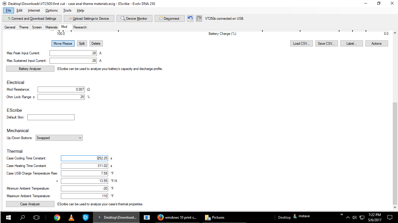

dywersant Posted May 16, 2017 Report Posted May 16, 2017 Thanks, this will come in handy in a week or two. How did you measure 510 resistance ?

mstave Posted May 23, 2017 Author Report Posted May 23, 2017 Measured the internal resistance using a copper dowel, with a milled 510 connection. Set internal resistance to 0 in Escribe, invoke the atomizer analyzer, screw in copper plug until read resistance settles - that is the internal resistance. Haven't used the mod in 3 cell mode at all yet

Wayneo Posted June 27, 2017 Report Posted June 27, 2017 @mstave With all due respect, I have found a copper tool is no longer an accurate tool for the 2xx series measurement ever since the Feb 2016 updates. With mine from smokefreemods.com, after Feb 2016, it would go to ~.006 then a ?. At the latest firmware, I'm also getting around the same (0.006 or 0.007) but no longer a '?'. I did retest my boards with the method below and get the same results as I already had before (0.002-0.006) while AA worked. Starting around here -> giz_60 alternative mod resistance calculation (March 10 post) 1
mstave Posted June 27, 2017 Author Report Posted June 27, 2017 (edited) Never had any issues with the copper milled plug. Looking at the thread you posted, I am doubting any mod with a DNA board having an internal resistance over 0.14ohms. Edited June 27, 2017 by mstave clarity
Wayneo Posted June 27, 2017 Report Posted June 27, 2017 I guess that must've been the wrong link, only showing the wire. In another thread it's mentioned to subtract the cold ohm value (.142) from the raw ohm value (.145), leaving a .003 which matches the copper plug. Sorry 'bout that.
Canadianvape Posted June 29, 2017 Report Posted June 29, 2017 On 6/27/2017 at 8:20 PM, Wayneo said: I guess that must've been the wrong link, only showing the wire. In another thread it's mentioned to subtract the cold ohm value (.142) from the raw ohm value (.145), leaving a .003 which matches the copper plug. Sorry 'bout that. Expand So 0.007 or 0.003?
Canadianvape Posted June 29, 2017 Report Posted June 29, 2017 (edited) On 6/29/2017 at 12:42 PM, Wayneo said: Read my prior post. Expand Thanks, had to re read it as some of the technical content was being a bit hazy. I'm gonna go with 0.0032, unless anyone can provide the actual 4th point Edited June 29, 2017 by Canadianvape Previous comments started to click
