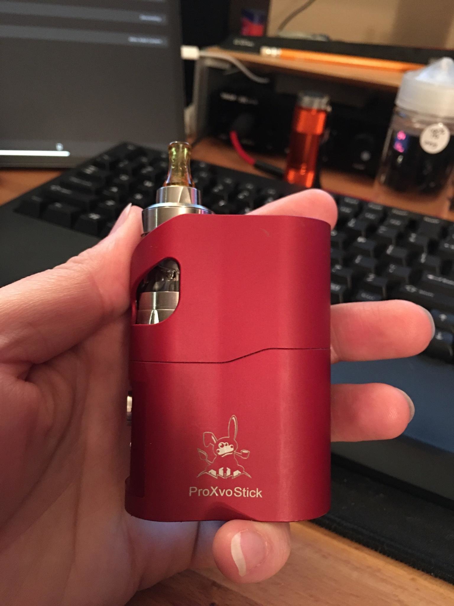

    The base theme is RNG 1.0.0 By vipyvapy I added Welcome screens for the Psyclone SqEvo, with Pixel art Hadalys

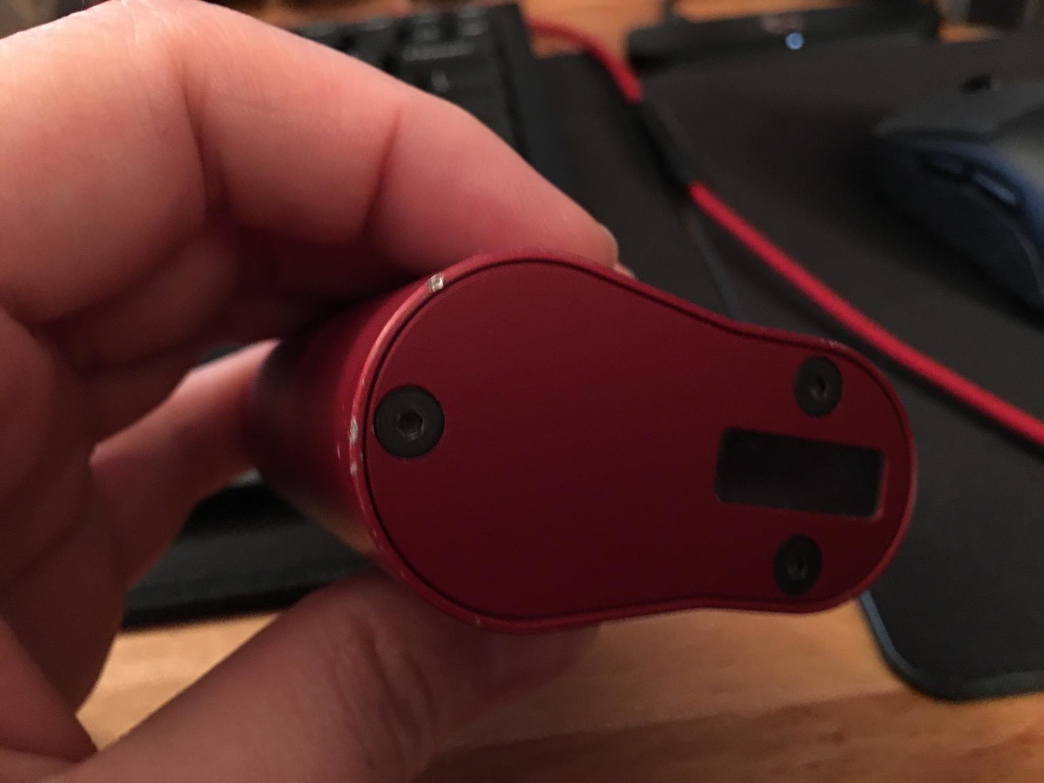

  6. The one that I DD took a tumble off my lap when I got out of the car on to pavement, IIRC. I'm honestly surprised it wasn't worse.

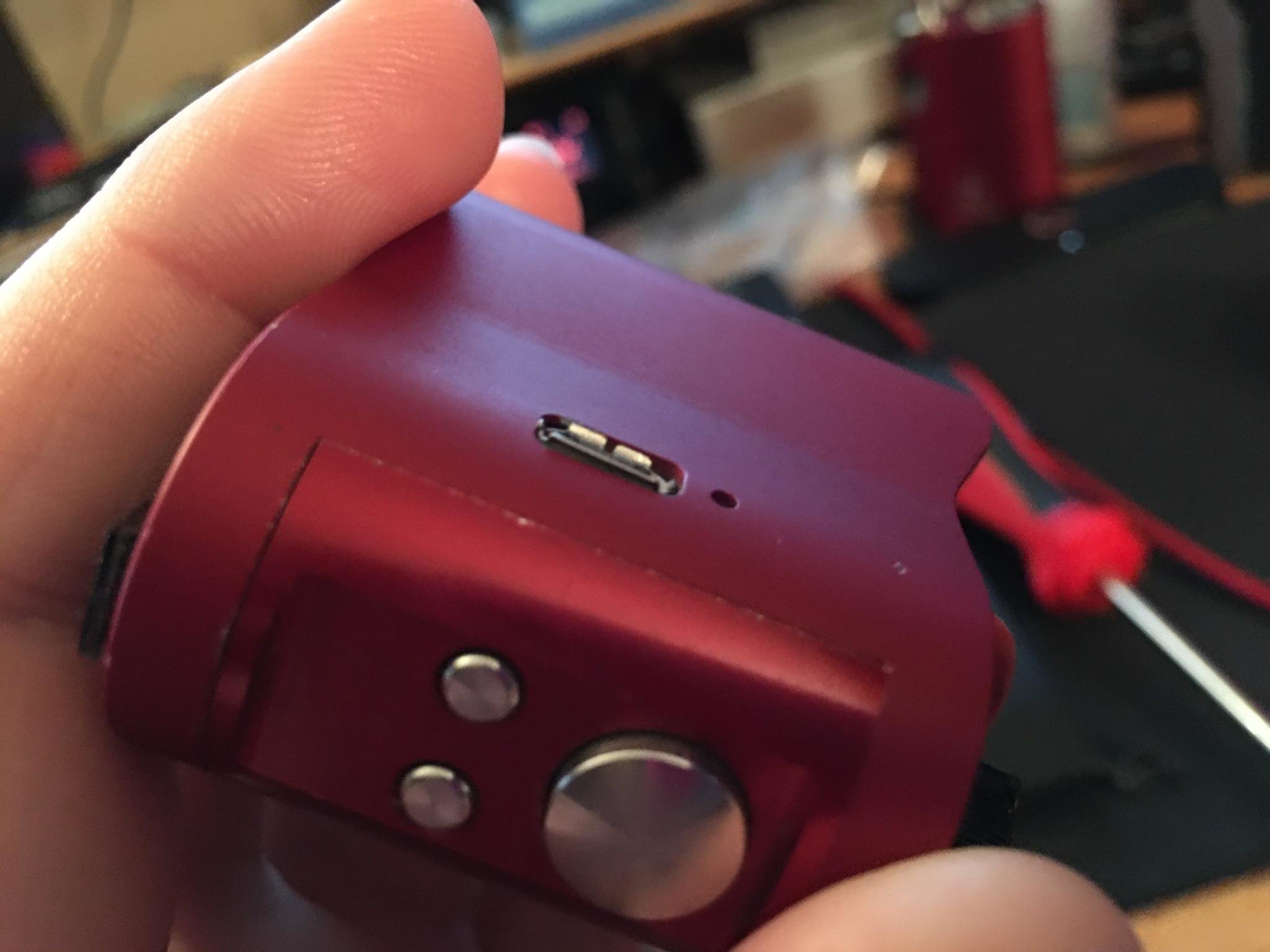

  7. I had to remove the bottom mounting standoff that the old board screwed into. So the new charging board is only attached with one screw, but it is held in place by the micro USB port. so it doesn't go any where. Old pictures, but they show the screw stand of that is still there. I'd try to get a better picture, but every time remove the button housing, it's like flipping a coin. I had to resoled those little wires a couple times, and repair some traces on the button PCB, due to pads lifting. I wish the PCB was the same quality as the coating on the mod housing. Sadly, it is on the cheaper end of PCB's, that I have dealt with. Also, the cable that they used for the stock button wiring, was a PITA, It was very plasticky and it was a ribbon cable, so I replaced it with wires scavenged form a USB cable, that matched it's gauge. Micro USB protrudes a little bit, but IIRC, it's about the same as the stock one did. I also had to modify the button housing, to add extra room for the spring loaded 510, since it sat down a little bit lower. Also, thank you for the pics that show voltage drop with a good and a bad cell.

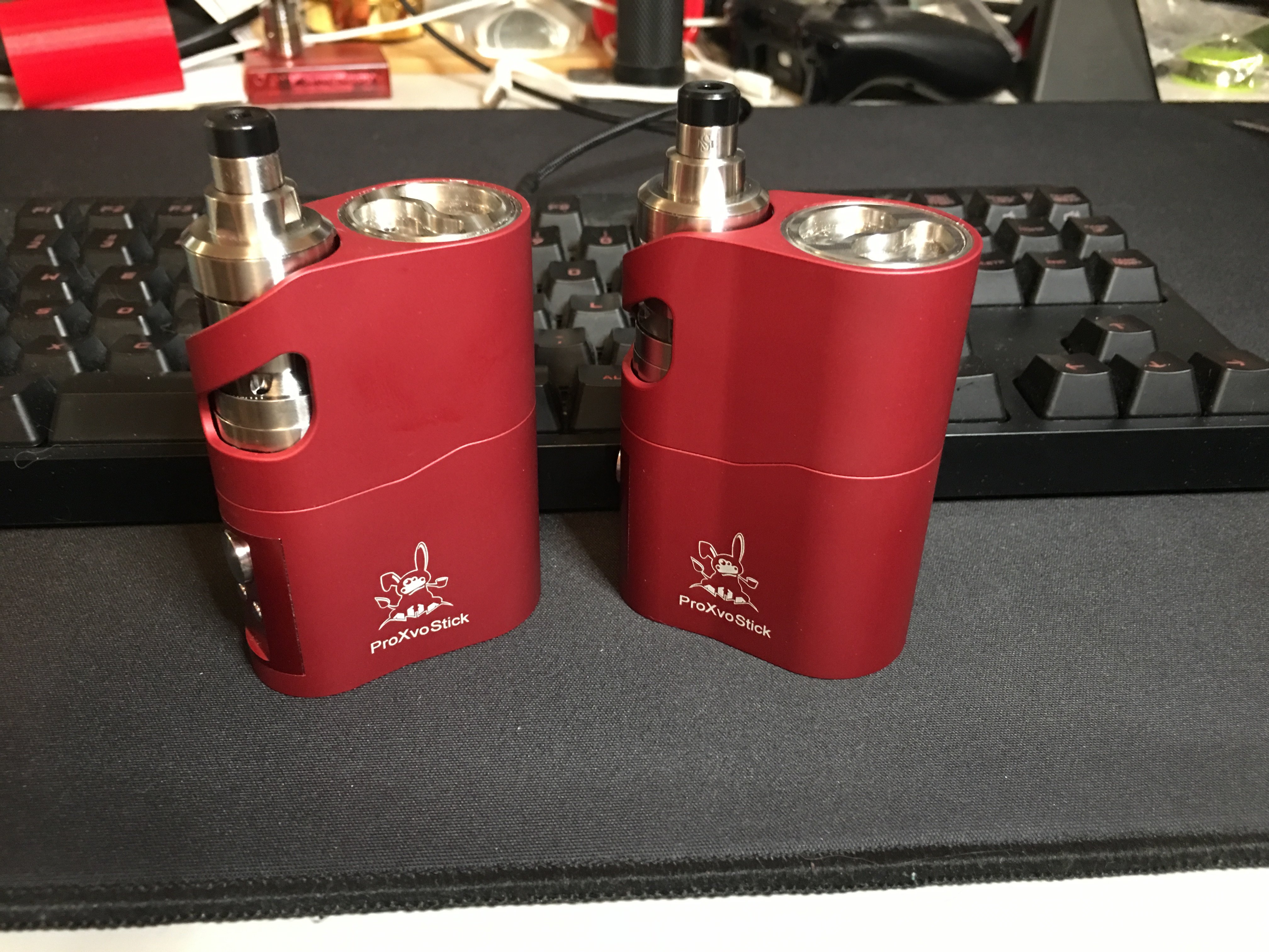

  8. Ouch, hopefully you get it. I got one form VapinArt in the US for $185, then found the second one of ebay for $75. lol Couple of new pics: The other one, tooks some fall damage, but it's still in pretty good shape, for being my DD, for about 2-3 years.

  12. The battery was fully charged, firing at 22 watts on a 1.6 ohm coil. I was getting about 0.8-1.0 of voltage drop, before cleaning the contact points. After cleaning: Imgur link, incase the uploaded photo breaks: https://i.imgur.com/5VQ9Udf.png When I re did the mod with the DNA 60 Board, I used all new wire following the specs in the evolve DNA 60 data sheet. The wire used, was the Ölflex Silicone wire sold by modmaker. That's about half of what I'm getting. What type of wire are you running for your coil. I'm using 3mm, 8 wrap, 28awg Kanthal A1 coil at 1.6 ohms. I've tried the same coil in both my Kayfun Prime and my Cthulhu 1928. Also, is your DNA 60, one of the new ones or did you convert one of the older DNA 40 models to a DNA 60?
