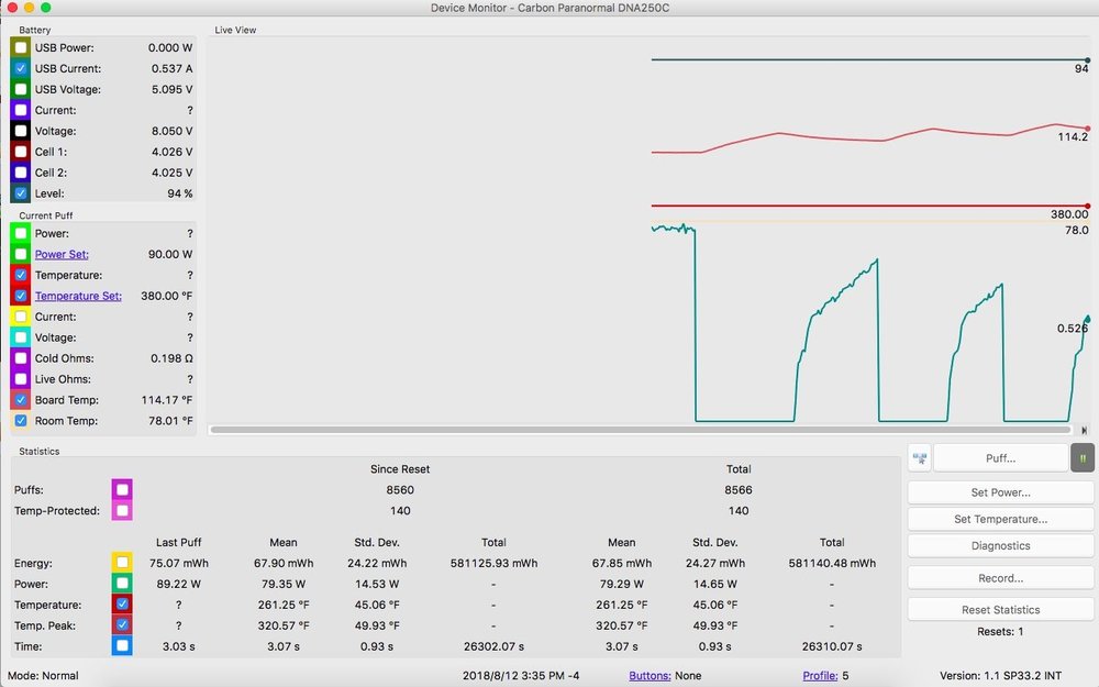

I'm getting No Temperature Reading on a Peranormal 250C. Tried restoring defaults. I'm using 316L with this file ~SS316L~.csv . Any thoughts? Here's Device Monitor showing 3 puffs

I finished my second HUGE build. But it doesn't show temperature in Device Manager when on 316L. You'll see in device manager I take a hit lowering temperature each time but getting the same hit and the wattage staying dead on the setting every time. What am I missing?
