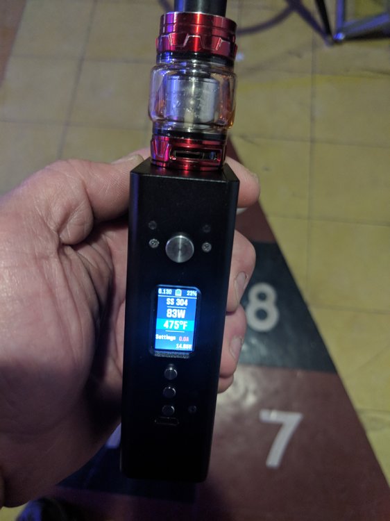

I have been using the Prince in TC for months. It should be compatible if TC capabilities is all it takes. I did get my csv from Steam Engine. I've been out of the house before so I have a pretty good understanding of stuff n things, I also come here first... I'll have to try the Prince now but it should work. My sales rep at SMOK is who told me it's SS. I DID tell her she needs to put it on the package instead of just 'SS' like it has now. Here's the thing. I found the fix on my own... Why wouldn't it be more obvious that MY FIX WAS A F'N CHECK MARK on the safety tab.... All the way at the bottom, the one word option (replay-allow on dubious cols) that gets lost after looking at a list of 3 or 4 word options and all the other options are about minimum and maximum power or watts. Seems kind of buried and out of place maybe. But you saw the coil I'm using and you seemed impressed even though all it is is 2 pieces of clapton twisted together. Check out my Instagram and you'll see at least a little more complicated. https://www.instagram.com/winstonbyrd/ But anyway. Replay isn't perfect for me now but it's way better or closer. I even got the TFV12 RBA w/ SS to give me the option to replay but I get 'temperature protected' on the first replay. I get the feeling that the resistance is drifting. It's a little more of a pain to work on than other RTAs but later I'll take it apart and see if maybe I have a screw that need to be tightened. The TFV12 RBA has always been finicky. I've ordered an iJoy combo squonk but looking for better if anyone has suggestions. Convenience of plenty of juice without a squonk bottle and all the flavor of the best RBA. That's what I want on the Paranormal 250C. As a further test I put on an approved Uwell Crown and it works as expected. Thanks again for all your help. I appreciate your contribution to the community !

Not really, just that 1 time. As soon as I change tanks and it's material in the rplay profile it doesn't work. The new tank is 304SS by SMOK. Works in regular TC profile.

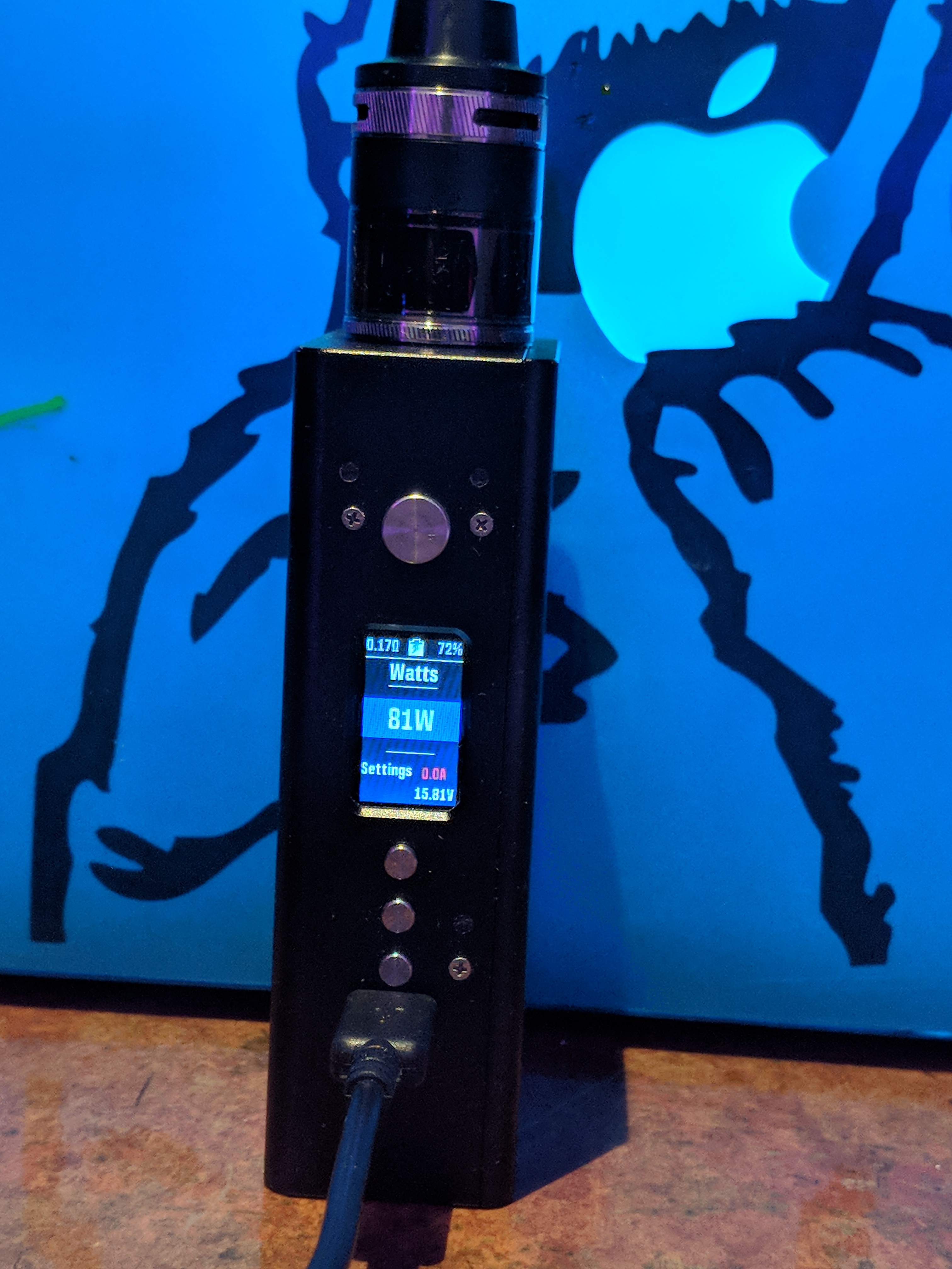

Maybe. I think so after 1 or 2 pulls is all but we'll see. It has crapped out on me before. When I went to the factory they handed me a test unit for me to put my RDA on. I vaped it until it was dry getting the same hit every time so I know what I should be getting. Now I need to get it to work on my RTA because all my RDAs have squonk pins. The RTA's get check attie warning, even in wattage. They were working earlier...

Actually, I just noticed it's getting NO power because I'm getting a, "Check Atomizer" warning when I try to "Play" the replay Fresh out of the box Paranormal DNA250C. Awful Fail!
So I had time to run battery analyzer and replay started to show up when I took the first vape after running it. But the replay was nothing. Like it was getting NO wattage at all. Nothing even though it says, 'playing' This is on the Paranormal 250C, fresh out of the box. I got 2 but was hoping to leave the second unopened but I'm tempted to see if I get the same crappy results . Have I mentioned, "Horrible FAIL" It should work 'out of the box' so grandma could work it... Without EScribe even!

My SMOK Sales Rep tells me the Prince coils are 304SS and they seem to work. But I keep haven't to remind myself not to go above 480 because they use cotton, not Rayon like I use to prevent burning. SS304: 0.00105 By the way Nick. This is the board with the bad negative output contact I need to return, please. The other board in not installed... RMA requested Thursday 4/19 if could check please... I know you folks are swamped so no worries, I know you'll get to it.
