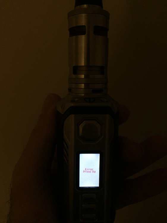

I encountered an error I woke up and went to vape (finder dna250c) and when I clicked fire it said error then a number (sorry I don't remember and I didn't take a picture) after clicking again the message disappeared, it has yet to show up again so I can take a picture, I don't know what triggered it or what it was. sp17. sorry I can't be of more help, but I did catch that white sceen with error, that had not showed up prior to the sp17. also I had to delete two screens from my themes to CHANGE a wire slot, I don't know how that happened.
