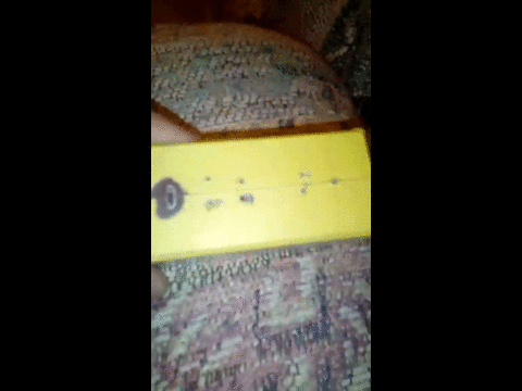

My guess is there was a sharp point on the solder and the battery wasn't anchored with a velcro strap or two sided tape so the point on the solder worked its way through the battery's shrink wrap. Something between the battery and circuit board and anchoring the battery would have made a difference I'd think. Just a guess. Edit: The Zippy line of batteries are not the highest of quality either but I call them as I see them.
Blame the battery?
