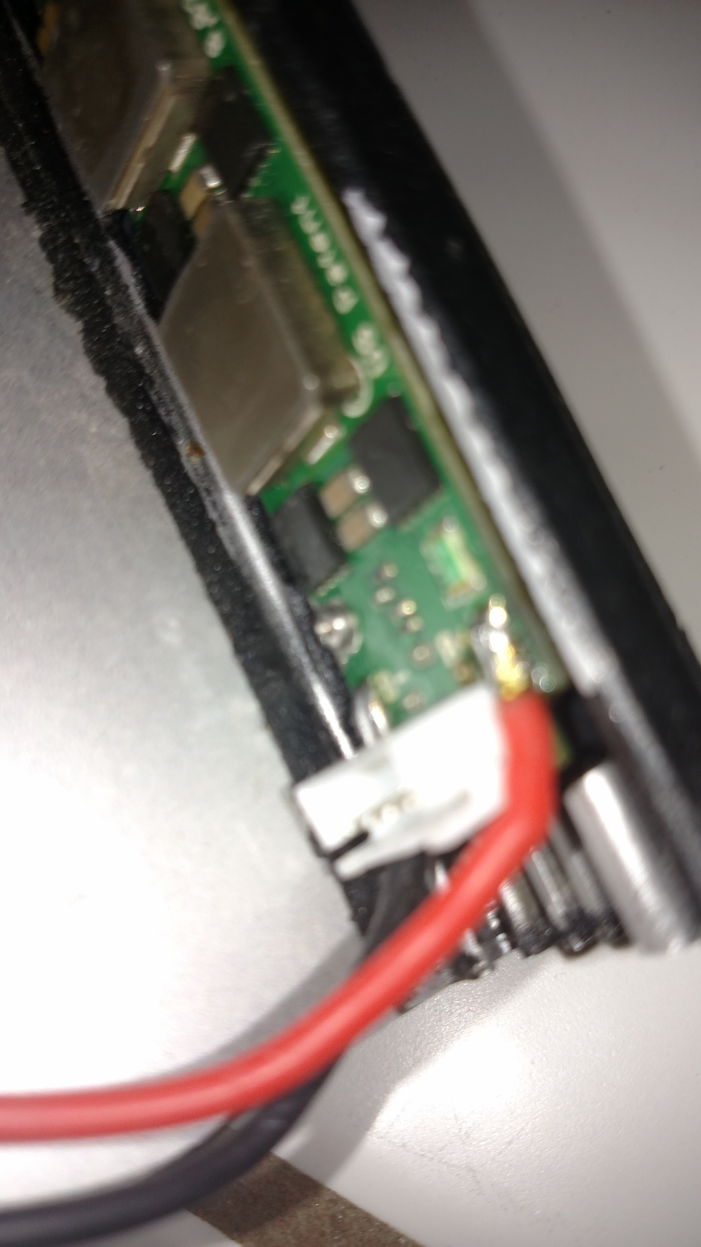

  15. Thanks. I forgot about the wire wizard on steam engine.

  20. Very strange. I'll let the electrical engineers respond to this, but it sounds like a battery problem, if not the fuse.

  24. No juice that i can see. I tried to take some photos but my phone wont focus. Ill check the insulation on the wires. I noticed when i plugged it into my lipo charger it had drained down to 2.03 from 2.11. Very strange because within 4 days cell 2 went from 2.8 to 0, which leads me to believe it is a bad battery. I made this mod so I cannot search for potential problems.
