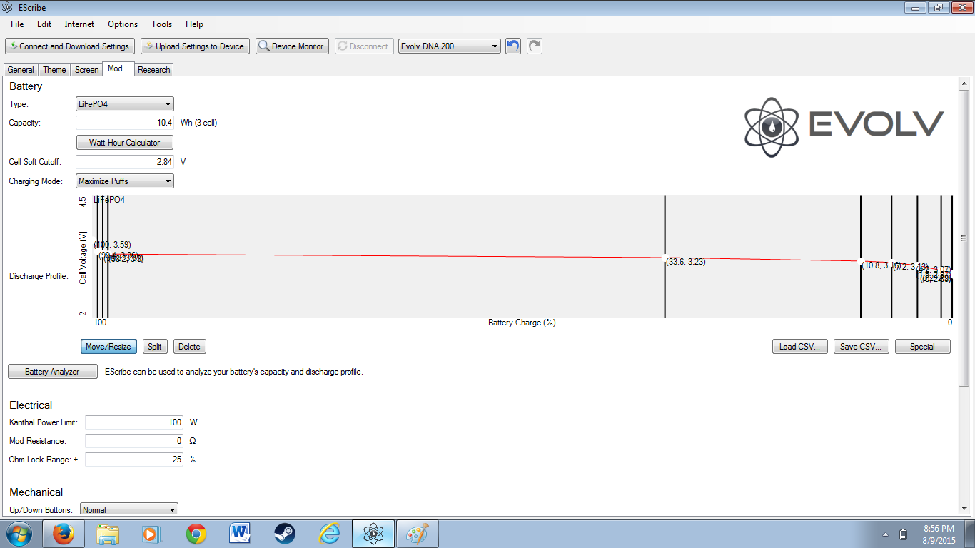

1050mah 3s 9.9v lifepo4, set at 10.4 Wh via calculator, it was set to the default 8Wh before and was working but recently this battery jump has been happening so i used the Wh calculator. Since i got it, about 3 weeks ago it was fine till 2 days ago. KTMrider all cells are evenly balanced in the device monitor.

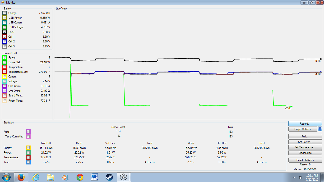

How do i do the curve? I figured out the charging screen settings was at 0%. The temp readings were perfect for room and mod and the battery % before when i first got it, must be a firmware change otherwise no idea.
I did the calculator Wh, still didnt help, just jumped from 70% to 26%. I also noticed i have the screen charging settings set different and they dont come up...
My chip started to act strangely by jumping from 92% to 65% and has been doing this behavior for the last few days. I just uploaded new firmware and software, and plugged in data for wh according to my battery spec. The balance is fine on batteries. Room temp and board temp seem way off too. Mabey I should try a hard reboot?
