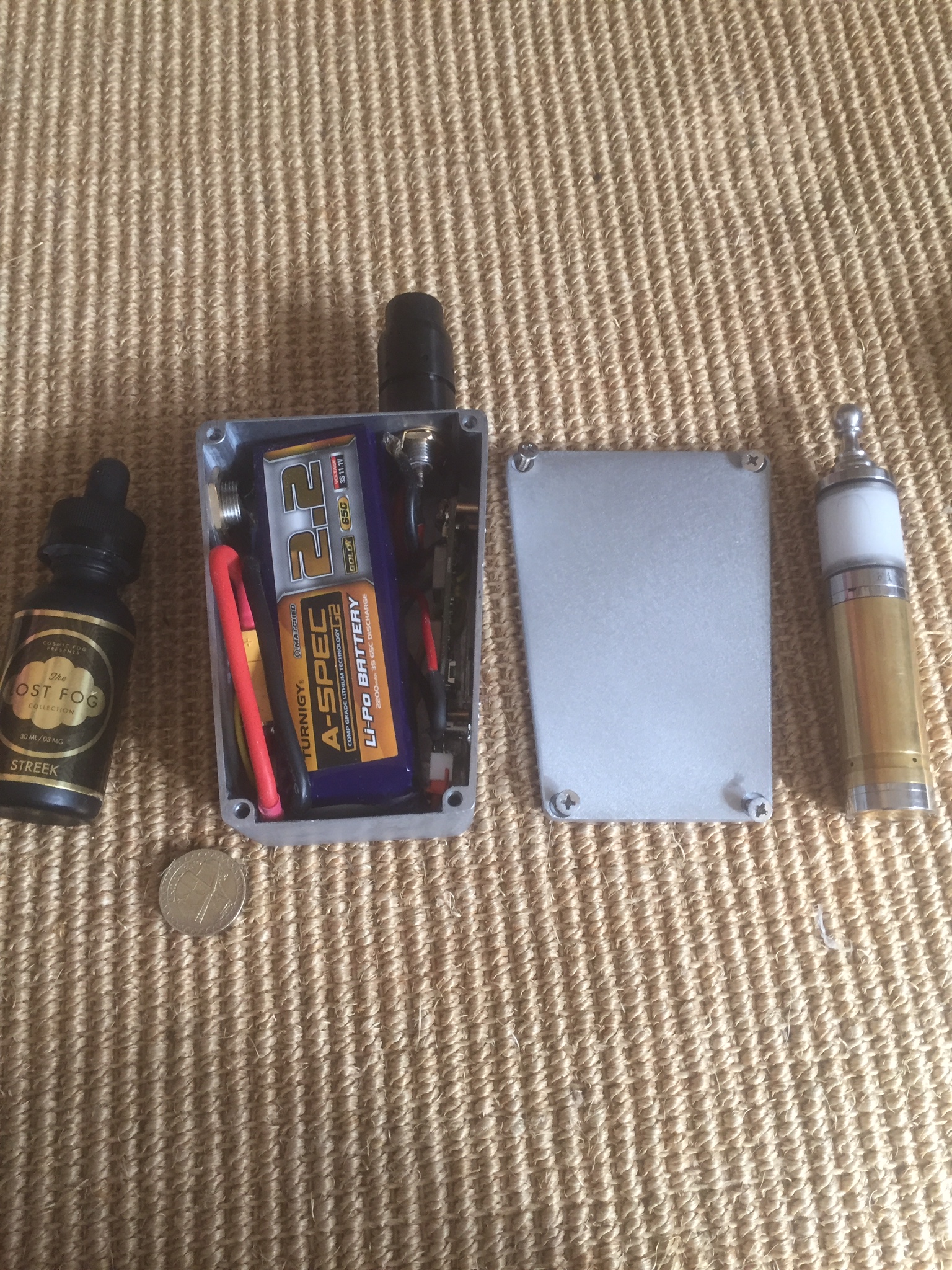

well accurate for my device, I had the same issue where i was getting weak battery at about 20% at 14.43, and at 11.09 when it hits 0% i can get 4 or 5 vapes out of it before i get the weak battery , so it works for me. the mod I have just made has a 2200mah turnigy nanotech A-spec in it and that should read 24.42 if it was 2200 mah but the battery analyser came out to 23.62, so 0.8 lower or 3.3%(I can live with that) . but it had only had a couple of charge cycles so i will give it another run through in a week to see if it has changed. the vt 200 worked out at 23% lower, ..... i am not so sure that is acceptable this works out to a 1000mah battery

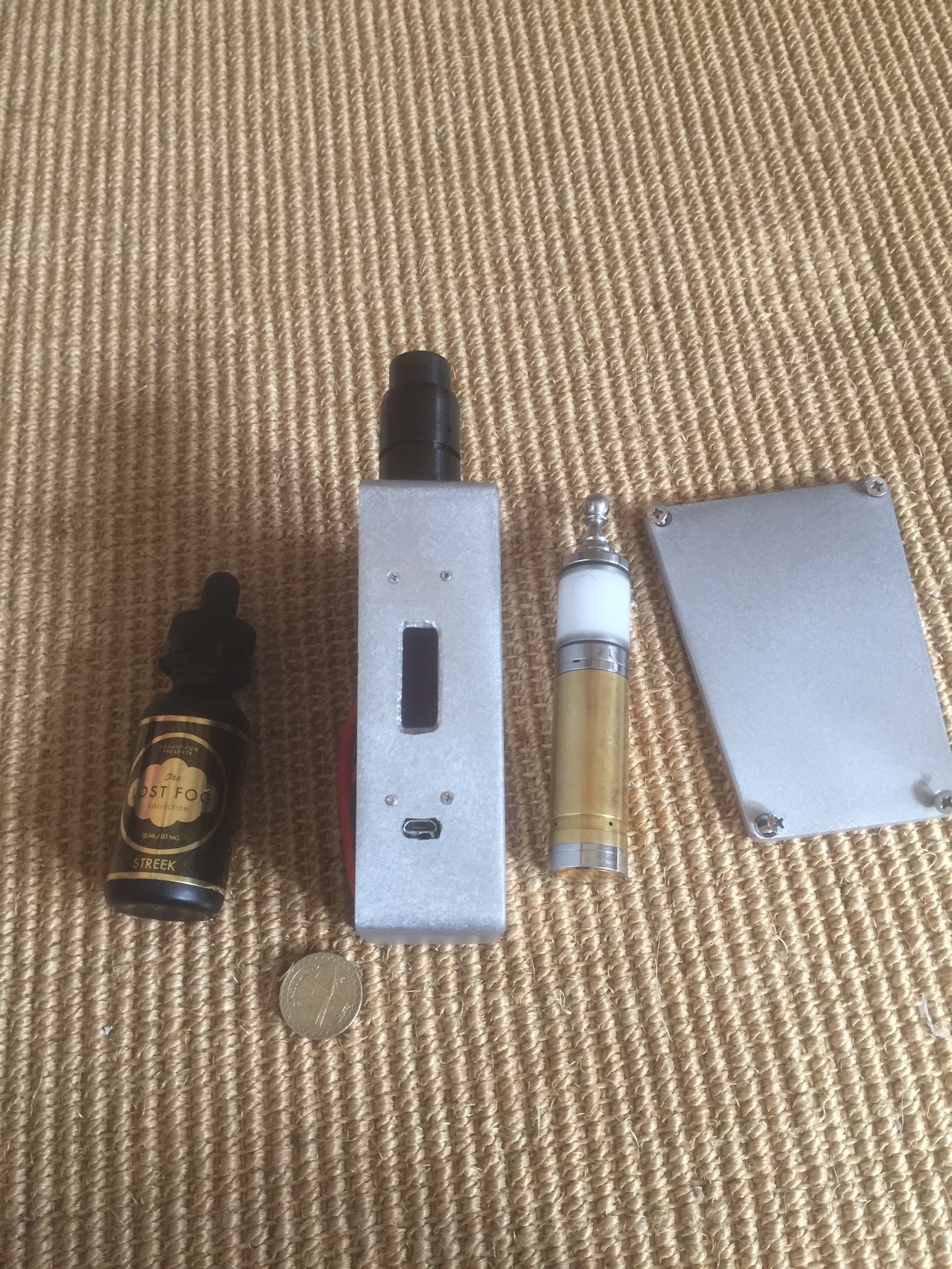

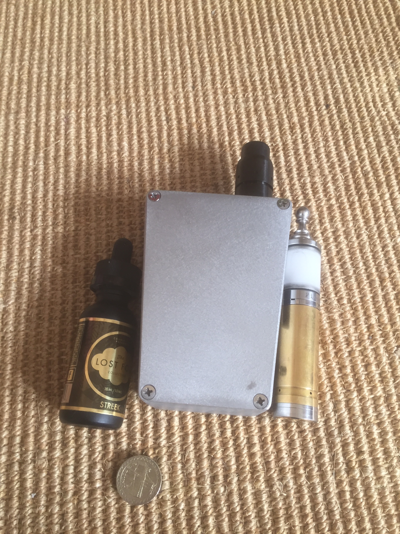

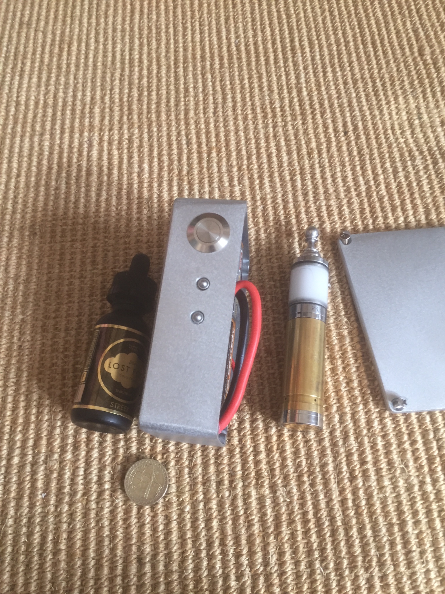

My first attempt at a mod! I have had three temp control mods, Evic vt ( kept jumping out of tc mode) Ipv4s good on titanium with 100 joules but 50 joules on nickel not enough) And finally cigar vt200. I was so impressed with the chip, but dissapointed with the battery life (about 8 hours) So I thought I would make one that I can use all day without running out of charge, and also one that can take a lot of abuse, (I am a builder, so it needs to be able to withstand some rough treatment and a fair share of knocks!) Battery analyser has returned 23.79 compared to 24.42 it should be for a 2200 mah battery so quite happy with that. At the end of my work day I still have 45% battery life and with some quite heavy vaping in the evening normally ends up with about 20% Not the prettiest, smallest or lightest .................. But nor am I

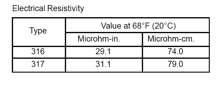

quote "mknight 8 hours ago Could it be that you need to use tcr for 316l? I noticed most ss out there is 316 or 316l. Getting killer performance with dual coil, 24g at 0.2 ohm. Setting tcr to 0.001" 317 and 316 should perform pretty much the same as each other, 317 is just a bit more corrosion resistant than 316 (which should mean safer possibly) I have downloaded the 317l csv from steam engine which should match the difference in resistivity between 316 and 317 The 'L' just means there is less carbon in the alloy which just means they are more resistant to intergranular corosion when used for welding......I trust we are not vaping at those temperatures!! for anyone thats interested here is the difference in resistivity:-

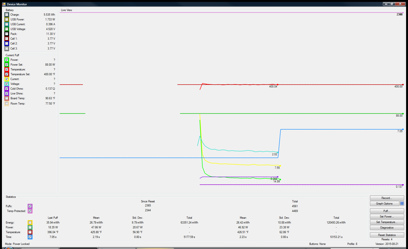

Hi, just wanted to share some screens from device monitor, and wonder if anyone can tell me what is going on here. with NI200 the selected temperature is hit and it remains there nice and steady, with titanium it gets to the temp and then fluctuates a little with 317L Stainless it gets to the temp then fluctuates quite wildly Now the vape on all three is very good so i have no complaints, in fact i prefer the taste of the SS out of all three, and it is a dream to work with. I am presuming the difference in the charts is because the temp coeficient chart gradients are a lot shallower on the SS therefore the resistance difference between two temperatures is a lot smaller than ni200 or titanium, which would also explain the slight variation on the TI coils. am i correct in thinking this ? Thanks in advance
