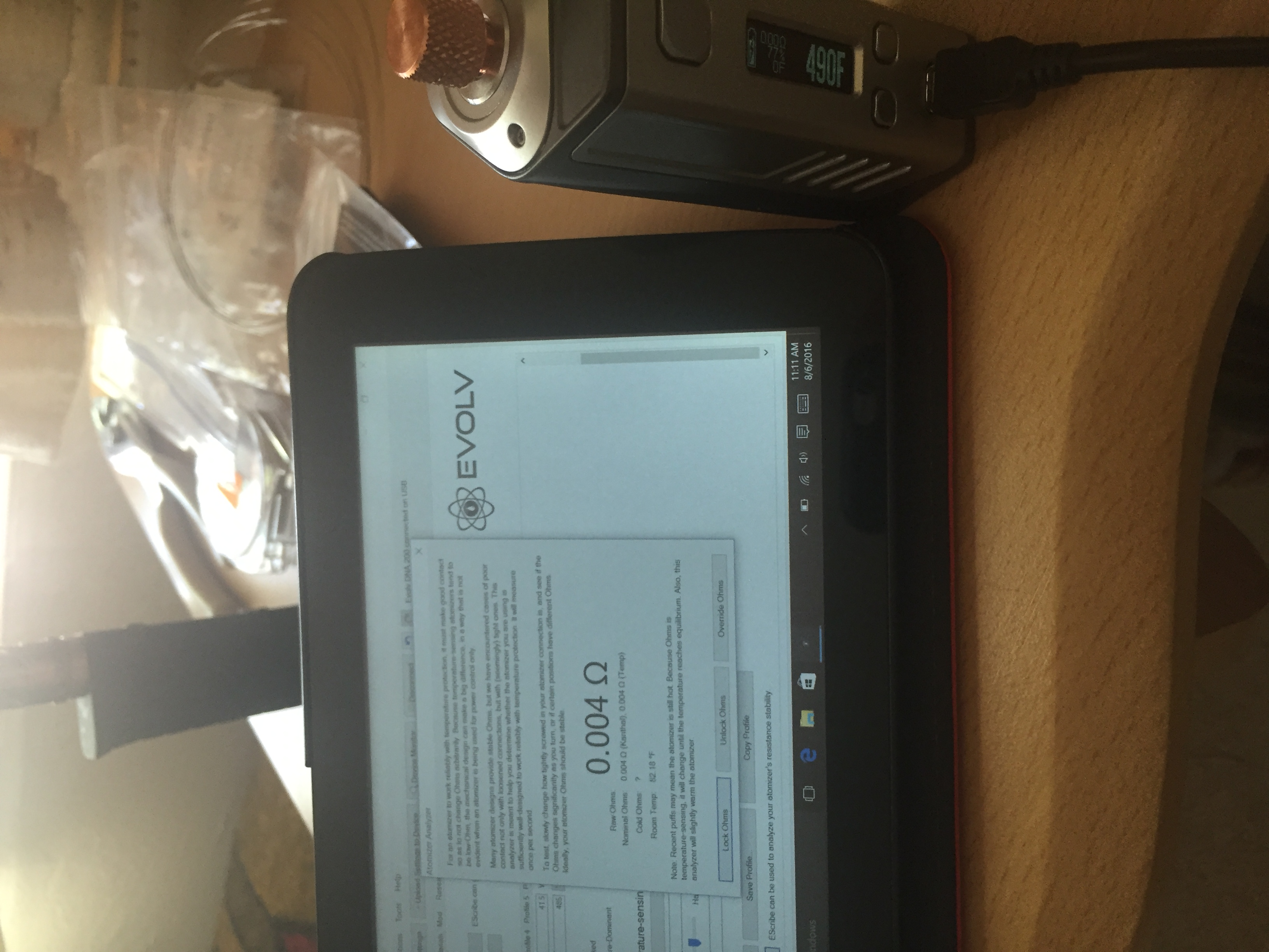

  1. I tightened until it bottomed out and just nice and snug until completely stable with no fluctuation the triade remained stable at 0.004 for the last two turns I guess a fair bit tighter than an atomizer

  4. LostVape Triad 0.004 tight set to zero and hard reboot

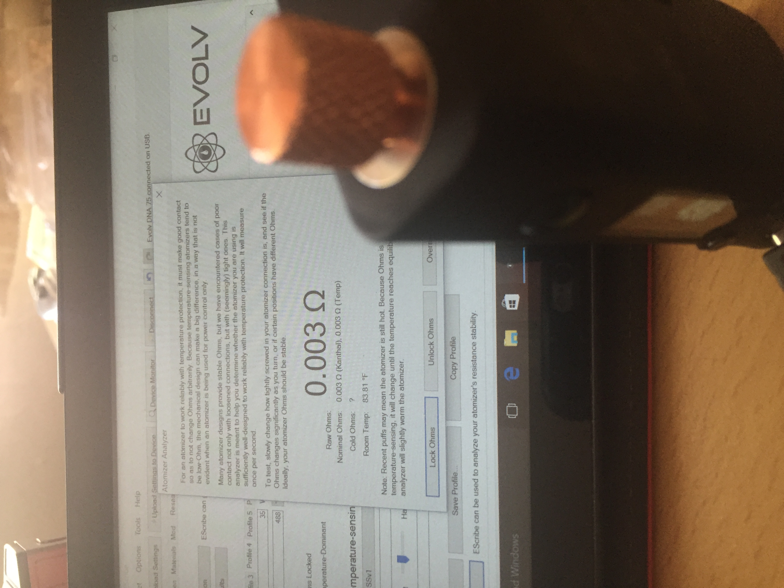

  5. Mod res set to zero clean 510 screwed on tight 0.002 steady as can be

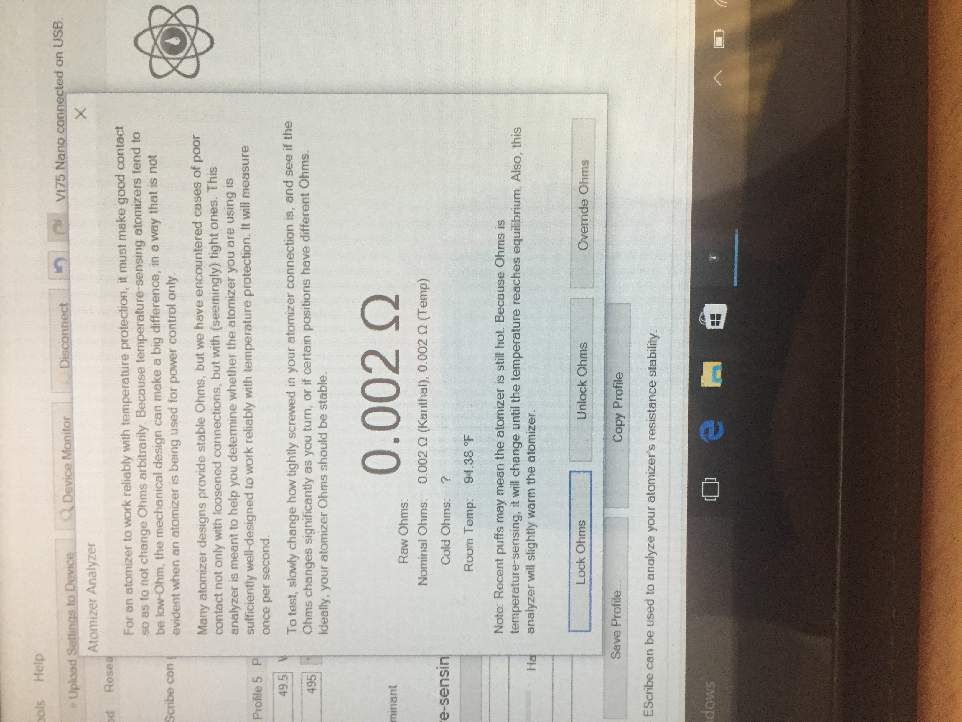

  19. Thanks for jarring my memory. I have been away from escribe awhile and forgot the tell tale signs of a wonky 510 pin. The smy75 runs it well since it's nice and stiff but I need a better spring on the lostvape.
  20. It fluctuates between 0.765-0.774 good call I never thought of that. My other device runs this clone very well, maybe because it has a stiff spring. I just screwed on my authentic and it reads within 1 rarely 2
