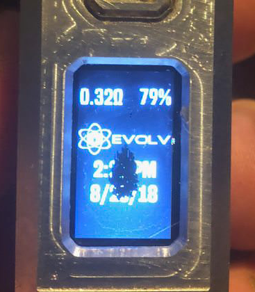

	Is anyone having as many colour screen issues as Me? I have had 3 colour screen failures in the last few months :( I had 2 screens get the White Screen of Death & now I have some spot that is growing, it will take over the whole screen in no time :( Kind of Disappointed :(

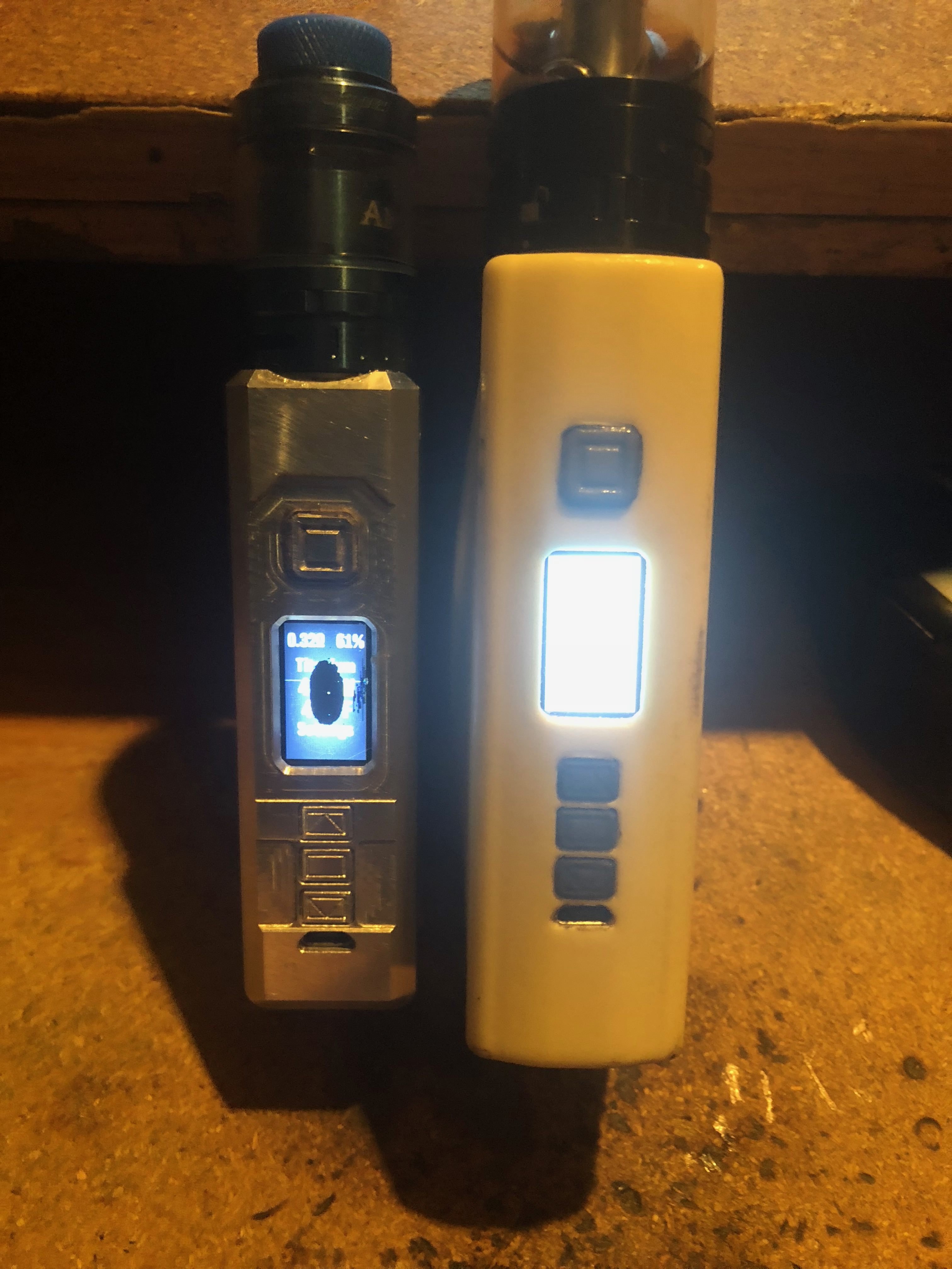

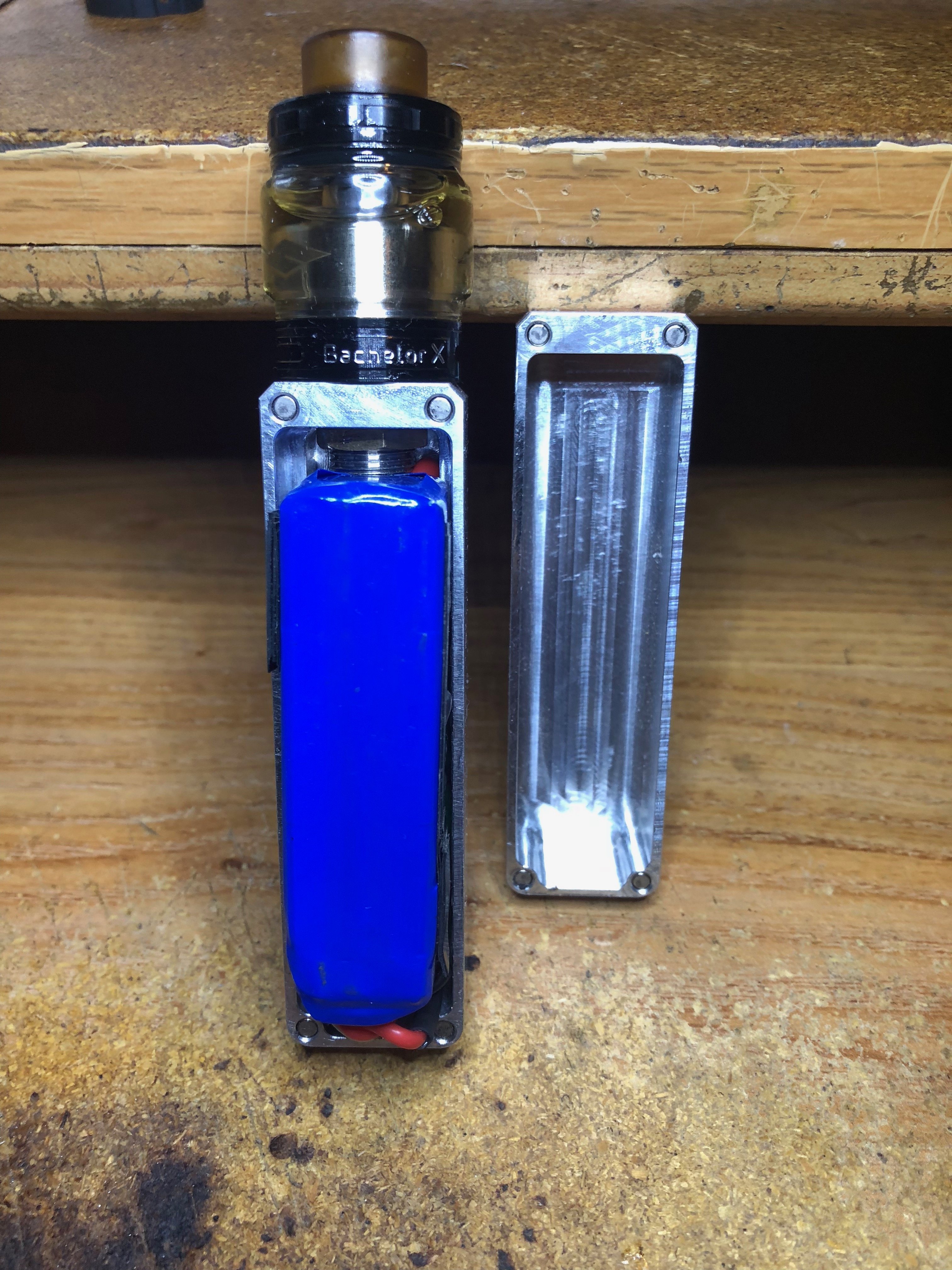

	For those of you's who may be looking to build a more pocket friendly sized, lipo powered 250c mod. This may be a solution for you I built this mod with a silo75c enclosure https://www.protovapor.com/product/silo-dna-75c-billet-aluminum-dna-mod-case/ a source 510 & a FullyMax 950mAH lipo. This enclosure was intended for a 75c! So with out some internal modification a 250c will NOT! fit. The main issue is the space for the chip, as the 250c is 2mm wider. The button fitment & usb fit perfectly, once you remove the extra material for the chip to fit in place. I used a dremel, & it was a lot of work! If some one has access to a milling machine it would be a piece of cake Also note, space management gave me a choice of a better quality 510 (source) or an xt30 connector. I choose the live battery connection & the better 510. If how ever you would choose a Varitube 510, there would be adequate room for an xt30 battery connector See size comparison to a Silo 950, older dna 250, but same size battery

	That makes it a bit worse Mine did exactly the same, on the bottom part of the screen. Good news is over 10 days later, My mod's new screen still working fine
	Yes, the mod has been working fine for several days now. It was the screen. When I opened the mod. I was expecting, some thing obvious? A bad kink in the lead? a juice soaked screen? a loose Zif? None of that Every thing looked perfect! I guess the screen just went out.

	So I opened it up, I tried a new screen & it works again I tried the old screen on another 250c & it's white there to. So I think the screen is the issue? Luckily I have some extra Colour screens coming with my latest order
