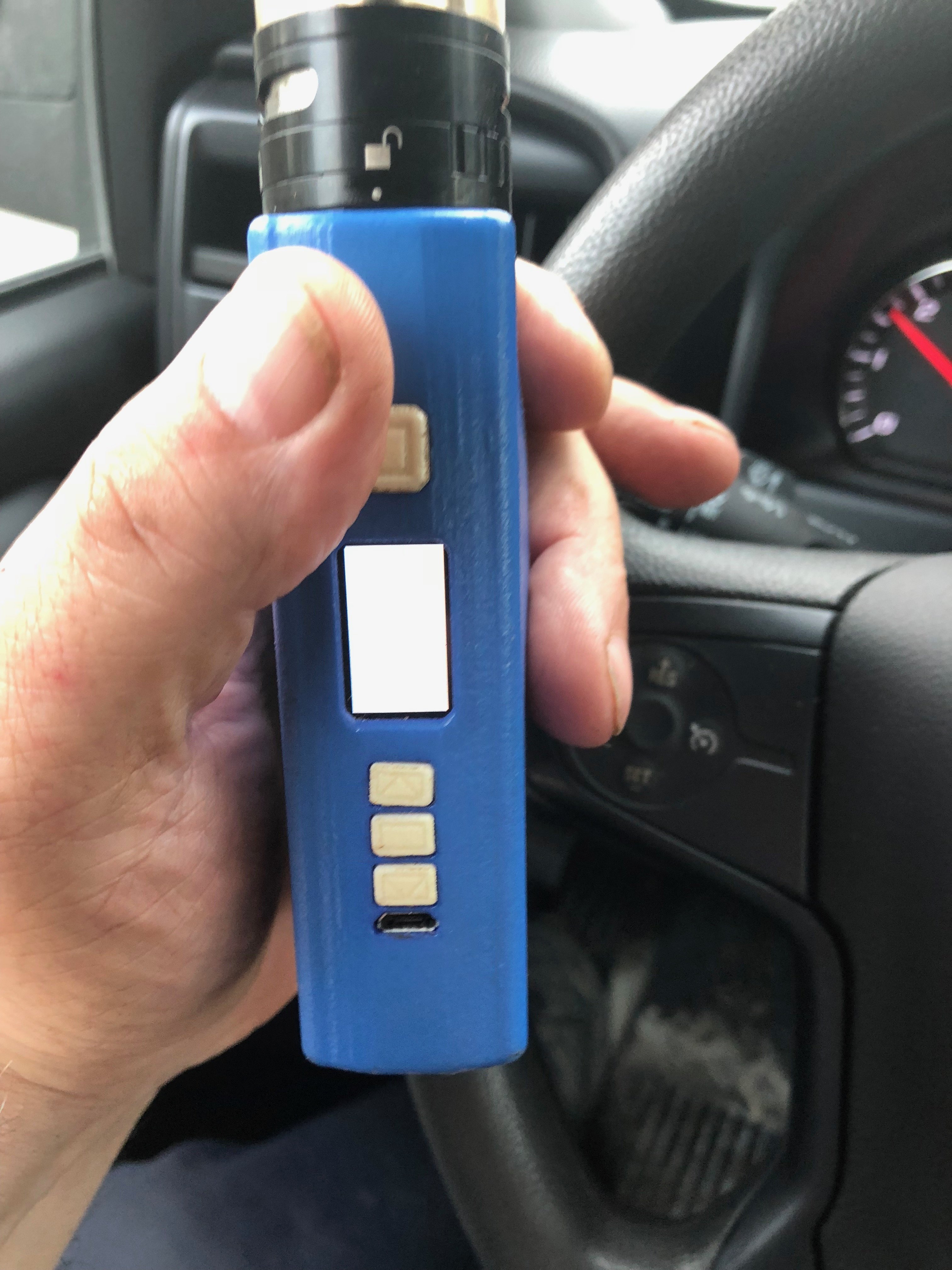

Hi One of my 250c's, got a white screen yesterday, just out of the blue. I tried to rewrite the firmware , didn't work. I tried disconnecting & reconnecting the battery, didn't work. I tried rewriting the theme, didn't work. I tried a Hard Reboot & the screen came back :) But It did it 2 more times today :( The Hard reboot still worked :) How ever it is getting annoying now to have to do a Hard Reboot to get my screen back. Is this a known issue? Can I do some thing to Stop This from happening? BTW the Chip still works Fine, when this happens, just a White Screen

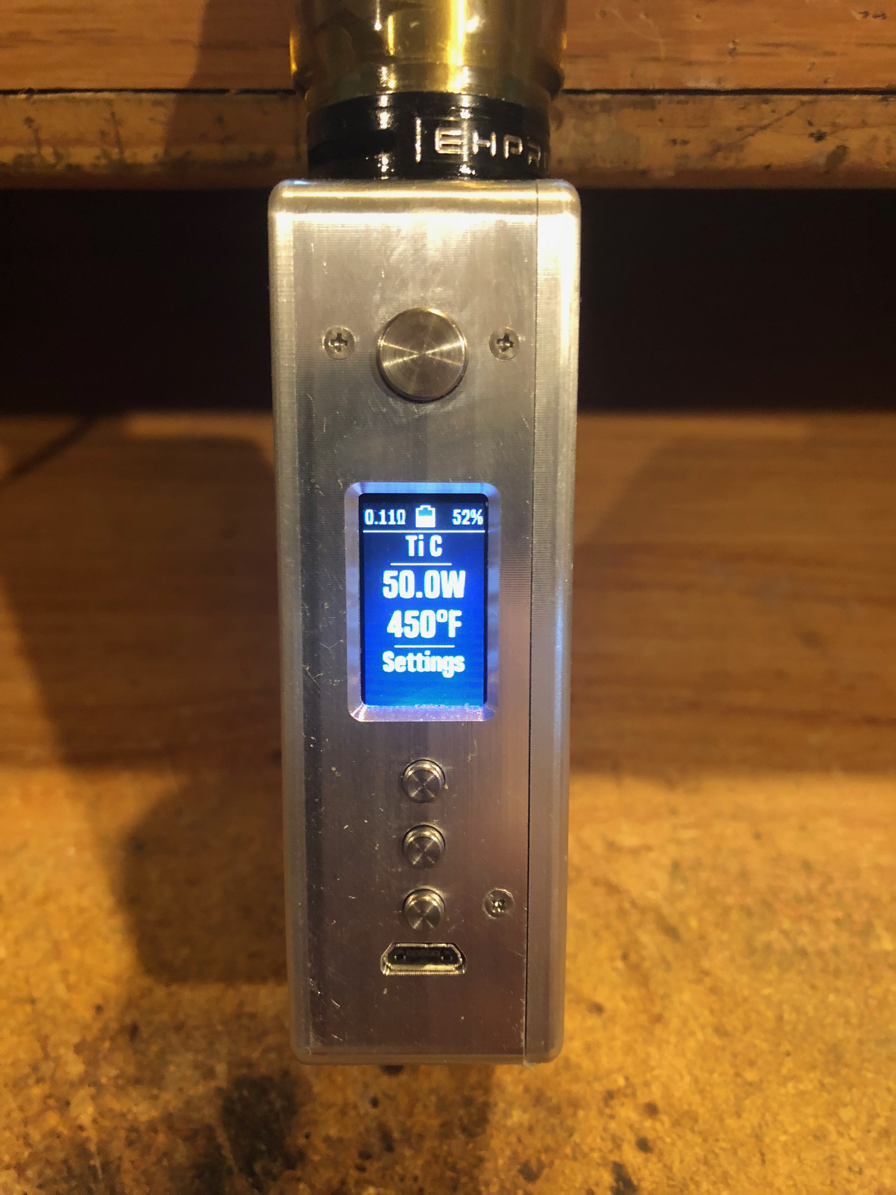

Hey Bud If you are looking for a kit to build a 75c? Here a pretty good deal, you can get every thing you need in one kit http://analogboxmods.ca/Box-Mod-Kits/DNA75-Kit You have several options, I build an ABM1 with a FD 510, a ABM battery sled & external chip mount. It's a nice small sized box that fits a 21700 battery. Here's a few pics of mine Thats a Hana Mod DNA200 beside it for scale You can Email Them with Questions before you order, if you need Help Dan even has some nice YT videos to Help along the way https://www.youtube.com/watch?v=Y1wwcn39EiI

Here'a another one ABM2, 1000mAH 4S lipo, Sorce 510. I posted some reference pics, thats a Silo 950 same size as the old Evolv Reference Mod FYI ABM = Analog Box Mods

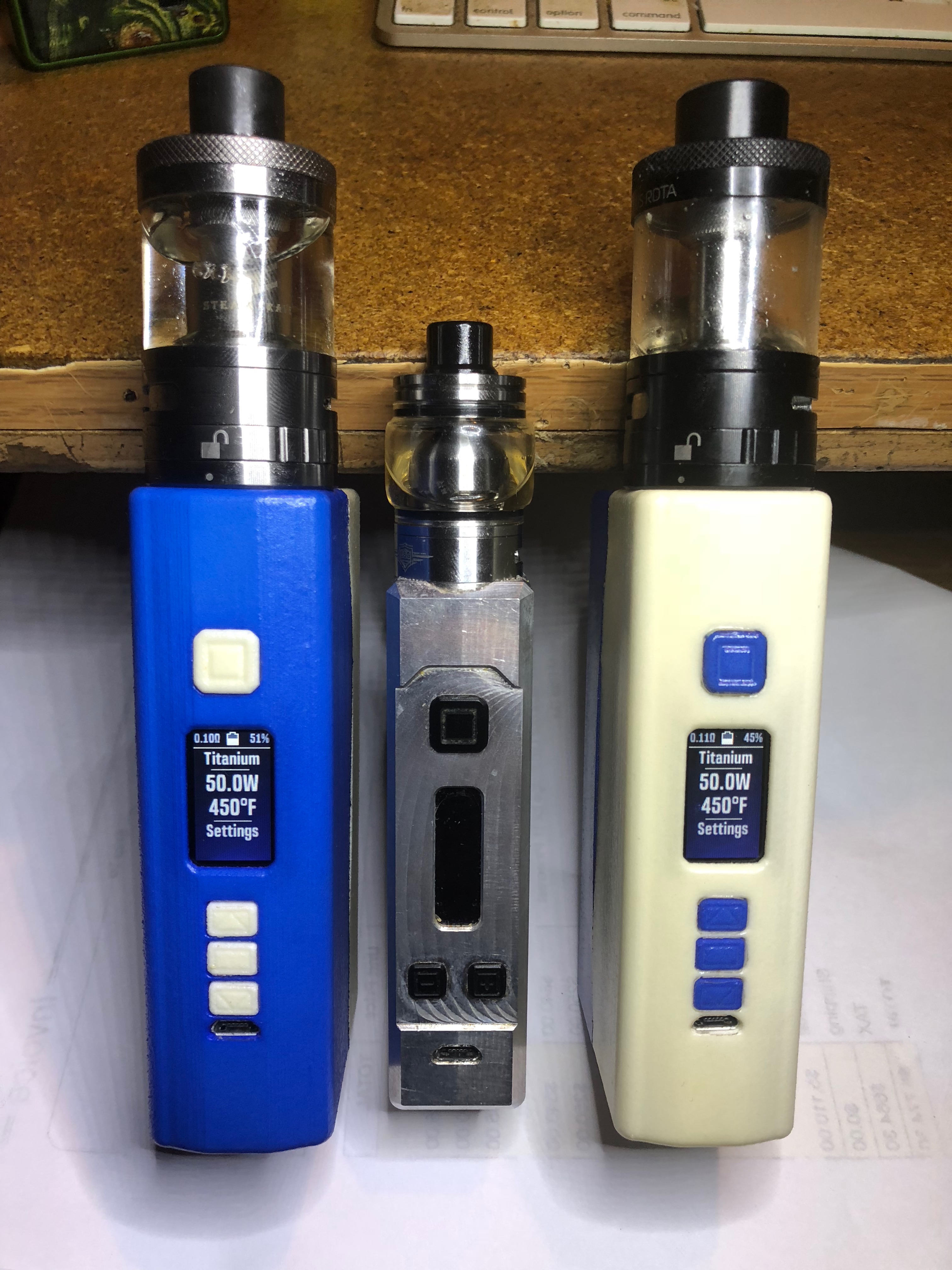

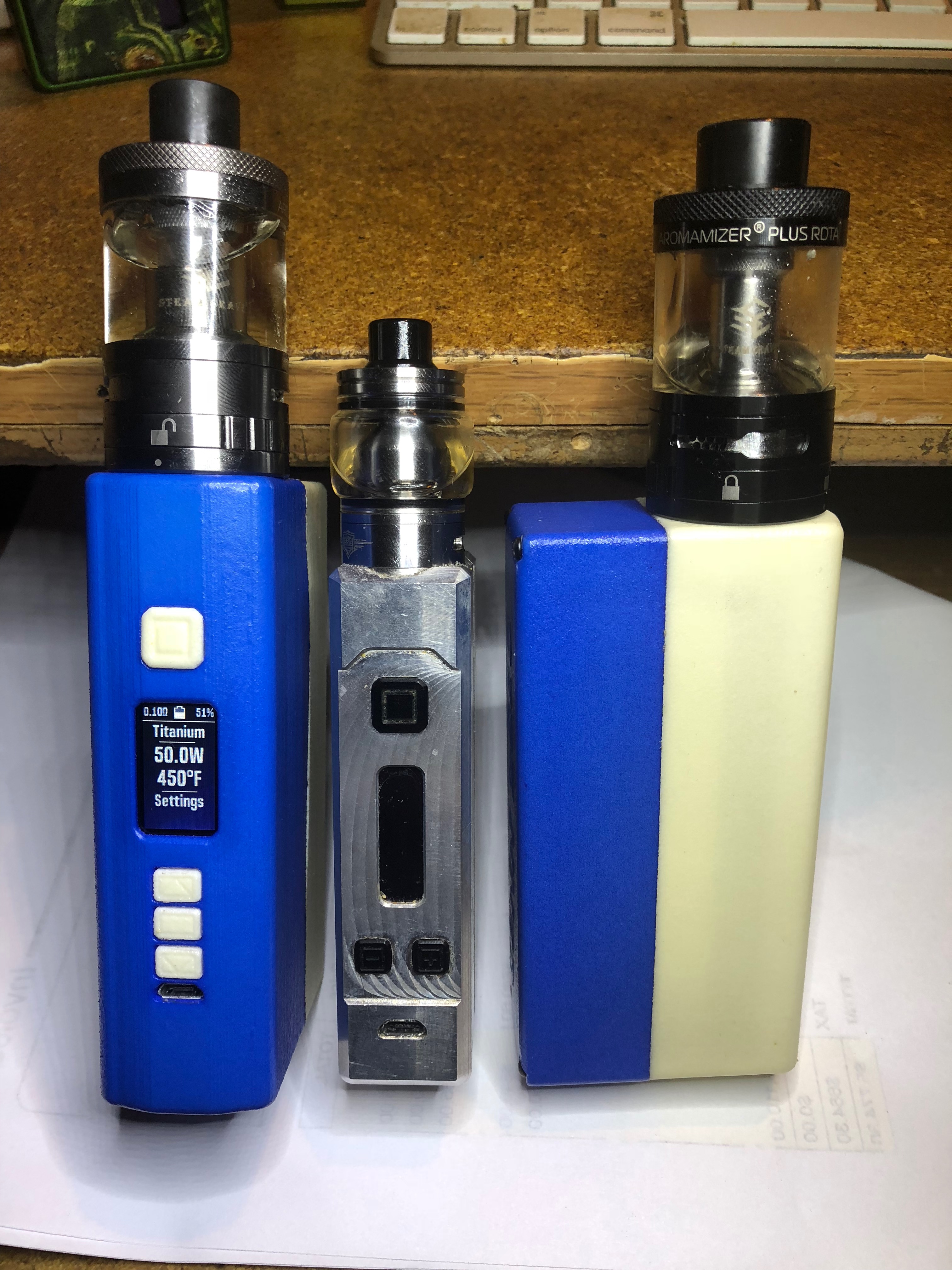

I hope you don't mind if I get in on your thread? These are my first 250C builds I used 3D printed enclosures from SW, evolv 510's & 4S 1500 mAH Lumenier Lipo's I didn't take any pics of the build but here they are There 1" thick 2 & 1/4" wide & 4" tall in the middle there is a Silo 950 for size comparison. There a Bit Big & Heavy But thats a good thing if your running 30mm atty's with Clapton Coils
