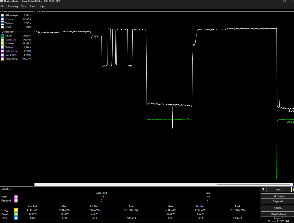

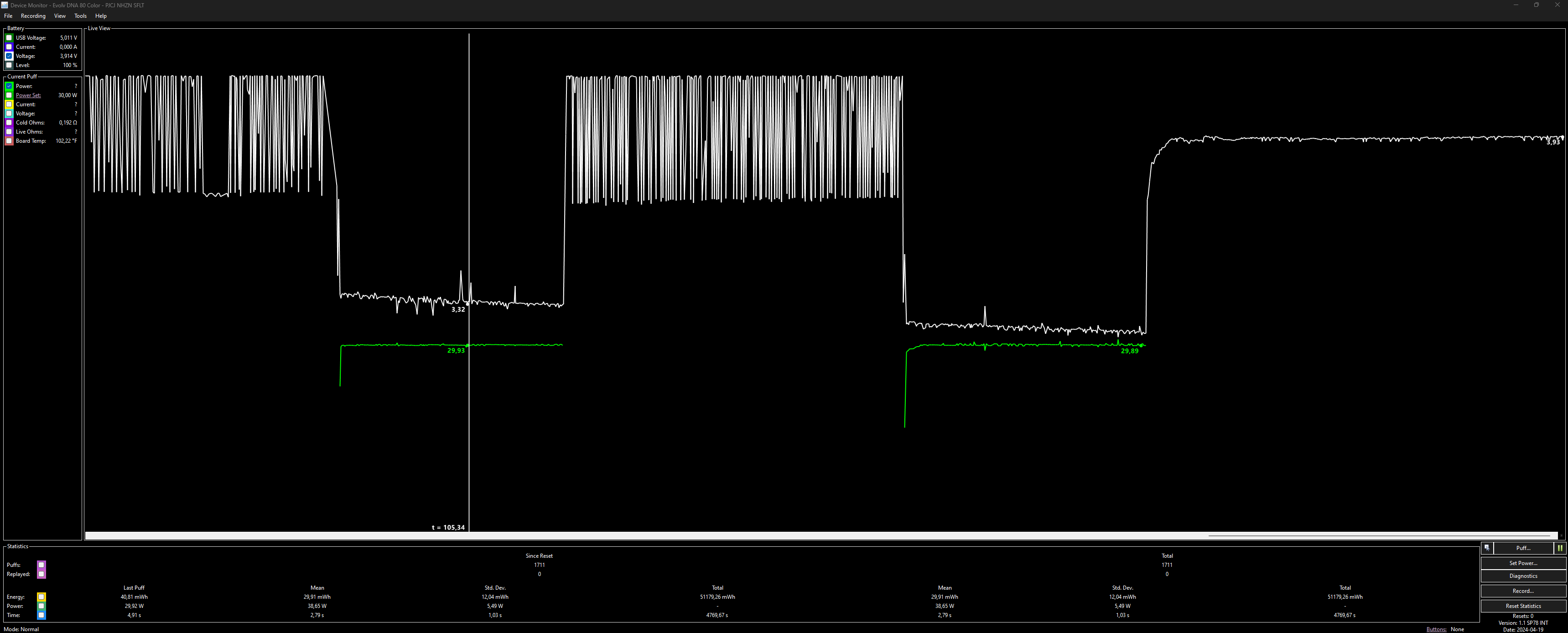

EagleRock Posted July 26, 2024 Report Share Posted July 26, 2024 Here is my setting file and a screenshot of the Device monitor while vaping at 30W with the hover mark. if you need any other info please let me know SETTING dna80c.ecig 1 Link to comment Share on other sites More sharing options...
EagleRock Posted July 26, 2024 Report Share Posted July 26, 2024 Another while im vaping. 1 Link to comment Share on other sites More sharing options...
dwcraig1 Posted July 26, 2024 Report Share Posted July 26, 2024 Hoover your mouse over where the red arrow is pointed at and post the voltage reading. Nevermind I see 3.29v on the right. 1 Link to comment Share on other sites More sharing options...

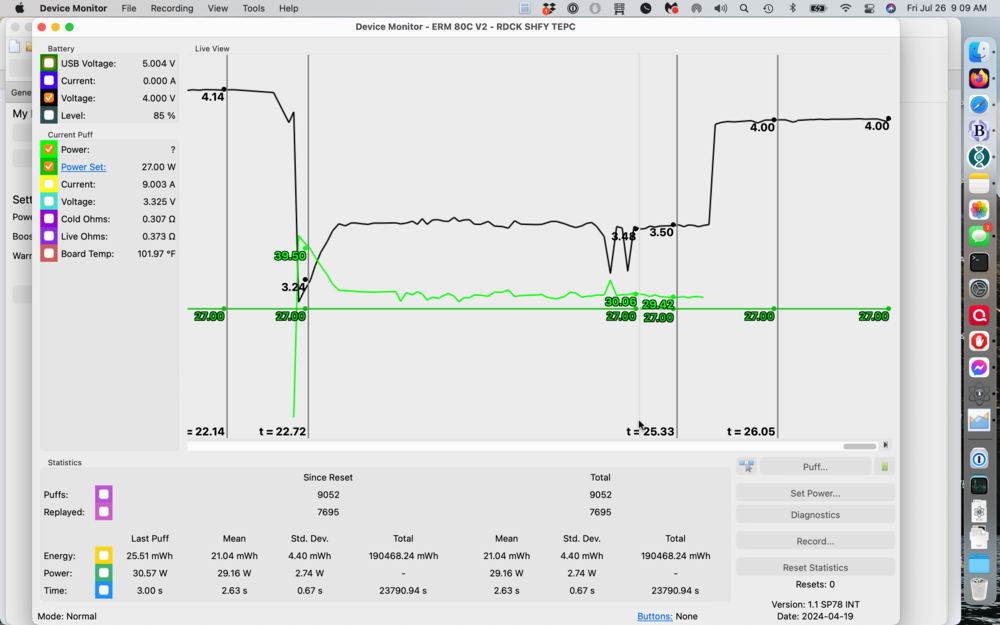

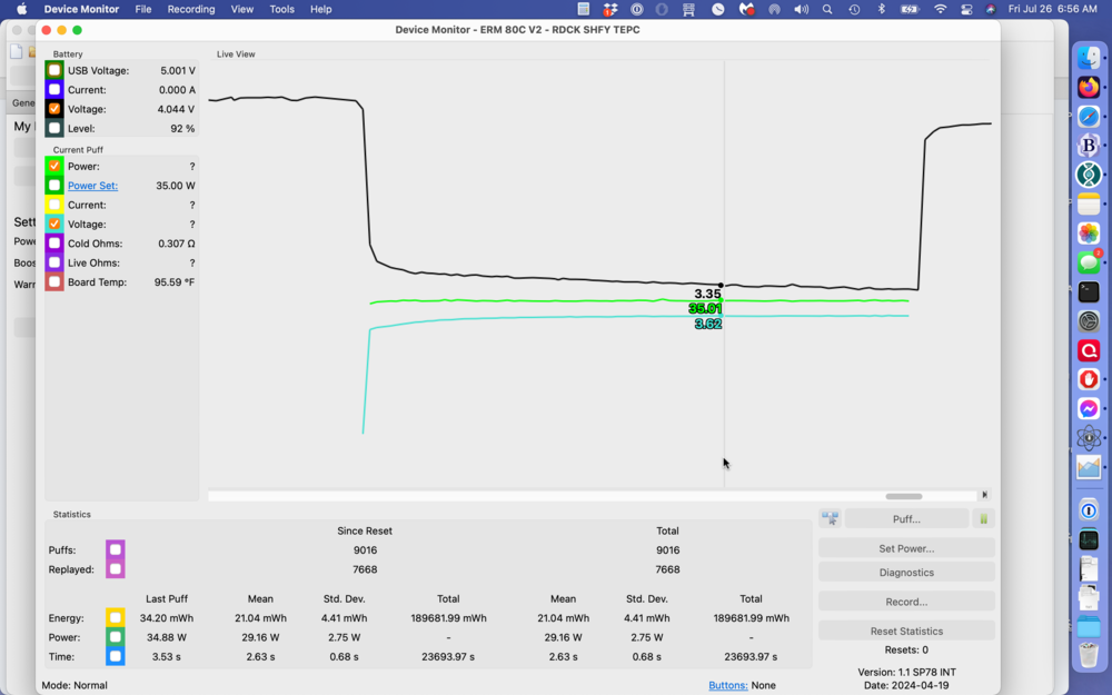

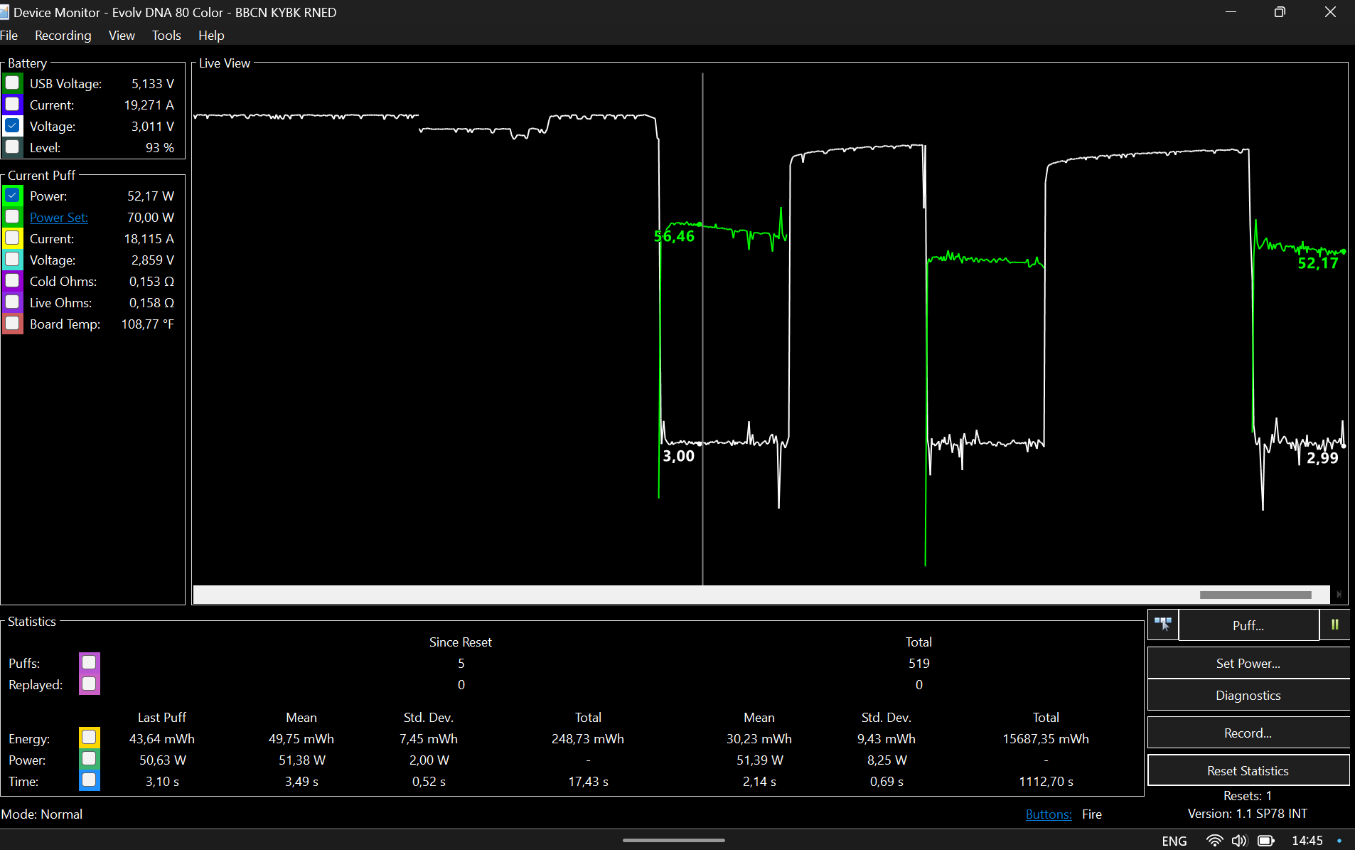

Dieseljesus Posted July 26, 2024 Report Share Posted July 26, 2024 1 hour ago, Wayneo said: Gents, I do believe @James was hoping for a 'Device Monitor' from all 3 of you. Ideally it should look like below. The only addition I'll make is if you hover in the middle of a puff it will show details such as battery voltage at that time (see my mouse arrow). @Dieseljesus thanks for finally compairing to your blaze, and could you swap boro and battery again. Edit: And if you go to settings on your mod and click(fire button) at the top, it will show current puffs and firmware (also requested for all 3 of you). I can supply more data from escribe later when I'm not on the road. Until then here's my firmware and puffs: SAN DNA80C: PUFFS: 510 FIRMWARE: 78 ---- BLAZE DNA80C: PUFFS: 255 FIRMWARE: 78 --- I can't really count the times I've changed battery on these and especially the San. 15? 20? I know it's up there because I was at my summerhouse with 10+ batteries and they lasted just a few days. Now I'm on another trip and the trip up to this place which was 3 hrs took 2 batteries itself. It's like @EagleRock says, it feels like you get 30,40 or 50 puffs from a battery max. That's why I'm not using the San anymore while I'm here and only the blaze now since it seems to be more battery efficient. Link to comment Share on other sites More sharing options...
dwcraig1 Posted July 26, 2024 Report Share Posted July 26, 2024 It appears to me that your not supplying the board with the needed power. Could be a number of things, weak battery, poor battery coonection to battery contacts, ect. 3.29 volts drop on a full charge cell is a problem. 1 Link to comment Share on other sites More sharing options...

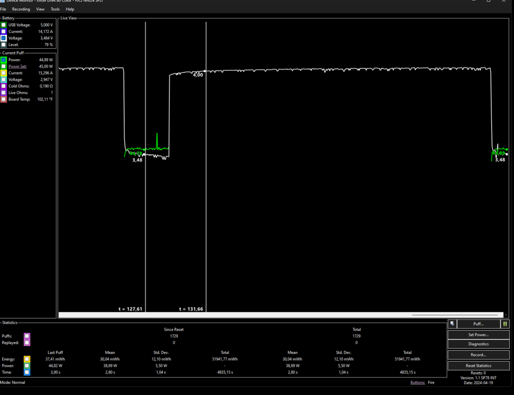

Dieseljesus Posted July 26, 2024 Report Share Posted July 26, 2024 Here´s my data. I hope i did it correctly. It was a quite new battery. I believe i got this early July. Freshly charged. Popped it in and did a test with 6 puffs. First i did 3 puffs, screenshotted and i didnt get a volt reading because i forgot to point the mouse (around 3 volts for every puff). Thats when it showed 93% after 3 puffs... did three more, screenshotted and also screenshotted the battery level which is now down to 86%. 6 puffs apparenty takes 14% which makes sense with the 30-50 puffs me and @EagleRock have been noticing. Tell me if you need any more data. Link to comment Share on other sites More sharing options...

EagleRock Posted July 26, 2024 Report Share Posted July 26, 2024 27 minutes ago, dwcraig1 said: It appears to me that your not supplying the board with the needed power. Could be a number of things, weak battery, poor battery coonection to battery contacts, ect. 3.29 volts drop on a full charge cell is a problem. My battery was half full when i did this. As mentioned it is 3 weeks old molicel p30b bought from a reputable local shop. The wheel on the negative terminal is tight. Link to comment Share on other sites More sharing options...
BillW50 Posted July 26, 2024 Report Share Posted July 26, 2024 58 minutes ago, EagleRock said: Here is my setting file and a screenshot of the Device monitor while vaping at 30W with the hover mark. if you need any other info please let me know SETTING dna80c.ecig 15.19 kB · 1 download That jumping up and down in white is the battery voltage while not firing? If so, that shouldn't be. Link to comment Share on other sites More sharing options...

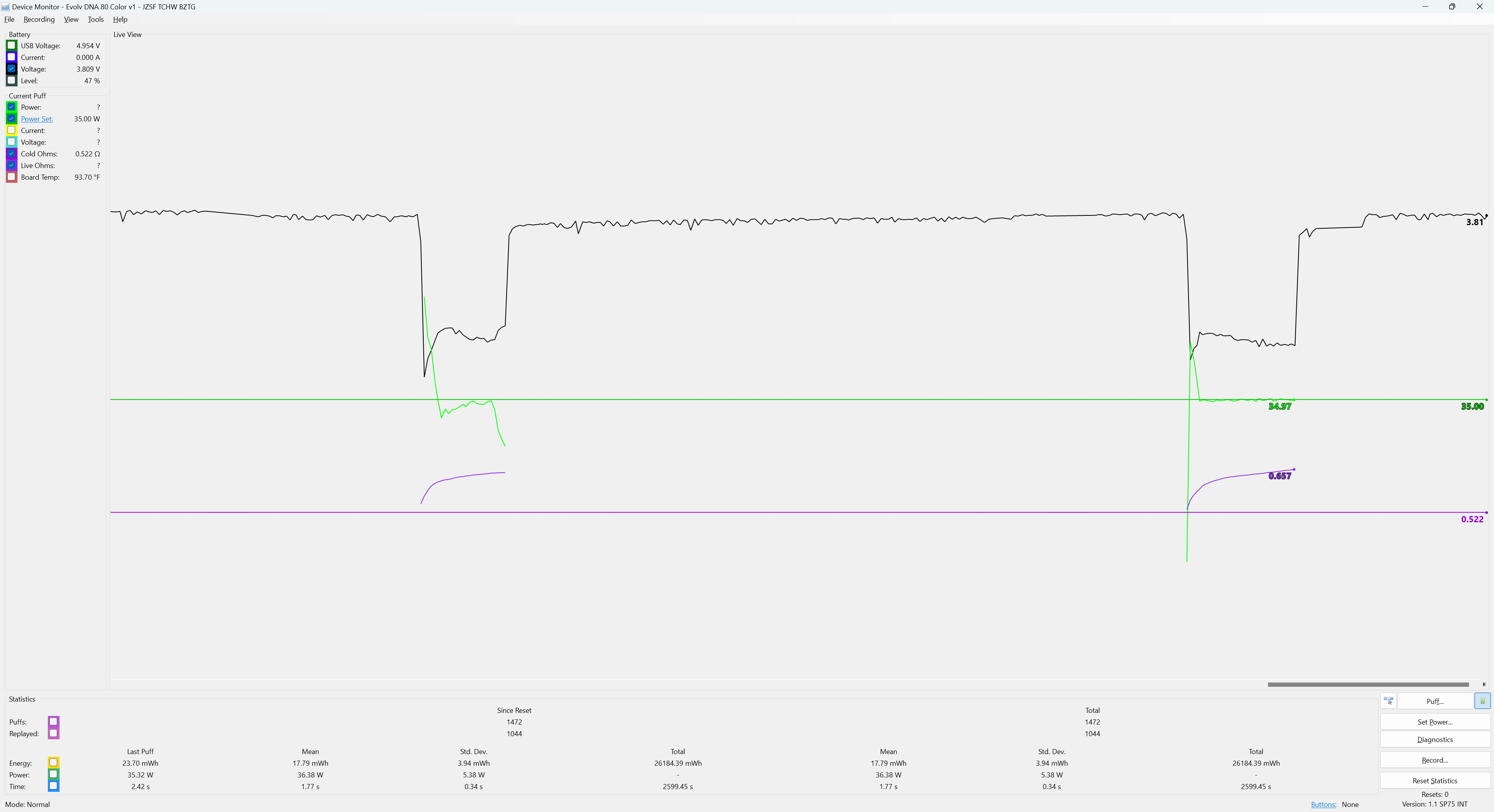

Wayneo Posted July 26, 2024 Report Share Posted July 26, 2024 Gents, couple things. You can actually include/show MORE vertical lines in Device Monitor. The 1st is just a click, subsequent (on a Mac) are a 'control' click. It's good showing a before puff. Sample below. What I didn't mention before is the battery used for my screenshot (.7v drop at 35 watts) is from heavily used Sony VTC5 with a dented positive (from this mod). 1 Link to comment Share on other sites More sharing options...
EagleRock Posted July 26, 2024 Report Share Posted July 26, 2024 9 minutes ago, BillW50 said: That jumping up and down in white is the battery voltage while not firing? If so, that shouldn't be. Yep, not firing. Was thinking that it looks weird too Link to comment Share on other sites More sharing options...

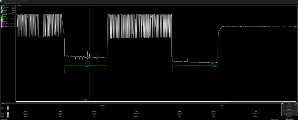

EagleRock Posted July 26, 2024 Report Share Posted July 26, 2024 Fresh battery with more vertical lines while vaping Link to comment Share on other sites More sharing options...
EagleRock Posted July 26, 2024 Report Share Posted July 26, 2024 Changed the wattage to 45W for better flavour, here is with 30W. Link to comment Share on other sites More sharing options...

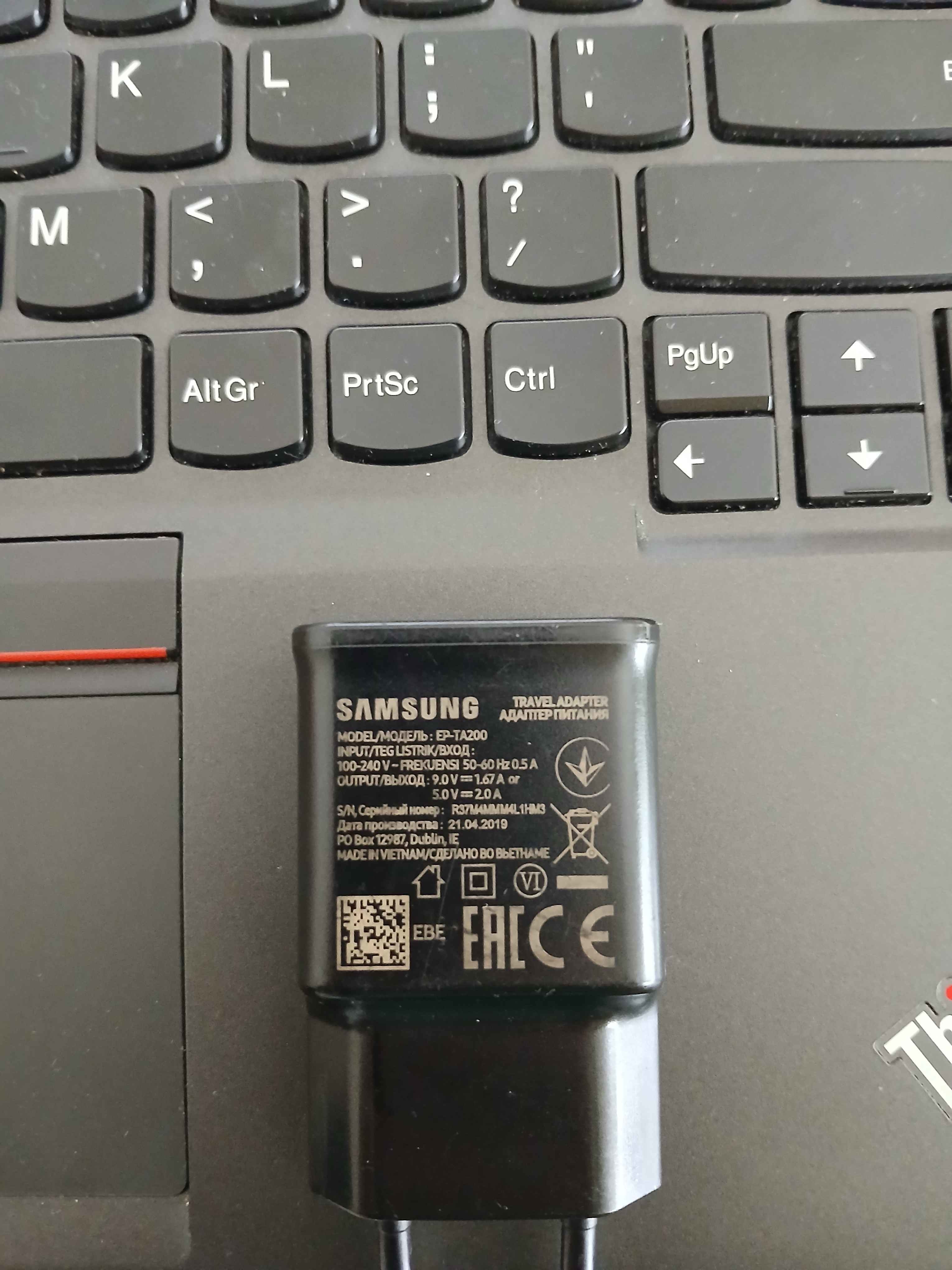

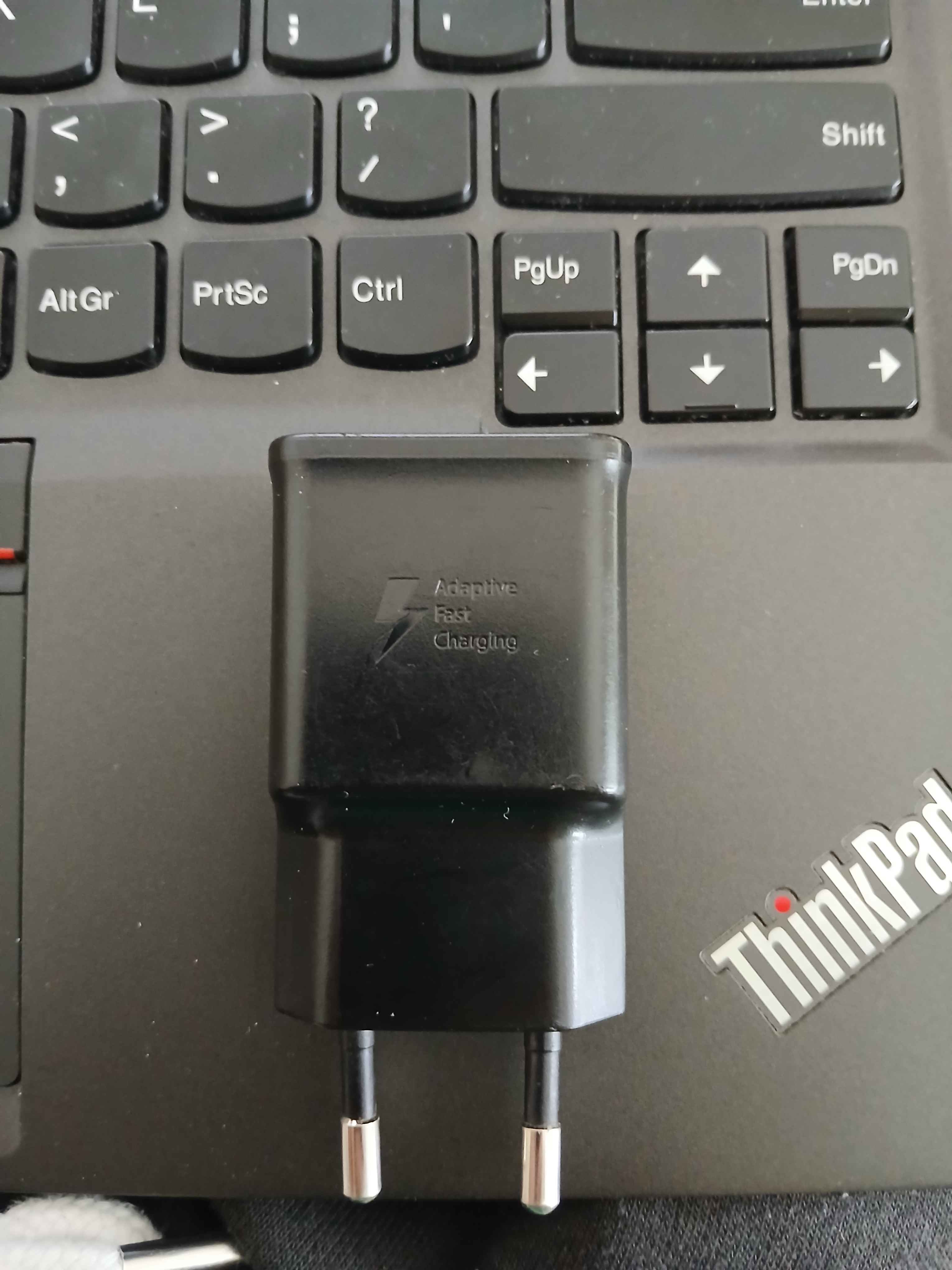

intel Posted July 26, 2024 Author Report Share Posted July 26, 2024 23 hours ago, James said: Would you mind taking a screenshot of Device Monitor while you are taking a puff? logging Battery Voltage and Power at least (Wondering if it could be voltage drop on the battery connector, loaded vs unloaded voltage.) Are you noticing power drop off during firing, or is it showing a low battery percentage as well? Would you post your settings .ecig file please? (Just to see if it differs in any important way.) Also what brand/model of quick charger are you having problems with? Thanks! Sorry about not stating charger before, did not notice. It is a normal samsung quickcharge charger, genuine, came with a phone. Its 9V 1.67A and 5V 2A My screen says its charging when plugged in but the battery level never increases Link to comment Share on other sites More sharing options...
James Posted July 26, 2024 Report Share Posted July 26, 2024 @intel, what does it show for USB Voltage when you plug it in? Would you mind taking a photo of the information on the charger? I just bought a new Samsung phone this week actually, and it didn't come with a charger. (It uses USB-C, so they evidently expect me to buy my own.) If I know specifics I'll buy one and fix it if possible. @EagleRock, a 1V drop is quite large. *If* the battery itself can handle the current, it's worth looking at how the battery is contacting. A full battery will be at 4.2V. If at your desired power level you hit 3.2V under load, that's a 1V drop much of which is likely resistive due to the battery contact. But that also means you'll hit Weak Battery (3V) when the battery is at 4.0V or so, when the battery actually has about 80% of its capacity left. If the battery itself can't handle the current that's a different problem, but if it can, that's very likely where your problem lies. (The oscillation screenshot strongly suggests a dicey connection. The charger oscillates like that if a battery isn't even connected. It could very well be that it's barely contacting, and it warms up and makes slightly better but still bad contact.) 2 Link to comment Share on other sites More sharing options...
Dieseljesus Posted July 26, 2024 Report Share Posted July 26, 2024 3 hours ago, James said: @intel, what does it show for USB Voltage when you plug it in? Would you mind taking a photo of the information on the charger? I just bought a new Samsung phone this week actually, and it didn't come with a charger. (It uses USB-C, so they evidently expect me to buy my own.) If I know specifics I'll buy one and fix it if possible. @EagleRock, a 1V drop is quite large. *If* the battery itself can handle the current, it's worth looking at how the battery is contacting. A full battery will be at 4.2V. If at your desired power level you hit 3.2V under load, that's a 1V drop much of which is likely resistive due to the battery contact. But that also means you'll hit Weak Battery (3V) when the battery is at 4.0V or so, when the battery actually has about 80% of its capacity left. If the battery itself can't handle the current that's a different problem, but if it can, that's very likely where your problem lies. (The oscillation screenshot strongly suggests a dicey connection. The charger oscillates like that if a battery isn't even connected. It could very well be that it's barely contacting, and it warms up and makes slightly better but still bad contact.) I believe I hit 3 volts as well with a pretty new battery.. Lowest was 2.99 when I took a puff 1 Link to comment Share on other sites More sharing options...
intel Posted July 27, 2024 Author Report Share Posted July 27, 2024 (edited) 19 hours ago, James said: @intel, what does it show for USB Voltage when you plug it in? Would you mind taking a photo of the information on the charger? I just bought a new Samsung phone this week actually, and it didn't come with a charger. (It uses USB-C, so they evidently expect me to buy my own.) If I know specifics I'll buy one and fix it if possible. @EagleRock, a 1V drop is quite large. *If* the battery itself can handle the current, it's worth looking at how the battery is contacting. A full battery will be at 4.2V. If at your desired power level you hit 3.2V under load, that's a 1V drop much of which is likely resistive due to the battery contact. But that also means you'll hit Weak Battery (3V) when the battery is at 4.0V or so, when the battery actually has about 80% of its capacity left. If the battery itself can't handle the current that's a different problem, but if it can, that's very likely where your problem lies. (The oscillation screenshot strongly suggests a dicey connection. The charger oscillates like that if a battery isn't even connected. It could very well be that it's barely contacting, and it warms up and makes slightly better but still bad contact.) Here is device monitor with the vape plugged into my laptop, also attached pictures of charger. I can't measure anything with the charger plugged in, would be willing to sacrifice an usb-c cable, but I am travelling and don't have a multimeter here. Edited July 27, 2024 by intel Link to comment Share on other sites More sharing options...
