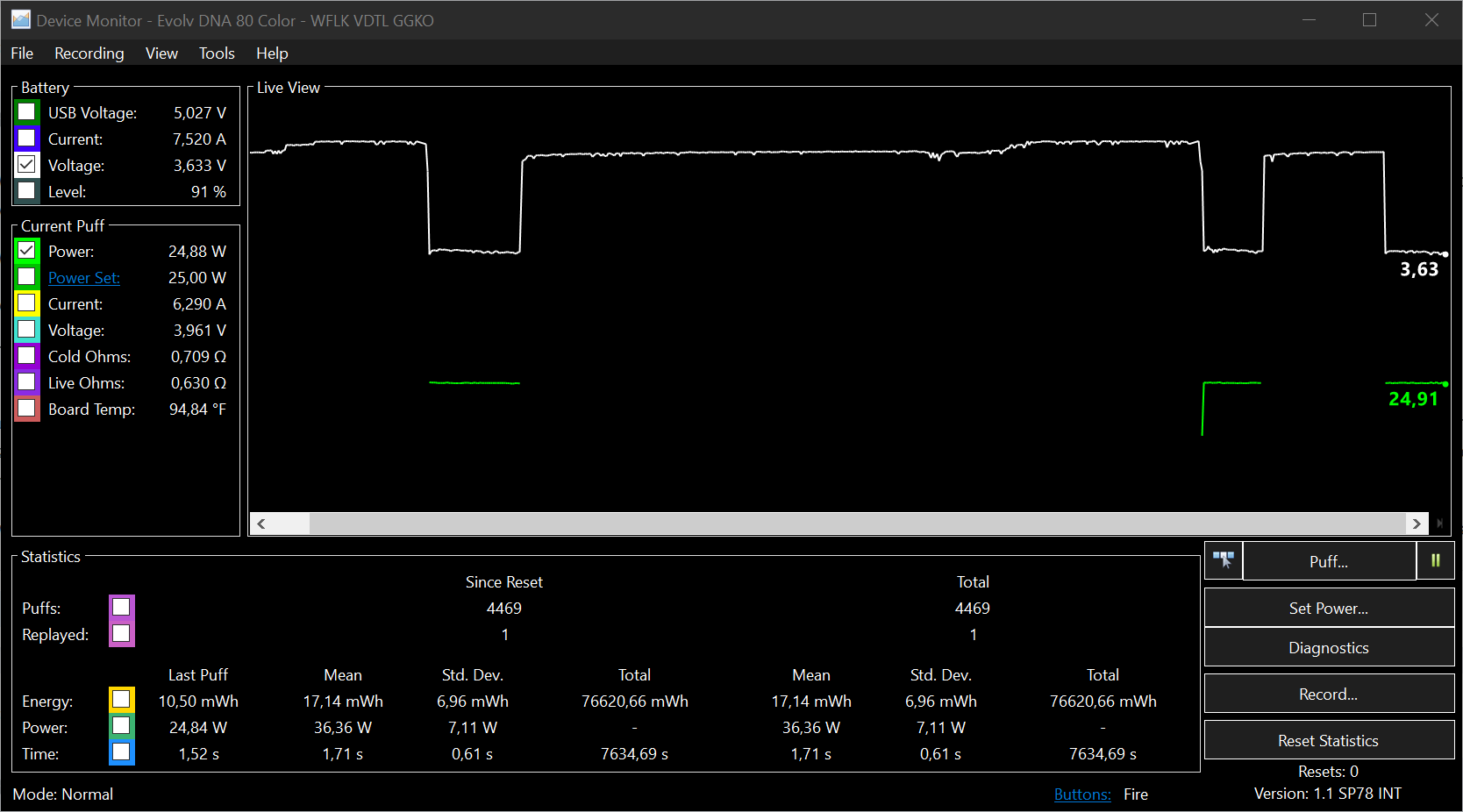

I think this might be an indication that the chip need so much voltage to run, something is not right.
Would you mind taking a screenshot of Device Monitor while you are taking a puff? logging Battery Voltage and Power at least (Wondering if it could be voltage drop on the battery connector, loaded vs unloaded voltage.) Are you noticing power drop off during firing, or is it showing a low battery percentage as well?

I have since installed a weaker 0.6ohm coil at 25w as something for 30-40w compatible with the shift tank was unavailable at my local store, it does yield me better bat life but sacrifices quite a bit of flavor, here is a screenshot. 45w might just be too much for a single 18650.

Gents, I do believe @James was hoping for a 'Device Monitor' from all 3 of you. Ideally it should look like below. The only addition I'll make is if you hover in the middle of a puff it will show details such as battery voltage at that time (see my mouse arrow). @Dieseljesus thanks for finally compairing to your blaze, and could you swap boro and battery again.
Edit: And if you go to settings on your mod and click(fire button) at the top, it will show current puffs and firmware (also requested for all 3 of you).
