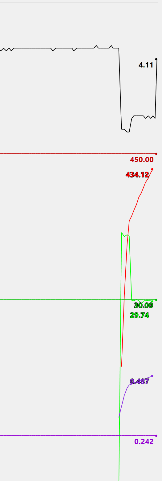

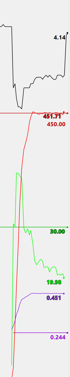

dwcraig1 Posted February 10 Report Share Posted February 10 ere is my NiFe48 coil and NiFe30 coil firing in pretty much an identical situation. Link to comment Share on other sites More sharing options...

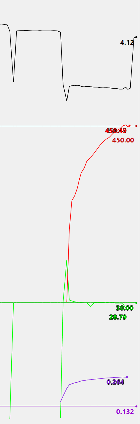

dwcraig1 Posted February 10 Report Share Posted February 10 NiFe48 coil using NiFe30 CSV (Stealth Vave not Resistherm) Link to comment Share on other sites More sharing options...

dwcraig1 Posted February 11 Report Share Posted February 11 I use contact coils and was thinking maybe a couple of wraps were shorting when cold resulting in a lower cold resistance. So I opened it up,removed the wick and separated the coils and fired it and then pushed them back togther. I'm using Atomizer Analyzer during the whole process. It came out a little higher afterwards. I did this right before I was to leave for work and I choose the wrong one (the NiFe30 one). I didn't have time to do the one with NiFe48 so when I get home I'll try it with that. Looking at my snip of NiFe48 firing I'm seeing the resistance more than double and I'm thinking that's not right. 1 Link to comment Share on other sites More sharing options...
