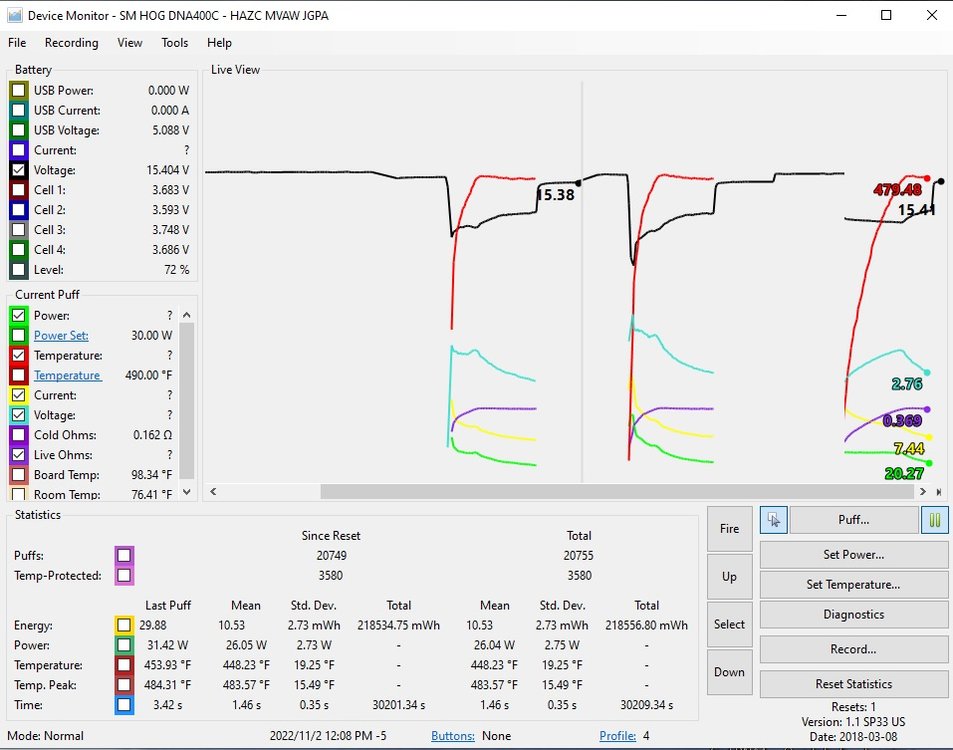

BillW50 Posted November 2, 2022 Report Posted November 2, 2022 Do what we have been saying. Run EScribe's Device Manager and change whatever you are curious about and then see how it changes your vape right on the screen. Or are you insisting we do it for you? 1
Marco234 Posted November 2, 2022 Author Report Posted November 2, 2022 2 hours ago, BillW50 said: Do what we have been saying. Run EScribe's Device Manager and change whatever you are curious about and then see how it changes your vape right on the screen. Or are you insisting we do it for you? dude....as i said before....i did this....no change occured...i feel like im not asking a lot.
BillW50 Posted November 2, 2022 Report Posted November 2, 2022 The power and temperature didn't change? What were you changing? Warmth? It only has an effect when playing within Replay, just like @Wayneo said. I figured I am going to have to do it for you. Here is Warmth set in the middle, then full, and then off. Maybe you don't see a difference, but I sure do. It gives it a boost in power in the beginning the puff. The higher the warmth, the higher it applies more power. When off, power is flat without any extra power at the beginning of the puff. 1
