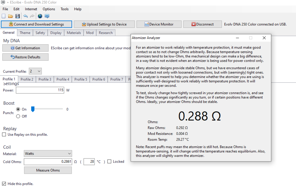

BillW50 Posted August 7, 2022 Report Posted August 7, 2022 What does EScribe's Atomizer Analyzer say? 15Ω? And what theme are you using? Since different themes can be looking at different readings? Although yours does sound like the theme is using live ohm reading when firing, cold reading when not. The C-boards doesn't update the cold Ω's in real time, like the non-C boards do. The C-boards requires keypresses in the theme to reread the cold resistance.

meloserj Posted August 8, 2022 Author Report Posted August 8, 2022 Hi @BillW50 Atomizer analyzer saying 0.21 until 0.24 which is fluctuating and never stopped accurate. But as I told before, the device monitor shows live ohms accurately and cold ohm much higher. I was using mod stock theme, i even changed it yesterday to Gauges theme but no changes. I will update to Frank65 theme (hope to find it in download section) and will update you.
Wayneo Posted August 8, 2022 Report Posted August 8, 2022 15 minutes ago, meloserj said: Atomizer analyzer saying 0.21 until 0.24 which is fluctuating and never stopped accurate That fluctuation is too great. Normally I'd suggest checking your build connections first, BUT seeing as how the 200/250 show .15Ω, now I'd suggest you check the length of the 510 pin on your atty compared to the mods 510 depth. Have you tried any other atty's with a longer 510 pin? Changing themes aren't gonna accomplish SFA. Atomizer Analyzer shows the truth.
meloserj Posted August 8, 2022 Author Report Posted August 8, 2022 9 minutes ago, Wayneo said: That fluctuation is too great. Normally I'd suggest checking your build connections first, BUT seeing as how the 200/250 show .15Ω, now I'd suggest you check the length of the 510 pin on your atty compared to the mods 510 depth. Have you tried any other atty's with a longer 510 pin? Changing themes aren't gonna accomplish SFA. Atomizer Analyzer shows the truth. Hi @Wayneo Yes I did try different atty. The same build on SC V2 plus and SC Ragnar installed (Dual 6 wraps of 26*3/36 in 3.5 mm Ni80 Fused clapton) and those atty's have different 510 leg length. No changes has seen. But DNA200/250 show exactly the same cold ohms. I even tried to check the 510 connector center pin and wires to DNA250C board, checked for cold soldering, but everything seems ok.
Wayneo Posted August 8, 2022 Report Posted August 8, 2022 1 hour ago, meloserj said: No changes has seen Where? In Atomizer analyzer? And what's the fluctuation for each?

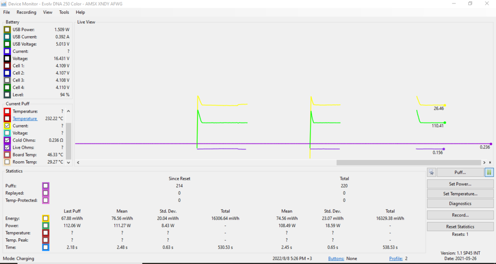

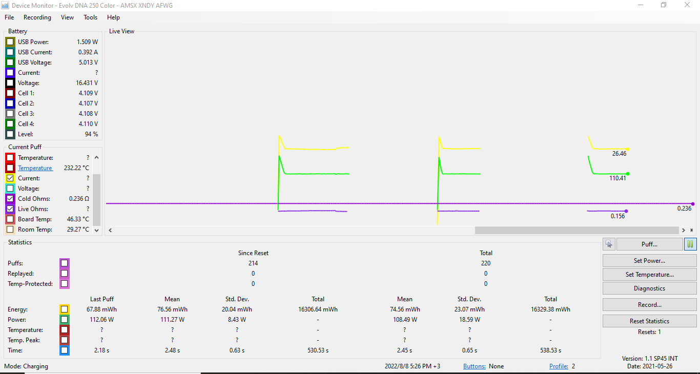

Wayneo Posted August 8, 2022 Report Posted August 8, 2022 Actually can you post a screenshot of Device Monitor while firing. Click (enable) power, cold ohms, live ohms beforehand
Wayneo Posted August 8, 2022 Report Posted August 8, 2022 Thanks for those screenshots. First, remeasure your ohms right now on your mod, with your mod. Then would you mind redoing both screenshots, but this time selecting the profile you are actually in. It's listed as profile 2 in your DM shot, but you posted a profile 1pic. Thanks.
meloserj Posted August 8, 2022 Author Report Posted August 8, 2022 @Wayneo I was exactly waiting for your comment. Because after taking screen shot, I looked to profile and then I changed it to profile number 2 and there again I run atomizer analyzer. The same issue observed. So I don’t think this would be a profile change and analyzer issue. Issue still persist and as you can see from device monitor, cold ohms are unusual.
