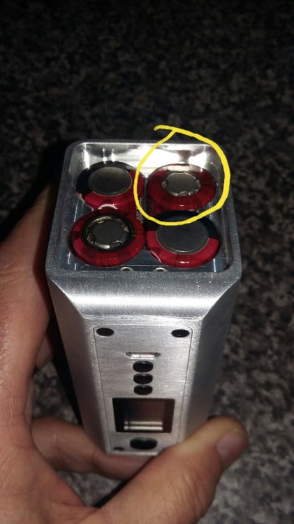

ScubaSteve Posted July 31, 2022 Report Posted July 31, 2022 (edited) Had this mod just around a week and it's worked perfectly up until today, stuck in 4 brand new molicells I got same time as the mod freshly charged and it's stuck on 4% check battery. From my looking around is this an issue with the board reading the battery voltage or did I just get lucky enough to buy a dud battery? Edited July 31, 2022 by ScubaSteve
dwcraig1 Posted July 31, 2022 Report Posted July 31, 2022 OK, see that cell #4, it's higher than 4.2 volts. The battery management chip is bad. Sorry to have to tell you that. Are you able to return it where you bought it? Stealh Vape in UK is an Evolv service center, try contacting them. If the above fails open a ticket with Evolv. https://helpdesk.evolvapor.com/index.php?a=add&category=1 1
Jjhaire Posted January 2, 2023 Report Posted January 2, 2023 Pennywise Hammer of god. Hi all. Does anyone know why this battery position always drains more than the other 3. Fully charged married batteries. Tried all of them in different slots but always marked position drains more. Thanks for any advice. https://apis.mail.aol.com/ws/v3/mailboxes/@.id==VjN-VGjWRoTfKw3iwDLRxoglukF5absYO2Rhlq4q9hjn0u12DDiZEcftSdtobFeilV59yqtsdt-jko-uK0ko8KHOrw/messages/@.id==AFU24sx2vzG9Y67Orgm0YIUX6po/content/parts/@.id==2/thumbnail?appid=aolappandroidmobile&downloadWhenThumbnailFails=true&pid=2
ScubaSteve Posted January 2, 2023 Author Report Posted January 2, 2023 44 minutes ago, Jjhaire said: Pennywise Hammer of god. Hi all. Does anyone know why this battery position always drains more than the other 3. Fully charged married batteries. Tried all of them in different slots but always marked position drains more. Thanks for any advice. https://apis.mail.aol.com/ws/v3/mailboxes/@.id==VjN-VGjWRoTfKw3iwDLRxoglukF5absYO2Rhlq4q9hjn0u12DDiZEcftSdtobFeilV59yqtsdt-jko-uK0ko8KHOrw/messages/@.id==AFU24sx2vzG9Y67Orgm0YIUX6po/content/parts/@.id==2/thumbnail?appid=aolappandroidmobile&downloadWhenThumbnailFails=true&pid=2 Same thing that happened to mine battery controller fried itself, can either try return it to where you bought it (good luck with the stupid customer support questions) or get someone to stick in a new board
Wayneo Posted January 2, 2023 Report Posted January 2, 2023 @Jjhaire Can you post a screenshot like @ScubaSteve did in his initial post, please.
