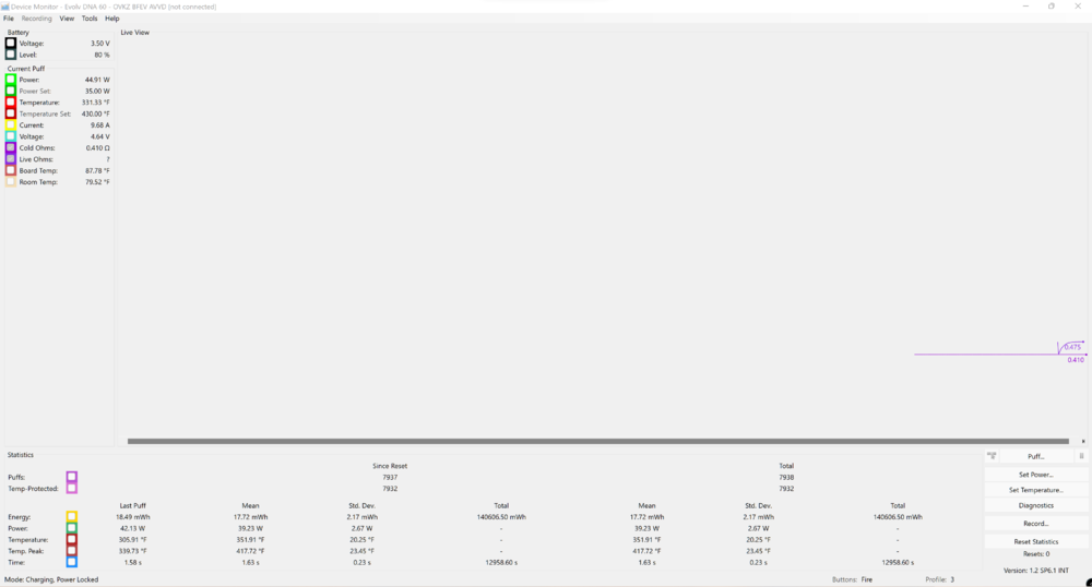

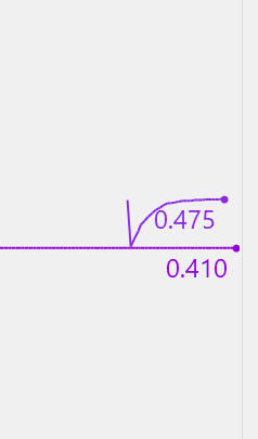

dwcraig1 Posted June 8, 2022 Report Posted June 8, 2022 Here is a snippet of my SS316 coil firing in Devise Monitor, while your resistance may be different. Notice the percentage change from cold to hot. Also use Atomizer Analyzer to see that your atomizer is making a solid connection. It should have a good connection before it bottoms out. 1
