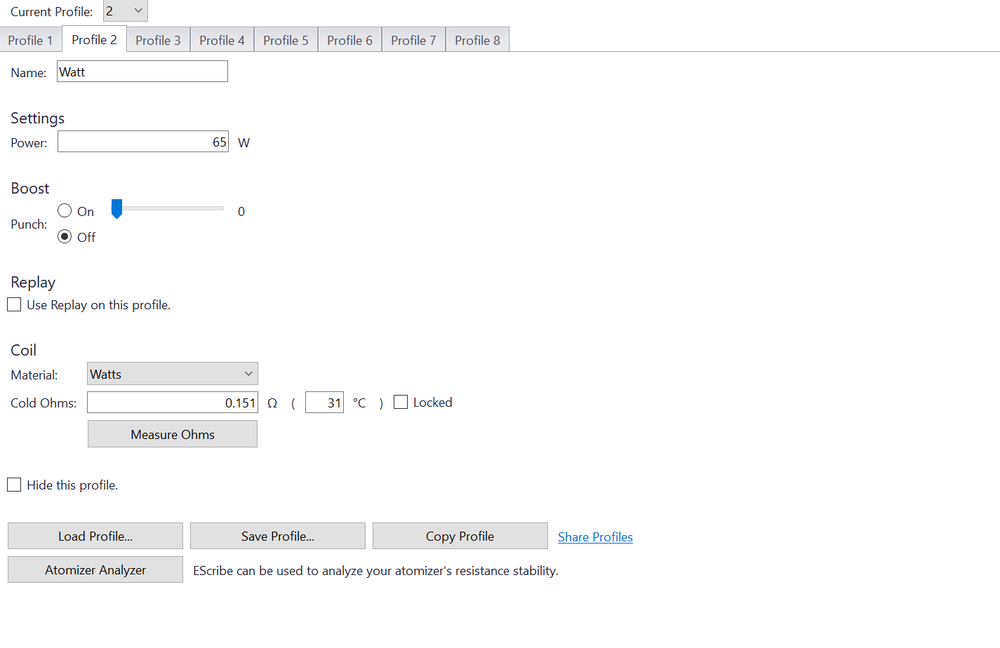

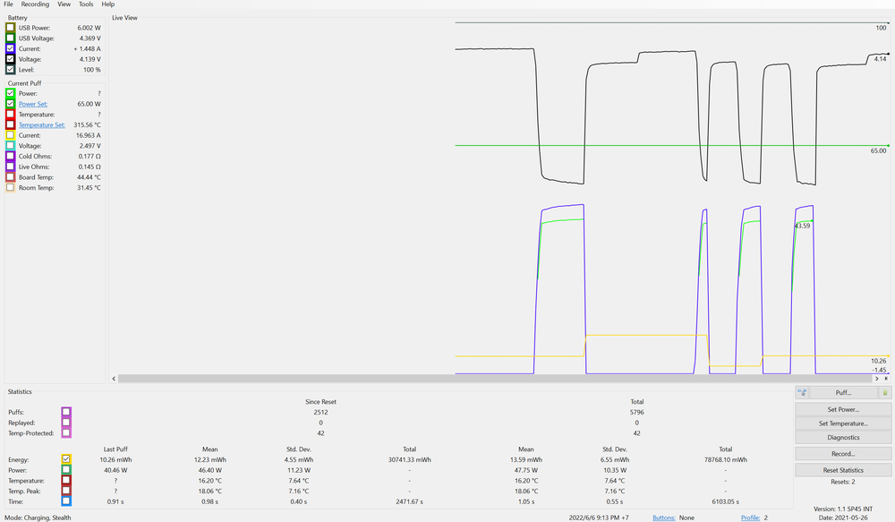

Kisotama Posted June 6, 2022 Report Posted June 6, 2022 (edited) Hi guys, So I've been stuck in this situation for about 2 week and still found no answer Every time I use a 0.15 coil always fire at around 40w ( I set at 65w ) for no reason and I'm using wattage mode, I've search on gg and found that some said because of the tc mode but I don't see any tc in watt mode (lol) how do I fix this ? btw I don't think this problem from the battery because I use cylad 18650 40A on both z100c & sx mini mx class, the sx can fire up to 80w while the geekvape z100c can fire around 40w device : geekvape z100c tank : wotofo profile m rta with adapter Edited June 6, 2022 by Kisotama
BillW50 Posted June 6, 2022 Report Posted June 6, 2022 Either the cell can't supply enough amps (has Mooch tested the Cylad 18650 40A for 40A?) or you have battery connection problems. 1
Kisotama Posted June 7, 2022 Author Report Posted June 7, 2022 I notice that if the board in diagnostics not going to 40 degree or further , the device has no issues with wattage drop , idk what happened to my device but it sound like tc mode despite I'm using wattage mode

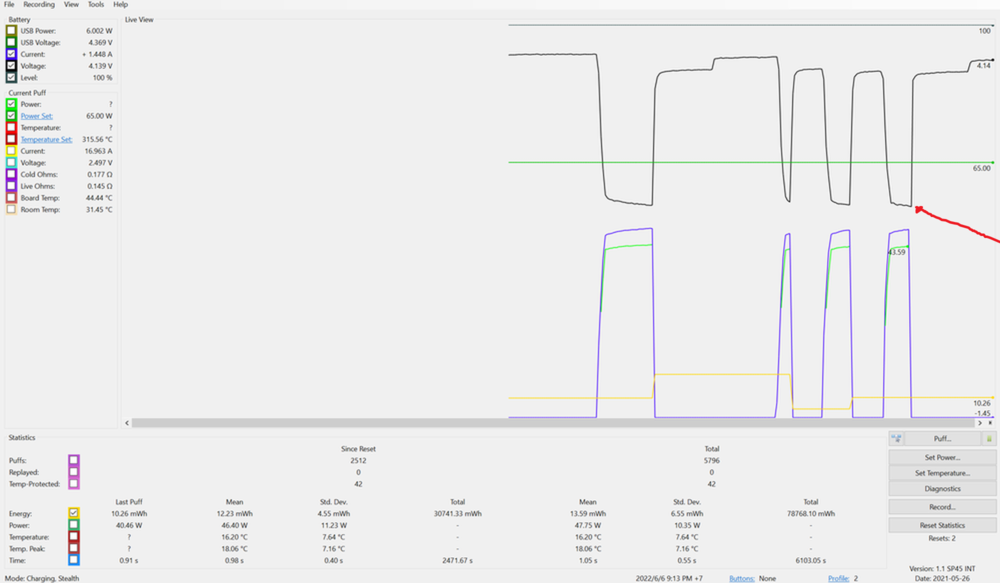

dwcraig1 Posted June 7, 2022 Report Posted June 7, 2022 Hoover your mouse over the area indicated by red arrow. That is the voltage drop on your cell when firing. Report back to us what that voltage is. 1
Kisotama Posted June 7, 2022 Author Report Posted June 7, 2022 3.4v but when the board up to 40 degree the volt drop to 2.4
BillW50 Posted June 7, 2022 Report Posted June 7, 2022 Yup, battery voltage is too low and the mod drops the wattage to compensate.
dwcraig1 Posted June 7, 2022 Report Posted June 7, 2022 So if your able to get 80 watts out of your other mod with that cell then it is most likely a poor connection between the battery and it's contacts. That cell is at best a 20 amp cell but should do more than 40 watts.

dwcraig1 Posted June 7, 2022 Report Posted June 7, 2022 The wire type needs to be something other than kanthal or nichrome and be in a profile for temp wire for temp vaping to be activated. Use the appropriate profile. Example Watts profile with Watts selected for material, no temperature control there. Does your voltage drop change a lot after it get warm? Where does the heat appear to come from?

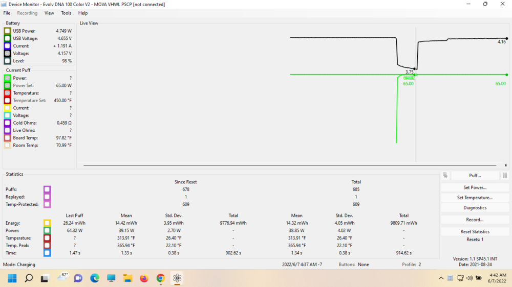

dwcraig1 Posted June 7, 2022 Report Posted June 7, 2022 Your voltage drop should be very close to mine, perhaps a bit less with your 21700. 1
dwcraig1 Posted June 7, 2022 Report Posted June 7, 2022 It is a Samsung 20S 18650, a true 30 amp cell. 2000 mah
dwcraig1 Posted June 7, 2022 Report Posted June 7, 2022 A Samsung 40T is a 30 amp 4000 mah cell, the perfect choice for your mod. The Samsung 30T is another good choice, 35 amps and 3000 mah. 1
