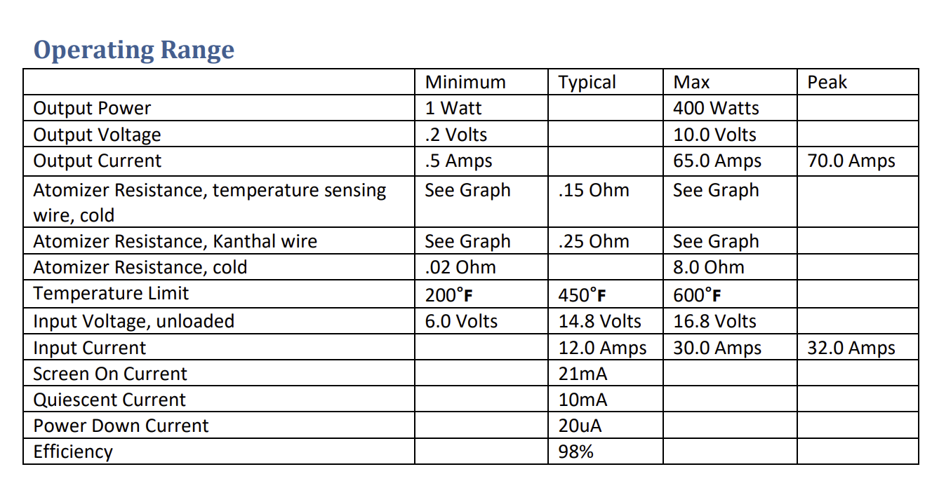

BlackFireDragon Posted June 29, 2022 Author Report Posted June 29, 2022 @dwcraig1 The new values in max peak input current and nax susteined input current for strange reason change the new values back to old from the picture when hit enter or mouse click on window. Any idea how to save changes ?
dwcraig1 Posted June 29, 2022 Report Posted June 29, 2022 While I'm not sure which model board you are trying to change the input settings on the settings are set as high as they can be, you can set them lower if you feel that your cells can not provide that much current if you wish. Personally I see no reason to change these values but they can be set lower than default settings but not higher. Here is the snip of part of the data sheet for the DNA250C, no matter what your actual batteries can provide the board will never draw more than what is listed here. There is no data sheet published for the DNA100C publicly but you can just figure they are 40 max and 35 sustained.
