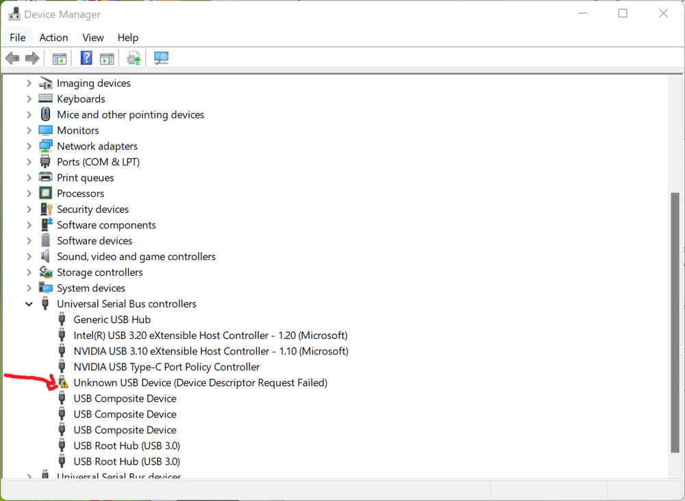

dwcraig1 Posted May 20, 2022 Report Posted May 20, 2022 Look in Windows Device Manager when connected to the non C. If it looks like this Windows sees it but doesn't know what to do with it, no drivers, ect. If it isn't showing up then the device isn't communicating with Windows for what ever reason.

TorturedZen Posted May 20, 2022 Author Report Posted May 20, 2022 I have managed to solve the issue although I still don't know what caused it. After a bit of research (to make sure nothing would be damaged) I opened Win10 Device Manager, located the 'USB Host Controller' and selected the option to remove it. Win10 gives a warning that it will reboot. After rebooting, the Host Controller re-installed itself and Voila! All mods are connecting again. Go figure...LOL Thanks to everyone who replied here. I appreciate it! 3
