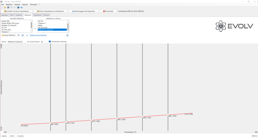

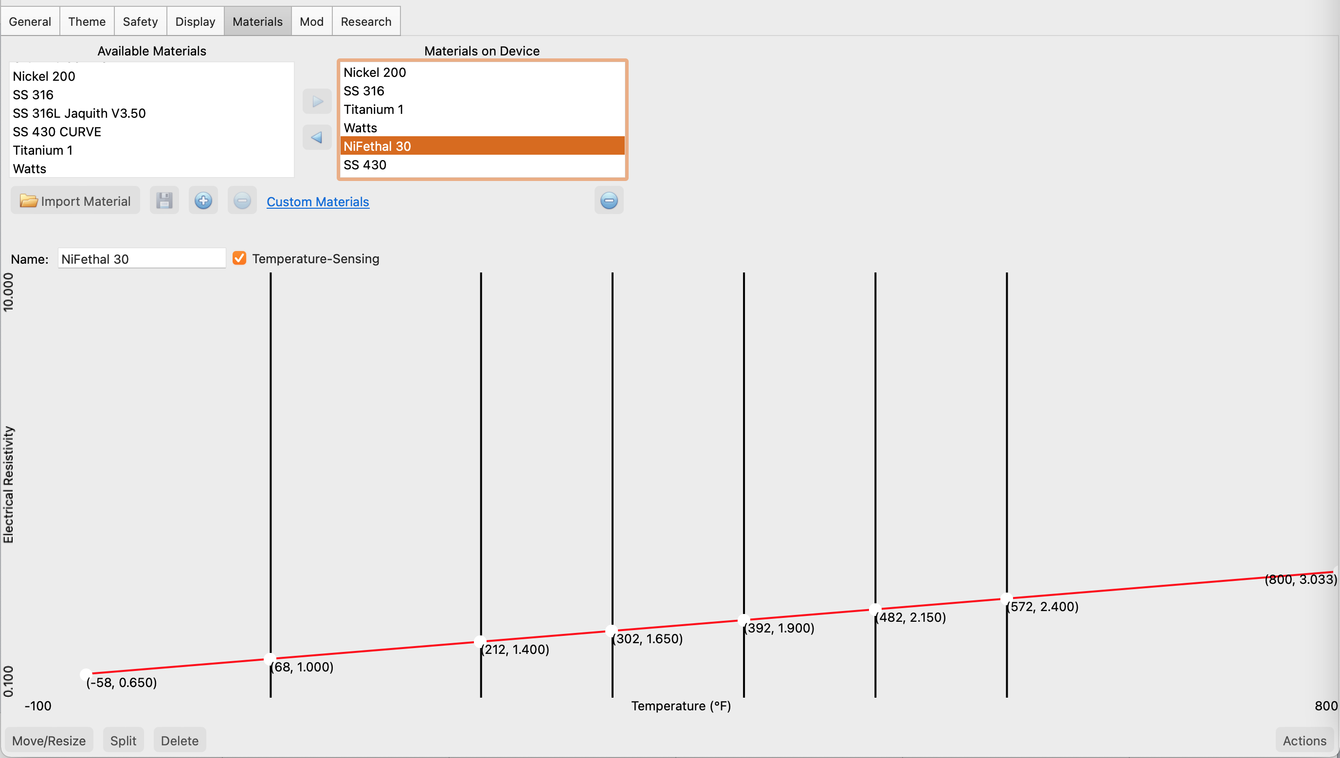

Wayneo Posted May 13, 2022 Report Posted May 13, 2022 NiFe rears its ugly head again. Can you post a link where you bought this wire AND a screenshot of the NiFe Material Profile, like below. 1

Wayneo Posted May 13, 2022 Report Posted May 13, 2022 Thank you. So taken from zivipf; Alloy components: Ni 52%, Fe rest Temperature coefficient: 400 Well you do have the correct material file. so that's good. My 'ugly head' comment refers to Ziv using the '48' to identify the Iron content whereas steam-engine uses '52' to identify the Nickel content. Using escribe with your mod plugged in can you go to your SS316L and NiFe profile and make sure or change so that the temperature box under settings is chosen. (same thing as making sure the 'Off' is NOT highlighted) and let me which material had the 'Off' highlighted. Make sure to Upload settings to mod whenever you make ANY changes in escribe. Another way your mod could have got to 'Off' is on page 4 of the datasheet. Here's a snippet. 'The maximum temperature is adjustable between 200° Fahrenheit and 600° Fahrenheit. To disable the temperature protection entirely, adjust the limit up to 600 degrees, then press the UP button one additional time. The temperature limit will read OFF.' Here's where you can download the complete datasheet 'https://downloads.evolvapor.com/dna60.pdf'Edit: While you're in there (Material for NiFe52 you might want to change the 'On-Screen Name' from 'Ni' to 'NiFe or NiFe48' <- something no other mods can do 3

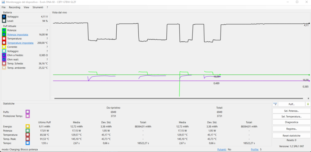

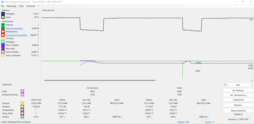

raberone Posted May 16, 2022 Author Report Posted May 16, 2022 Hi @Wayneo! So, I did the test and the Ohm's values show small rises of 0,001 but the value doesn't stabilize. And then I will attach the screenshot of the Device Monitor.

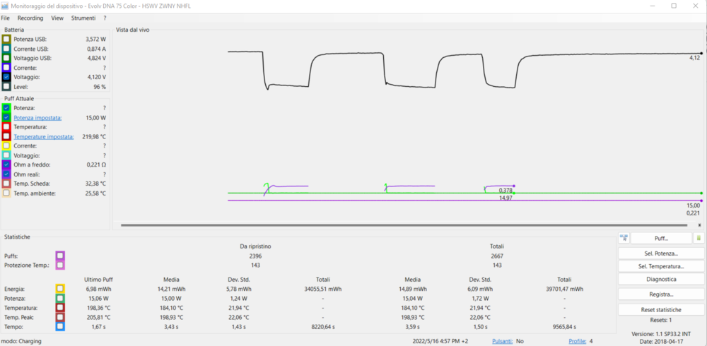

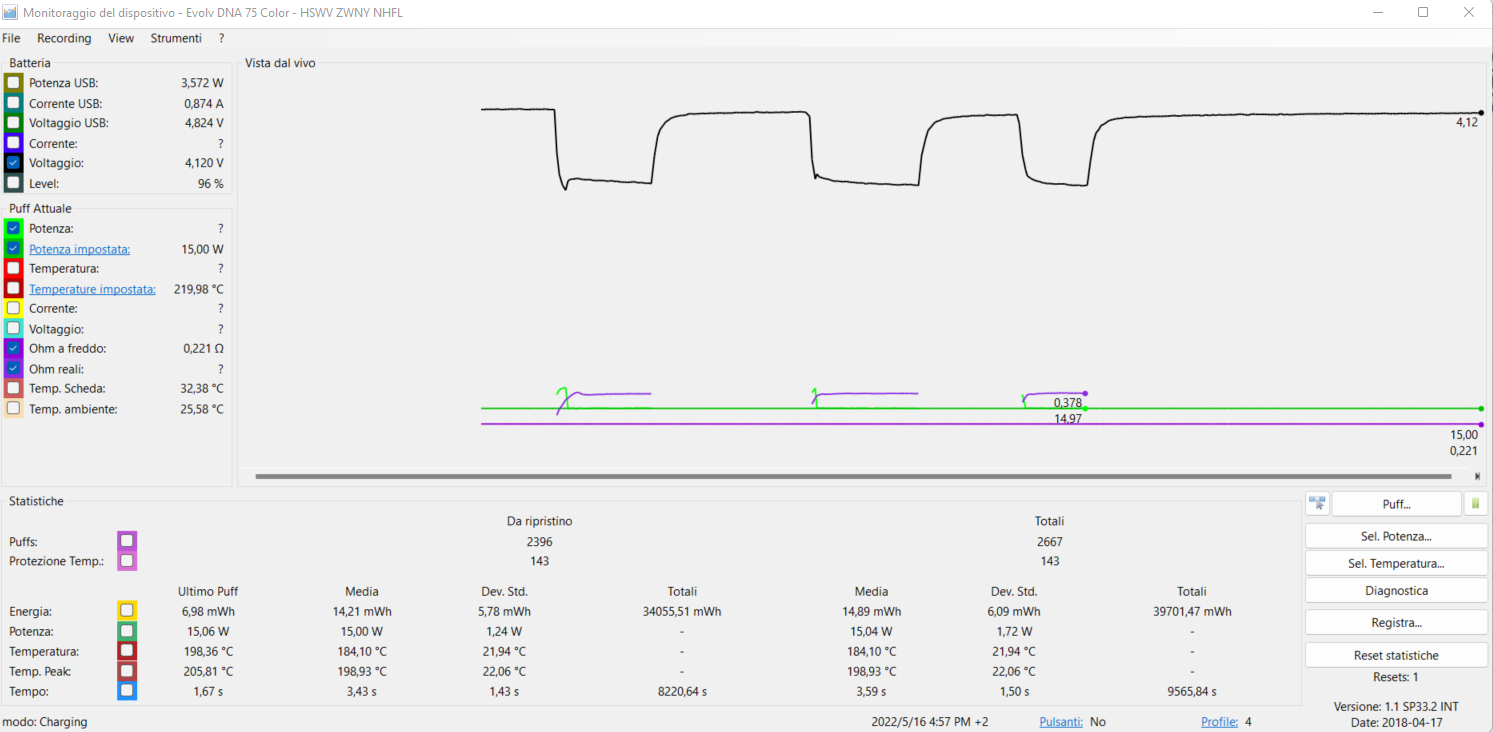

raberone Posted May 16, 2022 Author Report Posted May 16, 2022 This is the same test done with a different box. So, is it the box that doesn't work?

raberone Posted May 16, 2022 Author Report Posted May 16, 2022 1 minuto fa, dwcraig1 ha scritto: Is it the same RBA in the different box? Oh no, sorry! I didn't understand. The first screenshot is from the AIO, the second is from a regular DNA 75c box.
Wayneo Posted May 16, 2022 Report Posted May 16, 2022 For both tests was it the same Rubik rba with the same coil? AND did the Abyss switch to OFF?
raberone Posted May 16, 2022 Author Report Posted May 16, 2022 3 minuti fa, Wayneo ha scritto: For both tests was it the same Rubik rba with the same coil? Yes
Wayneo Posted May 16, 2022 Report Posted May 16, 2022 Wow! Even the Ω's are drastically different. We know your Rubrik works fine in the 75C. I think it has to be down to the connections on the Abyss. That small 0,001Ω fluctuation with Atomizer Analyzer is normal. Do you have another RBA that works in TC on the abyss? @BillW50 dont't you have an Abyss, and does yours work in TC?

BillW50 Posted May 16, 2022 Report Posted May 16, 2022 The wattage is set on only 16 watts. Resulting in temperatures around 130°C (245°F). Why is it set so low?
