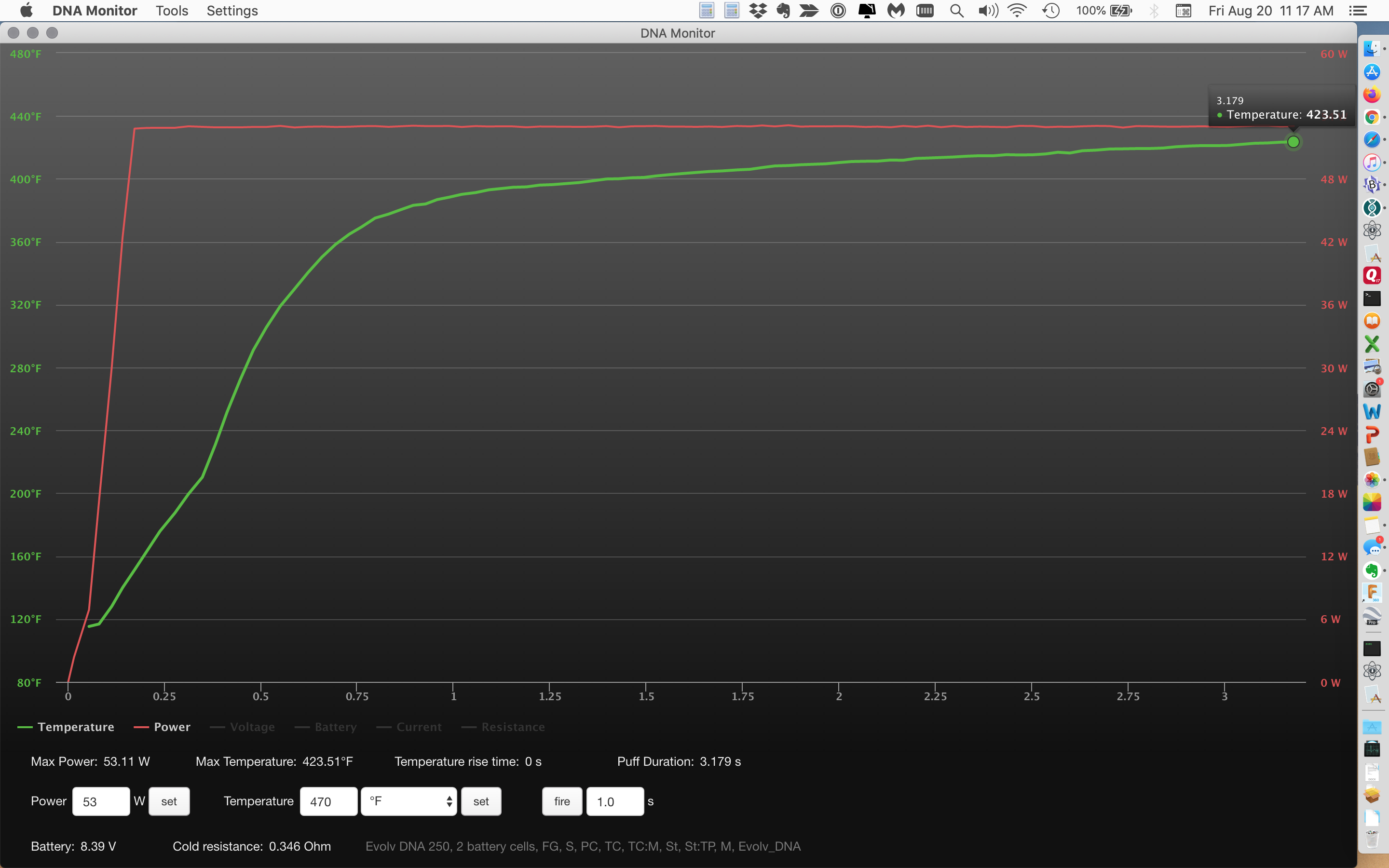

Wayneo Posted August 20, 2021 Report Posted August 20, 2021 Here is an example of what Bill would call Power Dominant. The FDA or nasties, we know occur around 470°F. So if you look, I've set that as the set max temp. I also know I like this coil ~53 watts. And look at the temp it eventually reaches (funnily enough) in my Temperature Dominant mode. There's more than 1 way to kill a bird. 2 1

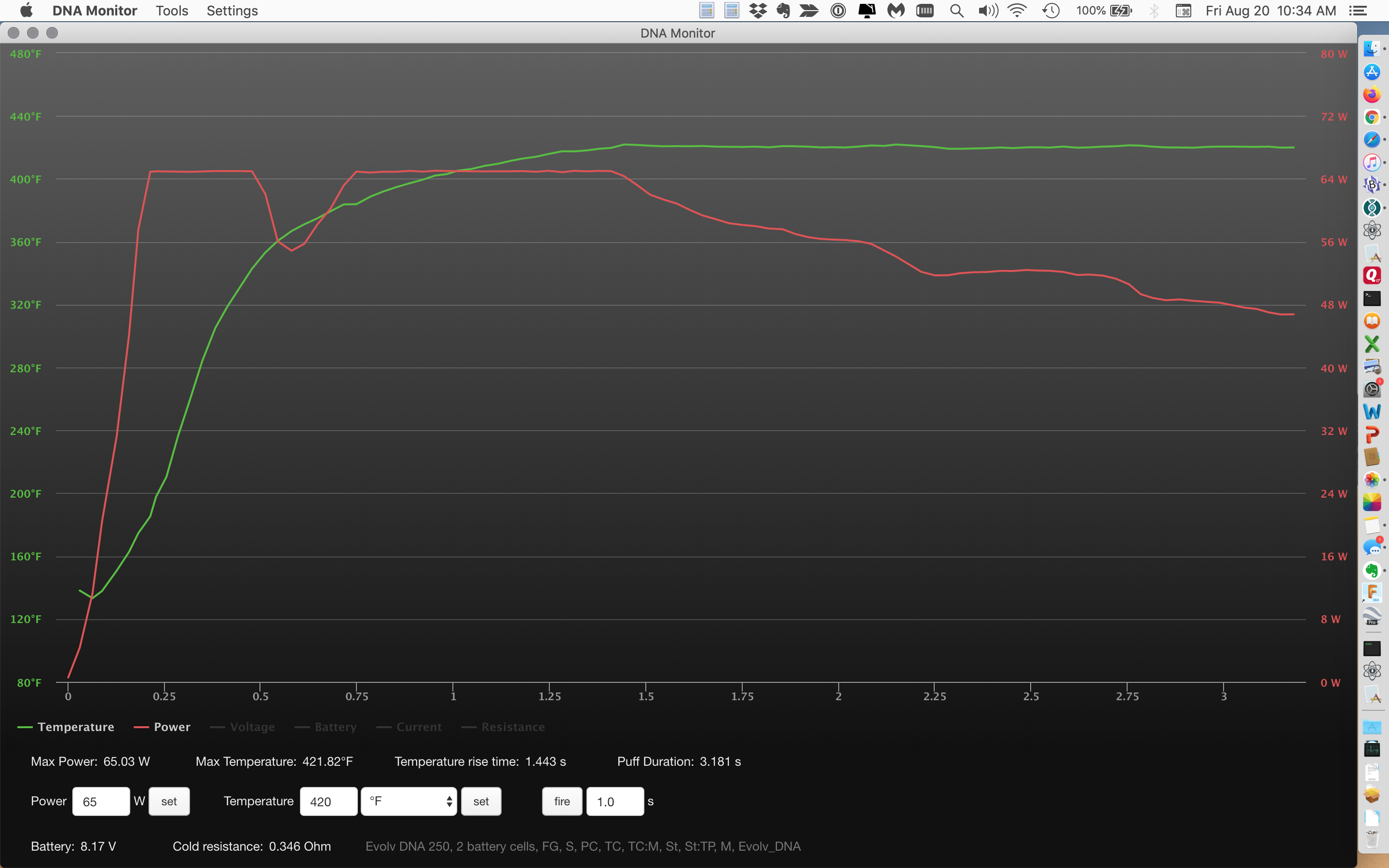

CMK Posted August 20, 2021 Report Posted August 20, 2021 (edited) vor 4 Stunden schrieb Wayneo: While @gwyar is correct, to me Device Monitor is even easier Edit: Just noticed my max temperature was 1.82 degrees above the set temperature. Let's see yours Even if the wattage is almost optimally adjusted to the target temperature, the maximum temperature will always be slightly above the target temperature, since the power supply is only reduced when the target temperature is reached and the coil continues to heat briefly due to its inertia. The average temperature will ALWAYS be below the target temperature, as the heat-up phase is also taken into account in the evaluation. In order to be able to optimally coordinate the power and preheat to the coil, in my current landscape themes in TC mode I always show the power actually used next to the target temperature, as well as the maximum and average temperature, directly on the main screen. I show the temperature of the preheat here, but when this is selected the display changes to the punch assigned to the temperature and the setting is also made as a punch (1 to 11). In this way, the internal dependency (Preheat-Temp <=> Preheat Punch) can also be clearly seen, as well as the influence of the target temperature on the presetting that I described above. Edited August 20, 2021 by gwyar 1

Wayneo Posted August 20, 2021 Report Posted August 20, 2021 14 minutes ago, gwyar said: Even with a setting preheat punch = 11 (max), the temperature assigned by the chipset is below the final target temperature, for example target temperature 450 ° F + preheat punch 11 = preheat temperature 440 ° F. That is a true statement Like I mentioned above, the set temp should be thought of as the max temp, or temp limit. I'd have to look around if I ever saw a perfect match. Mine, at a 1.82°F over even surprised me. When i normally look it's more like 5°F over. 1
